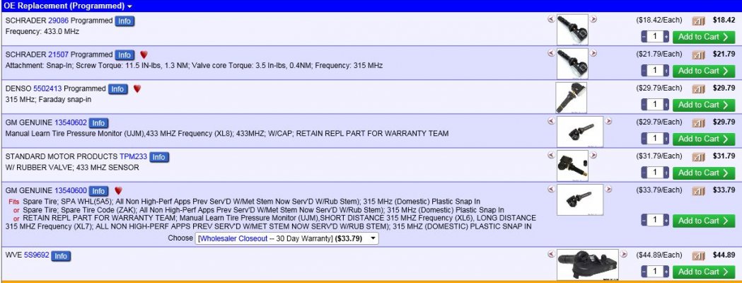

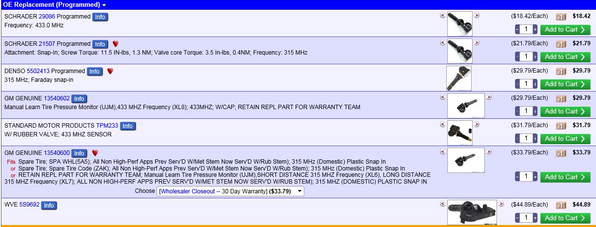

I have never heard of OEM sensors requiring a tool, "unless" you have a specific year like my 2012 that does require a tool, the 2007 does not but the tool is very handy in any case.
the only thing that you "need" to know is the MHZ
check your glove box for the correct rpo code for your vehicle
xl7 is 315mhz
xl8 is 433mhz
then you can go to a sight like rockauto that normally correctly list's the oem part numbers and the MHZ for your year
they made changes on the newer trucks and even though the MHZ are the same they will not work, I'm talking late model in the last few years.

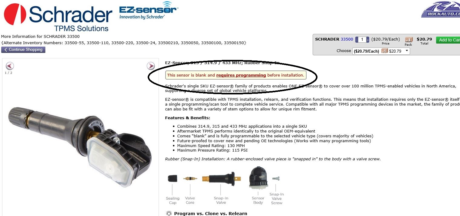

***poking around I see some "non-oem" mentioned as "no programming required before installation" follow OE relearn procedure. so that could be what is leading to some confusion?
i.e.
More Information for VDO / CONTINENTAL SE10006
Don't confuse TPMS Sensor Relearning, Programming and Cloning! Some processes require a Tire Pressure Monitoring System (TPMS) Programming Tool to complete, but not all processes are required (or available) for every application.
just buy oem or one's that say they are "programmed" and you should never have a issue
*note the photo below and the MHZ for each and refer to your rpo list in the glove box that mentioned above
xl7 is 315mhz
xl8 is 433mhz
i.e.

I was told by my buddy at Napa that many offshore models can't be programmed using onboard computer. OEM can be though. And thank you for all your info. It's a great learning process. I looked at the label in glove box and neither of those RPO codes are there that I can see. So im not sure of frequency.....yet
. As you can see in this Pic. I'll figure it out soon er or later. Lol. Thank you again.

315 Megahertz is the freq US trucks are dictated to use. In Europe it’s 433. In Gen 4 everything started changing again.
I did pull down a copy of the 12 owners manual and it does indeed say to use the trigger tool for the relearn procedure. I recommend the tool also, because it is safer and faster.
However, all the trigger tool does is to trigger the sensor to send the pressure status which can also be triggered by a tire pressure change. So, I'm curious if this is really more of legal issue, like don't tell people to depressure their tires, of it is really a limitation of the learn mechanism. I will have to give it a try at some point soon.
