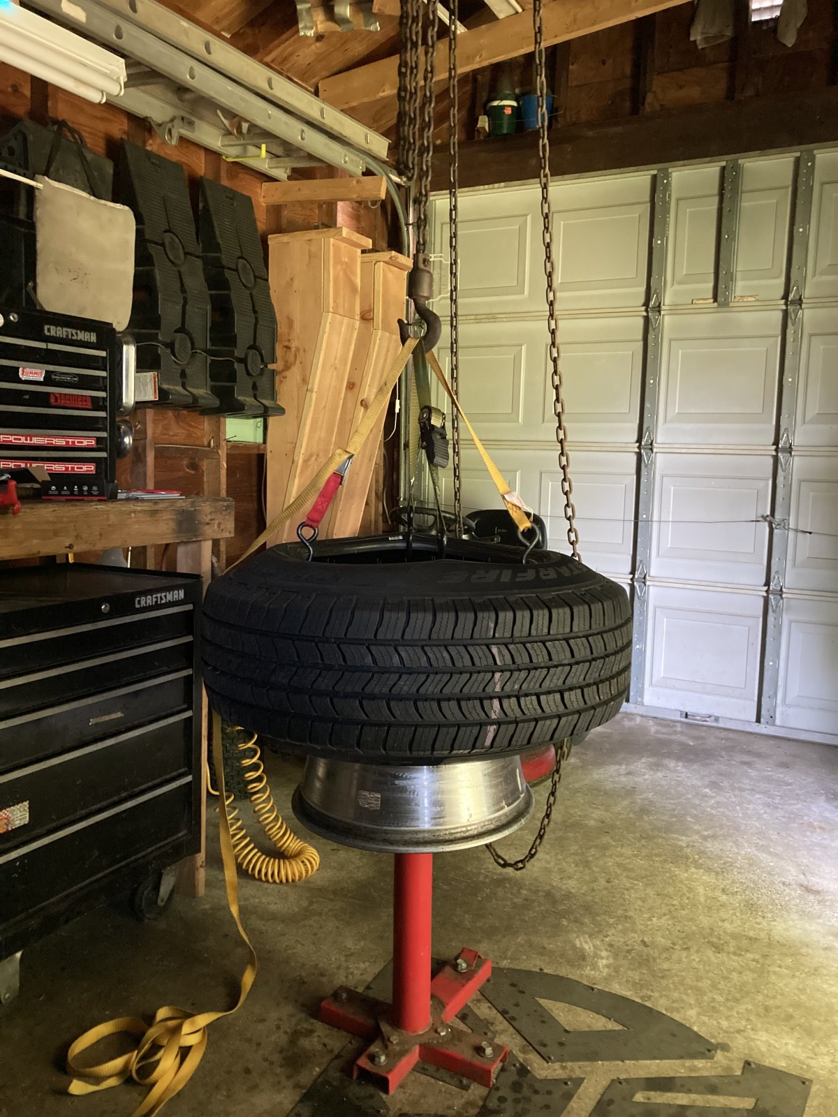

There are a couple of work-arounds if you have trouble reseating the bead.
One is to take a ratchet strap around the circumference of the tire and tighten it so that the tire sidewall pooches (a technical term) out to meet the rim.
Another is to use a bicycle inner tube, lightly inflated, to plug the gap. It should be lubricated with talcum powder or soapy water.
I'm sure others like @89Suburban will have suggestions.
You only have to break the outer bead to install the sensors. If you are having a hard time getting the OUTER to reseat you can put 2x4's sore some other type of blocking under the "beaded" back sidewall of the tire on the floor and push down on the rim to get it to seal.
Sometimes when I install new tires they come compressed from being stacked or banded together during transport and can be a bear to get seated. I used this stretching method for 24-48 hours to get the tire relaxed to the point it will seat itself.
