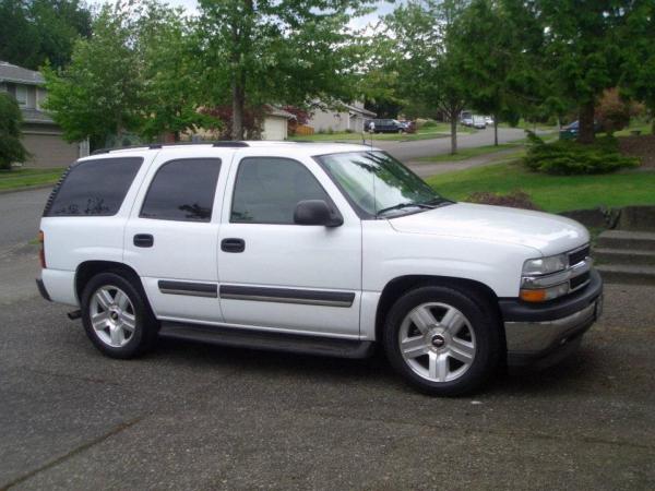

This weekend, I swapped wheels with a coworker, and now have his 2008 Silverado LTZ wheels on my wife's 2005 Tahoe:
Surprise, surprise, the tire pressure readouts aren't working and I get the Service Tire Monitor System message. I tried going through the steps outlined in the manual, and I couldn't get it to relearn the sensors.
Then I came here to search for answers, but got nothing but conflicting results. I found several posts, but some say it will work others say no, you have to get new sensors.
So, can anyone confirm that sensors from a 2008 Silverado will or will not work on a 2005 Tahoe? If they will work, does it require some sort of reprogramming of the sensor at a dealership/tire store?
Also, same question for the opposite, 2005 Tahoe sensors on a 2008 Silverado since my coworker needs to get his to relearn the TPMS sensors as well.
