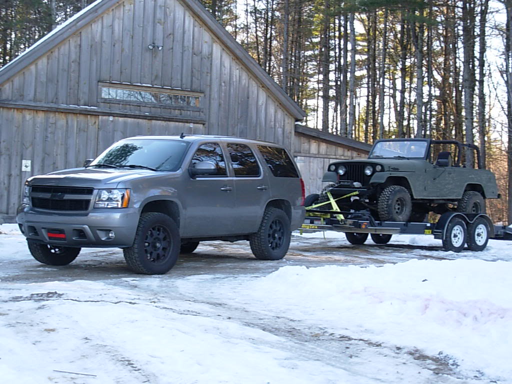

You should not have any issues, just might want to air up your tires to handle the extra weight, if you do not want to use airbags look into getting a weight distrubuting hitch transfers the weight back to the trailer. Even without bags or a wd hitch properly set-up your tahoe shouldn't squat much more than an inch or so.

intruck design... mine squats alot more than your i think il have to take soem pics the next time i load my rig up. aint done it in a while.. but i think it sits lower than an inch...

I am surprised that your trailer doesn't have any brakes...atleast on one axle...mine is a 18ft. and I have brakes on both axles, I could not imagine towing it without them.
