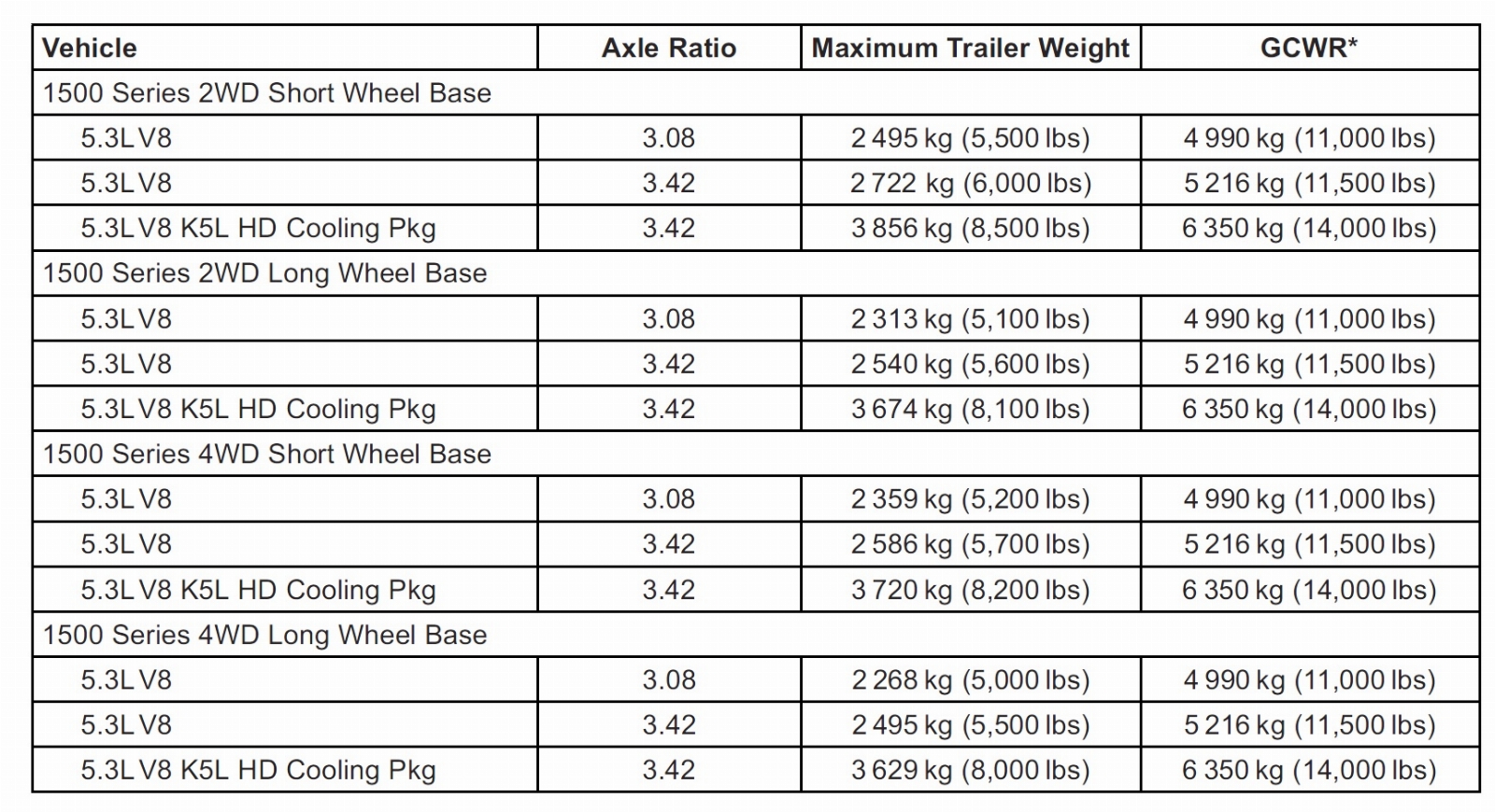

I believe the codes you're looking for are
K5L - heavy duty cooling package
And you also need to know your axle ratio -
GU4 3.08
GU6 3.42
Then confirm trailer weight ratings in your owners manual
avalonandl
Apr 6, 2019
2,200
2,645
Troy, MICH & Naples, FL
Tahoe/Yukon 2WD 5.3L V-8 5,500 (b) Tahoe/Yukon 2WD 5.3L V-8 6,000 (g) Tahoe/Yukon 2WD 5.3L V-8 8,500 (g,p,) Tahoe/Yukon Two-Mode Hybrid, 2WD 6.0L V-8 6,200 Tahoe/Yukon 4WD 5.3L V-8 5,200 (b) Tahoe/Yukon 4WD 5.3L V-8 5,700 (g) Tahoe/Yukon 4WD 5.3L V-8 8,200 (g,p)
The 3.42 moves it to 8200 lbs. Its 5700 lbs w/ 3.08

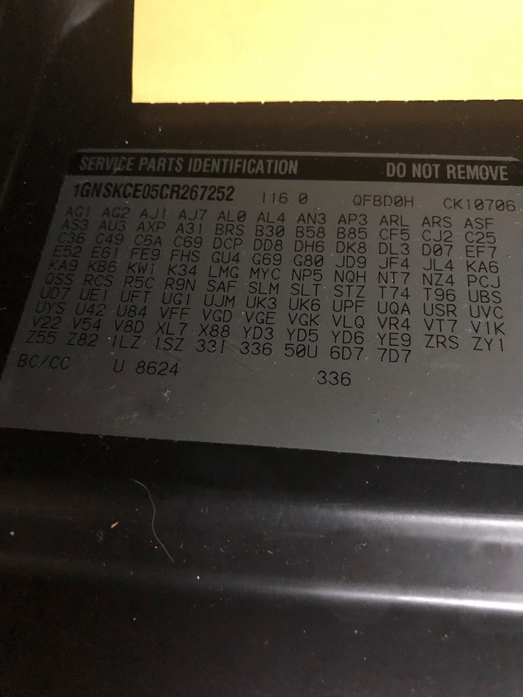

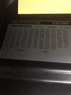

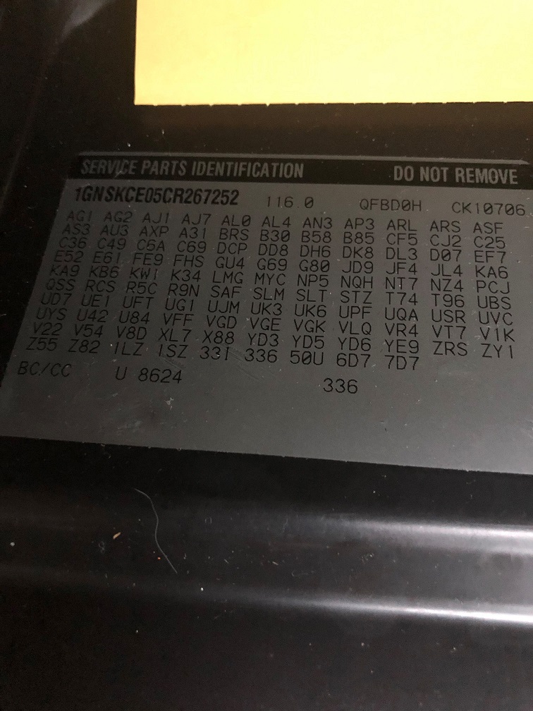

Here's my glove box tag.
Interesting that you have the 2-speed transfer case with 3.08 gears. Your truck has built in Trailer Sway Control and Hill Start Assist. Download the manual, buy one off Ebay and read it cover to cover.
You can spend some money and add those missing features to increase its capacities. Got pics of both trucks?

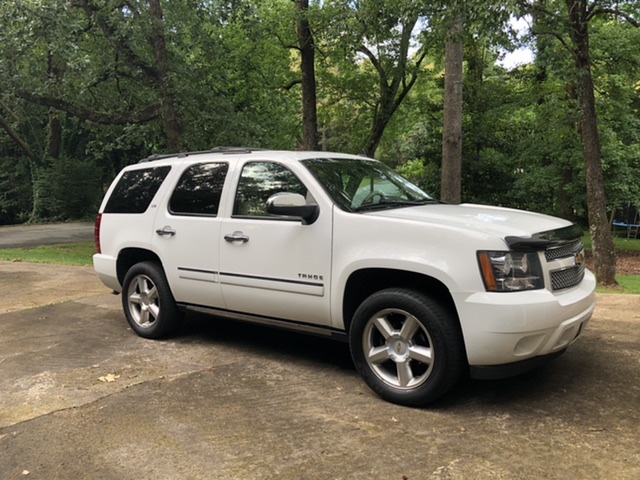

Here’s the Tahoe:

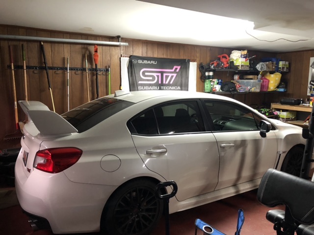

Here’s the STi:
Both are currently very dirty....
