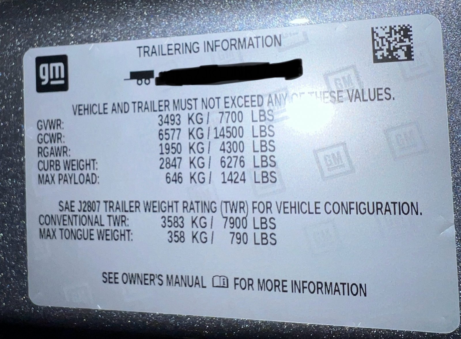

Here’s the trailering label from my 22 Yukon XL Denali with Max Tow, Premium Capability Package w/ Active Response 4wd, Air Ride
