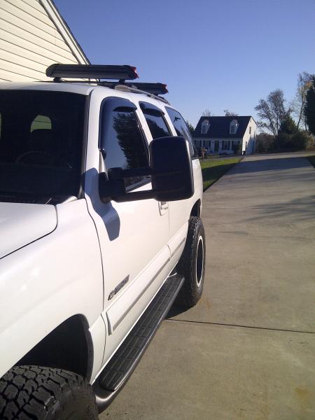

i have an 2003 yukon xl and i installed: (no puddle light, but i don't believe that was ever an option on towing mirrors)
http://www.amazon.com/Fit-System-62075-76G-Chevrolet-Replacement/dp/B005H12QXG/
picture:
http://www.tahoeyukonforum.com/forum/showpost.php?p=568631&postcount=9
