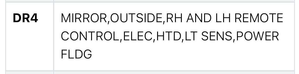

my 2003 Tahoe has the DR4 code on the RPO sticker inside the glove box.
DR4MIRROR,OUTSIDE,RH AND LH REMOTE CONTROL,ELEC,HTD,LT SENS,POWER FLDG HTD R/CON O/S MIR(DR4)

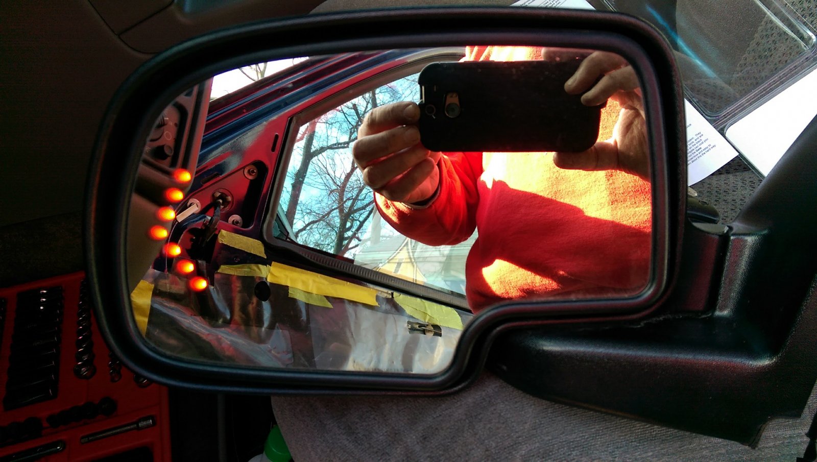

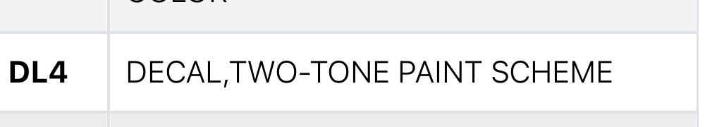

Isn't the power folding option DL4? Either way, yes they can be added to a vehicle that never had them--,puddle lights too. Just go to a junkyard and get to one that's already equipped. Grab both mirrors, the master switch and ALSO the passenger front power window switch. I added them to my 03 that wasn't originally equipped and they work flawlessly. Bonus--mirrors also came with turn signals, which also work. It's on my build page somewhere.
Puddle lights also work, and they come out only at night when I hit the key fob.

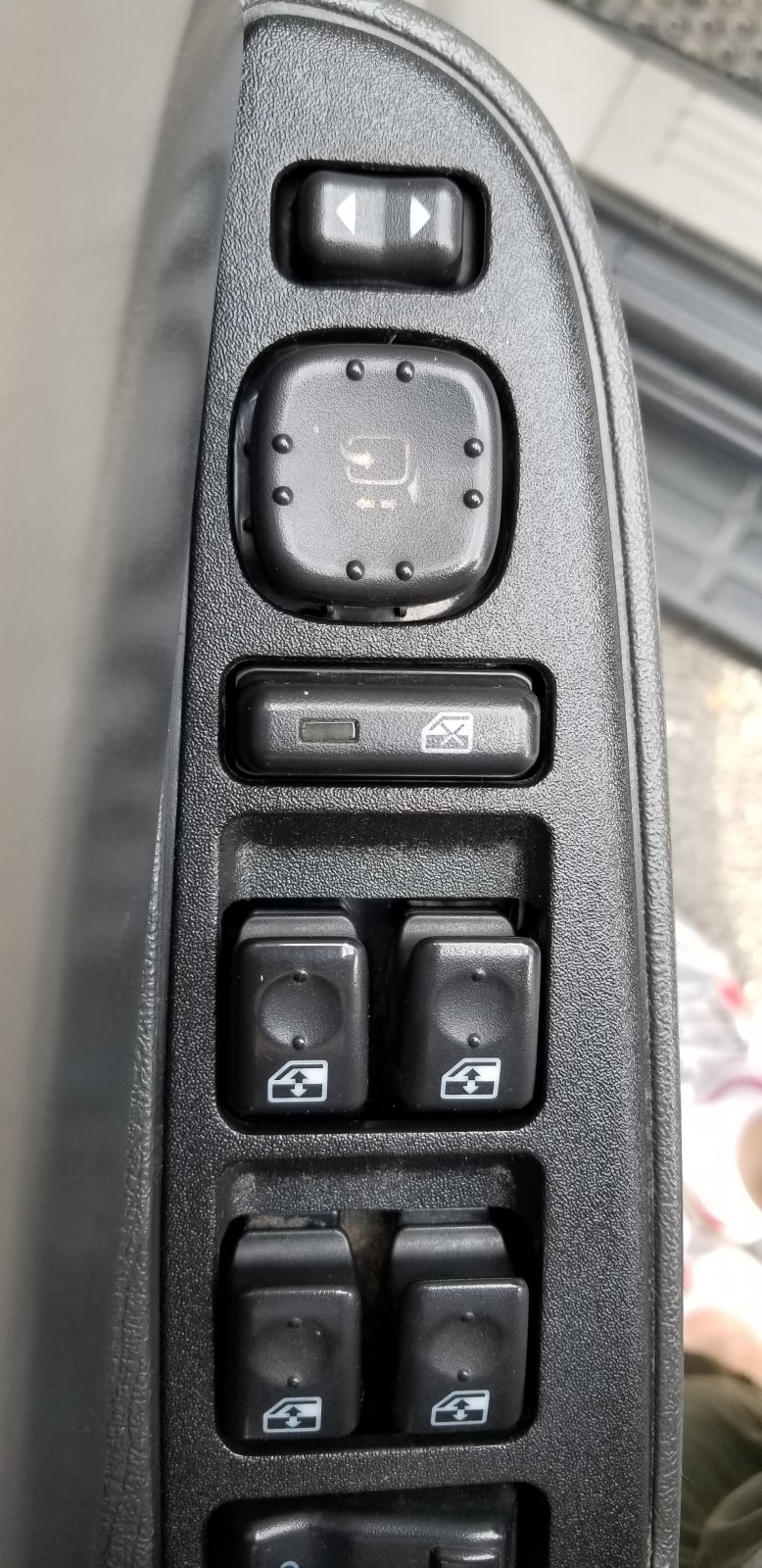

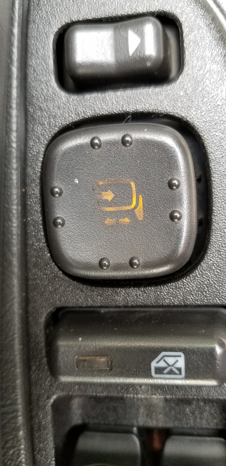

Does your master switch have this icon in the mirror control button?20180608_165744.jpg
The correct master switch.

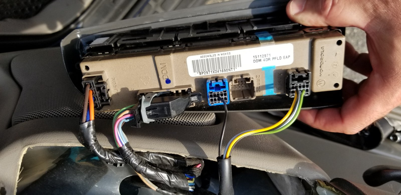

View attachment 436460View attachment 436461View attachment 436462
Does your master switch have this icon in the mirror control button?View attachment 436463
Yes, that‘s how my switch looks like with the icon. I ordered mirrors with the power fold and everything on Rockauto, they were cleared by customs yesterday and will arrive tomorrow. I‘ll give an update once I installed them.
