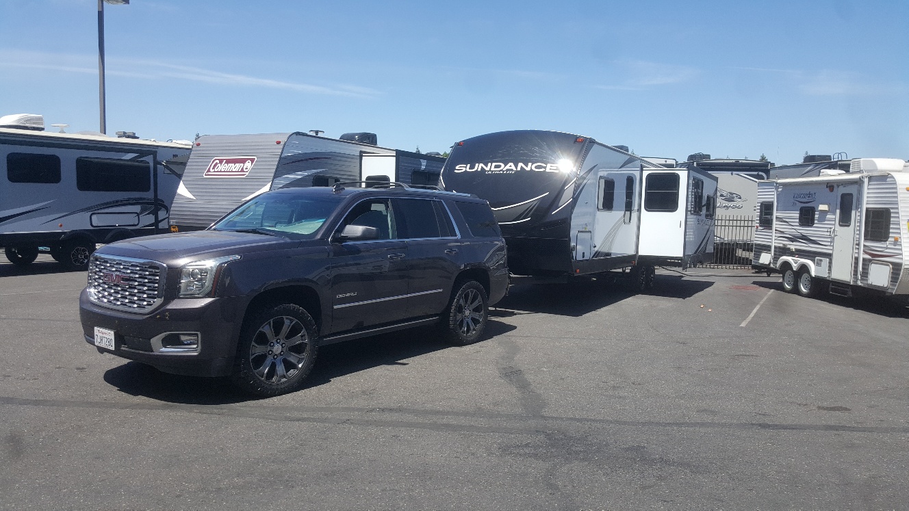

Finally bought the travel trailer. It measures 31.5 ft and dry weight at 5743lbs. Came with an Eas-lift WDH and sway cntrl. The drive home was about 2.5 hour and had some gusty winds. The SUV handle it fine @55 mph. Initially there was some sway but pulled over and adjusted the sway tension and it was way better. This is my first trailer so I was very nervous driving it home . I got use to it and the last hour of the drive was smooth. Backing it up was an experience but lucky I had good people to help me out.
Unfortunately I took my Yukon to the dealer a few weeks ago for oil consumption (burned 2 qrt of oil in 5k miles) and may need a new engine now. They are tracking my oil consumption now. If it burns oil they will write it up for a new motor. I'm also dealing with GMC directly. I may get that 2500 Denali diesel after all!
