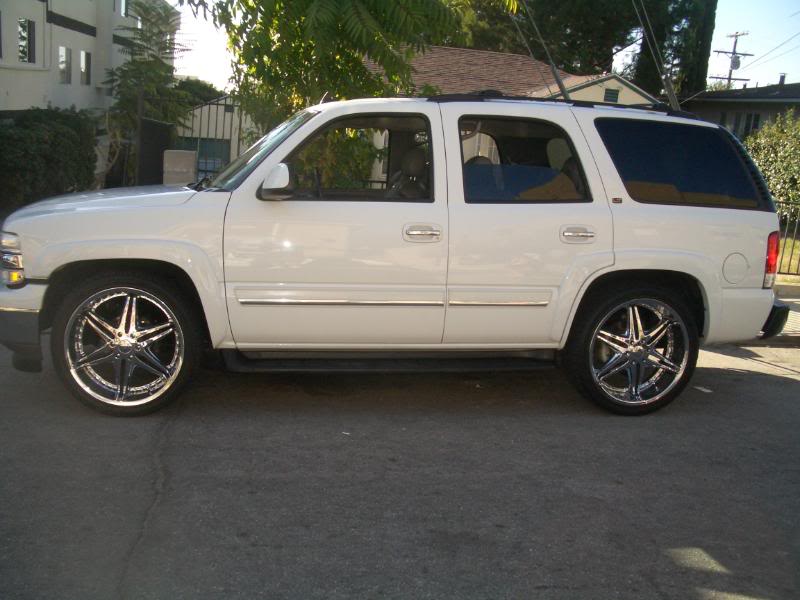

Travieso
Boooooooost !
Jul 19, 2009
2,277
64
Los Skandeles, CA
umm ok anybody else wanna chime in here? and how much of a drop can u get?
I was just as curious as you and i just finally said **** it and do it.. So to answer your question you said whats the lowest you can go with a stock keys well here it is hope this helps
also another picture on my sig
