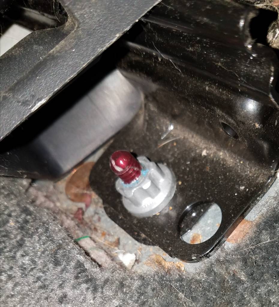

What socket is needed for seat bolts? It's like a star.

some have a torx built into a hex head bolt. so take another look and see if its a actual bolt. ive busted torx bits off taking seat track bolts off, they are loc tighted on there real good.
This is the nut

Of note: Loctite breaks down around 500 degrees. Put a wet cloth on the carpet and clear plastic bits from around the area. Hit it with a pencil torch for a minute or two, keep the heat localized and it should come out rather easily
