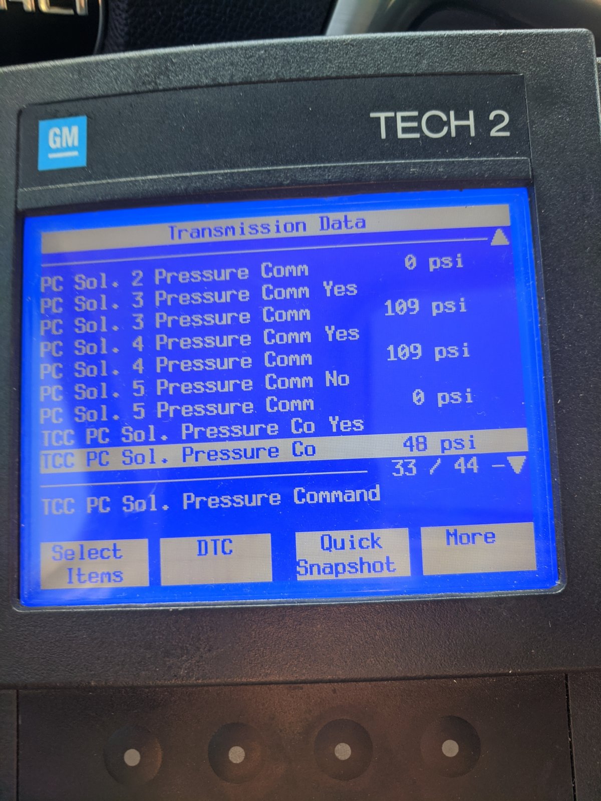

So what's the Tech-2 say? My pressure is 109 psi all the time. I think you can graph the converter lock up and record it for playback.
what pressure am I supposed to monitor exactly? i see the solenoids ramping up to 109 as it changes gears
That's good, that's the pressure on mine and Tom's. I would also watch the converter clutch and see if you see it locking and unlocking during those vibrations. I'll take mine with me tonight when I take my daughter to volley ball practice and have a look to refresh my memory.

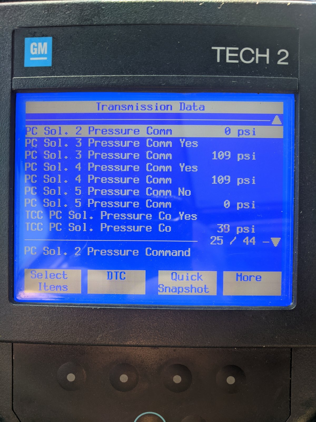

Which one is the converter clutch and what does it show? This a picture of what mine shows cruising about 75mph, I didn't notice it doing anything today

Which one is the converter clutch and what does it show? This a picture of what mine shows cruising about 75mph, I didn't notice it doing anything todayView attachment 261590 View attachment 261591
TCC pressure does vary and that appears normal. I think there's another setting somewhere showing the clutch engagement. I'll be heading out in about two hours and will have a look.
