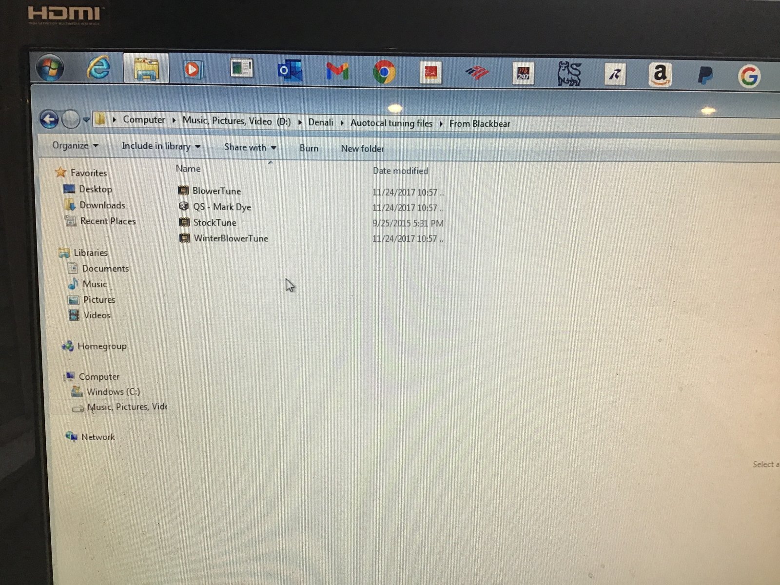

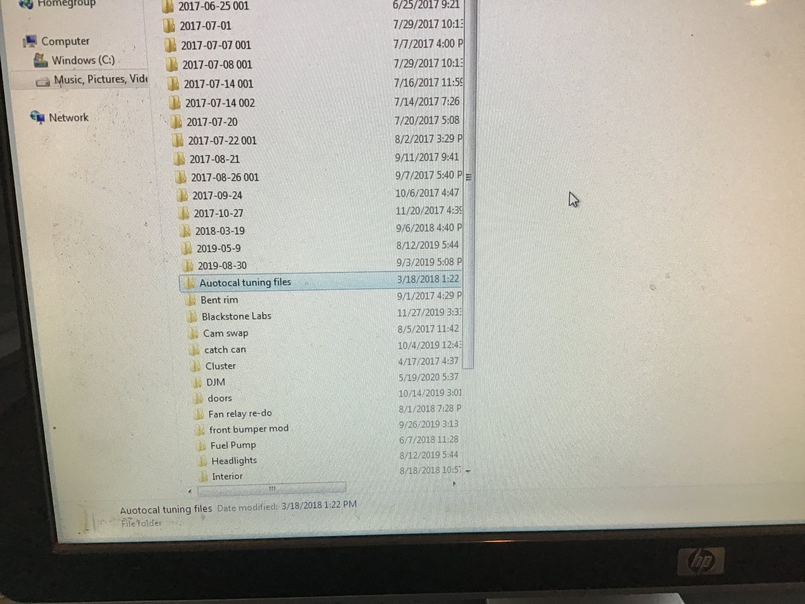

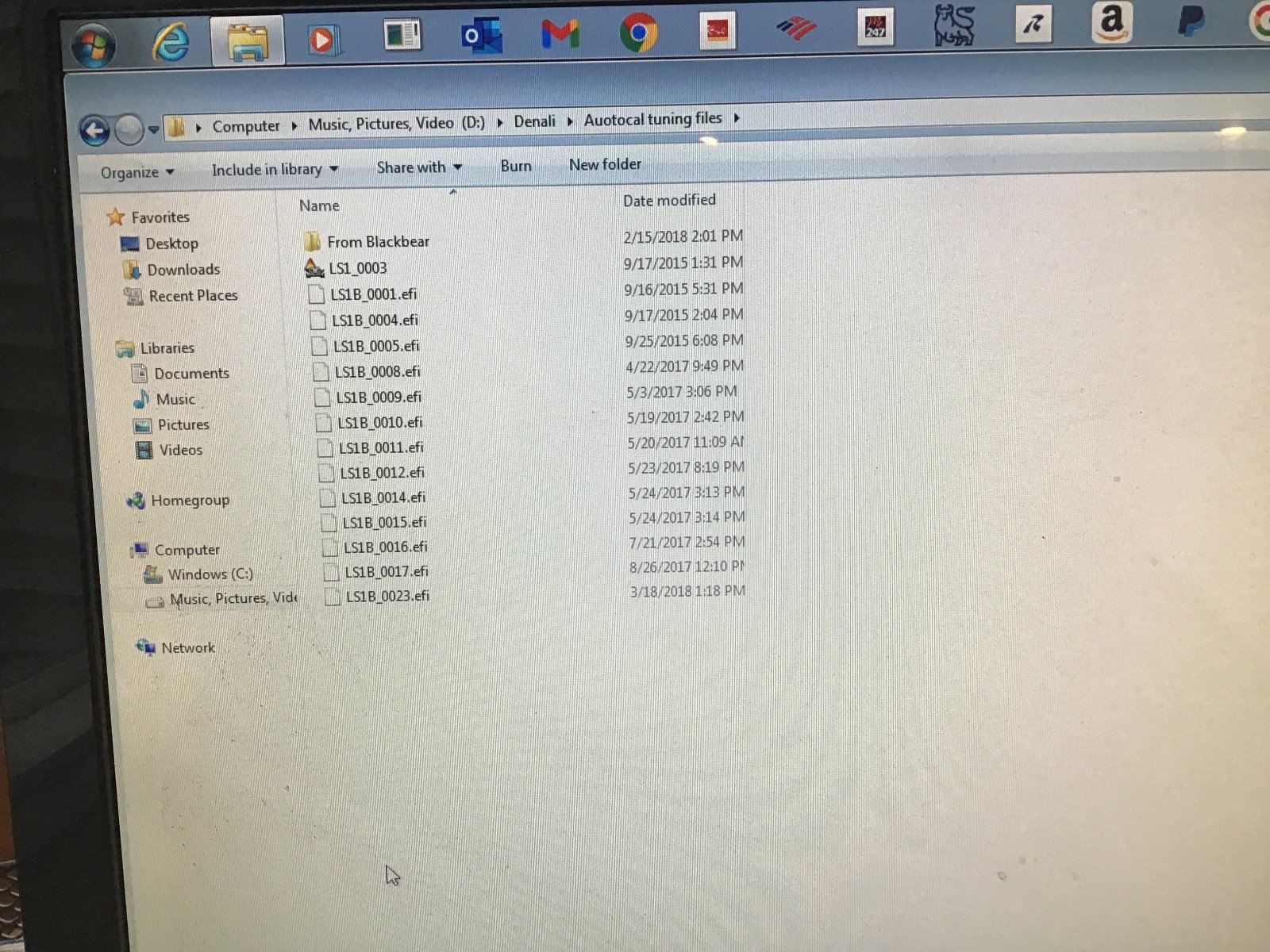

id you save the file after data logging? Look at the instructions for copying files to and from your Autocal. You need to create a folder on the pc where you can store the data log and tune files. I have a folder I created for the Denali and in that folder I created a folder titled Autocal tuning files, then in that I keep the datalog files. Then I also created a folder I named “from Blackbear” and in that folder are my tunes that they sent me. You’ll need to be able to find these files and transfer them to and from the Autocal. Here’s some pics of the folders on my pc.
