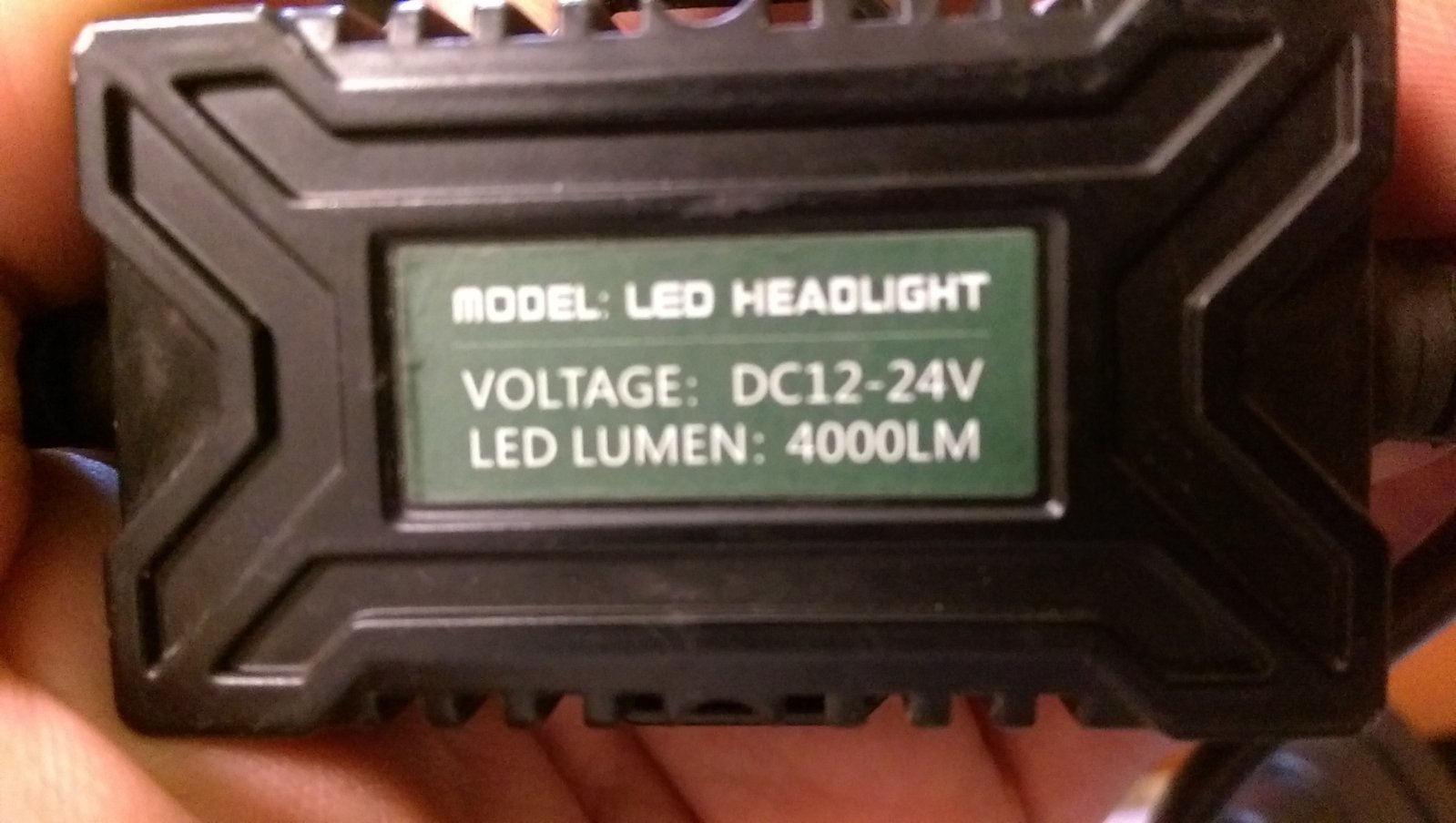

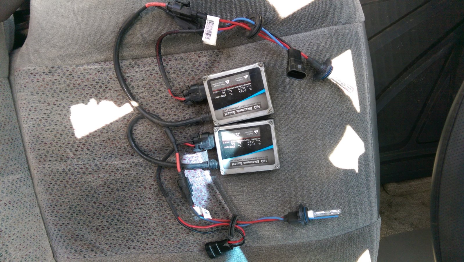

Just checked the blown led. Either the bulb or ballast could've went bad--it was the bulb. New, these leds said 8000 lumes, that's combined, not per. I think @Bigbeardenali1992 had mentioned that before.
So I yanked them and went with the trusty his setup. I don't like them, but they're better then the stock halogens.

Did Vouke not replace anything for you?
Not yet. I received 2 separate emails from them as I emailed them 2 different times. One said to see which was bliwn-bulb or ballast, them cut the wire to whatever was bad and show the QC number. Other one said they were sorry and asked which model # I bought along with my order number, which I supplied. We'll see what happens next.

Roger that. Just interested as I have those VK-5s too, but likely have way less hours of actual use on them than you.
