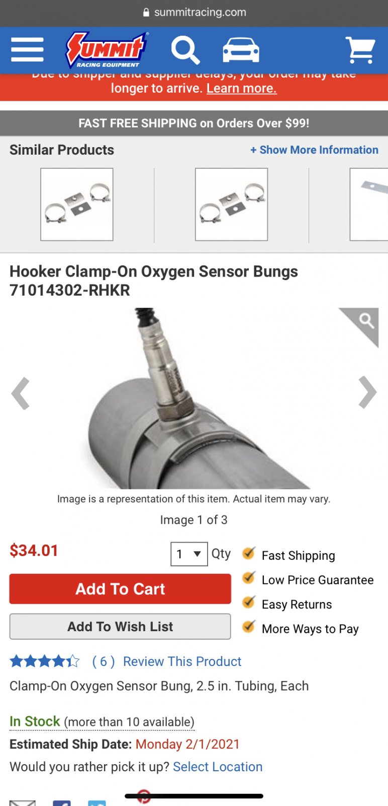

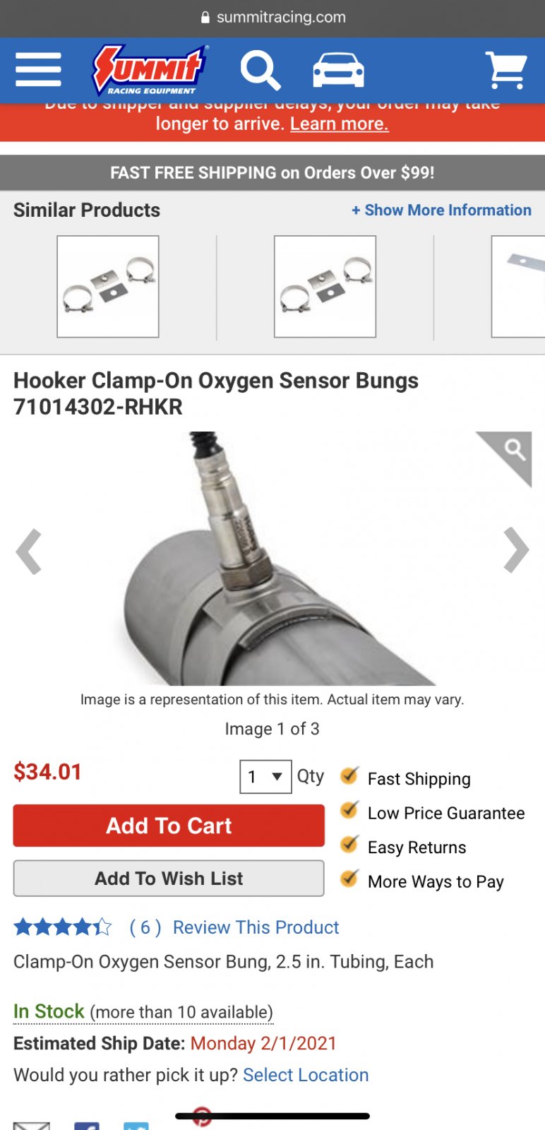

Came across this possible solution from Summit. I see similar options on Amazon. Not recommending, just sharing.
https://www.summitracing.com/parts/...eXuwdIMCXOl1K3co9XeKAYJGAtdjKwgxoCmYwQAvD_BwE
