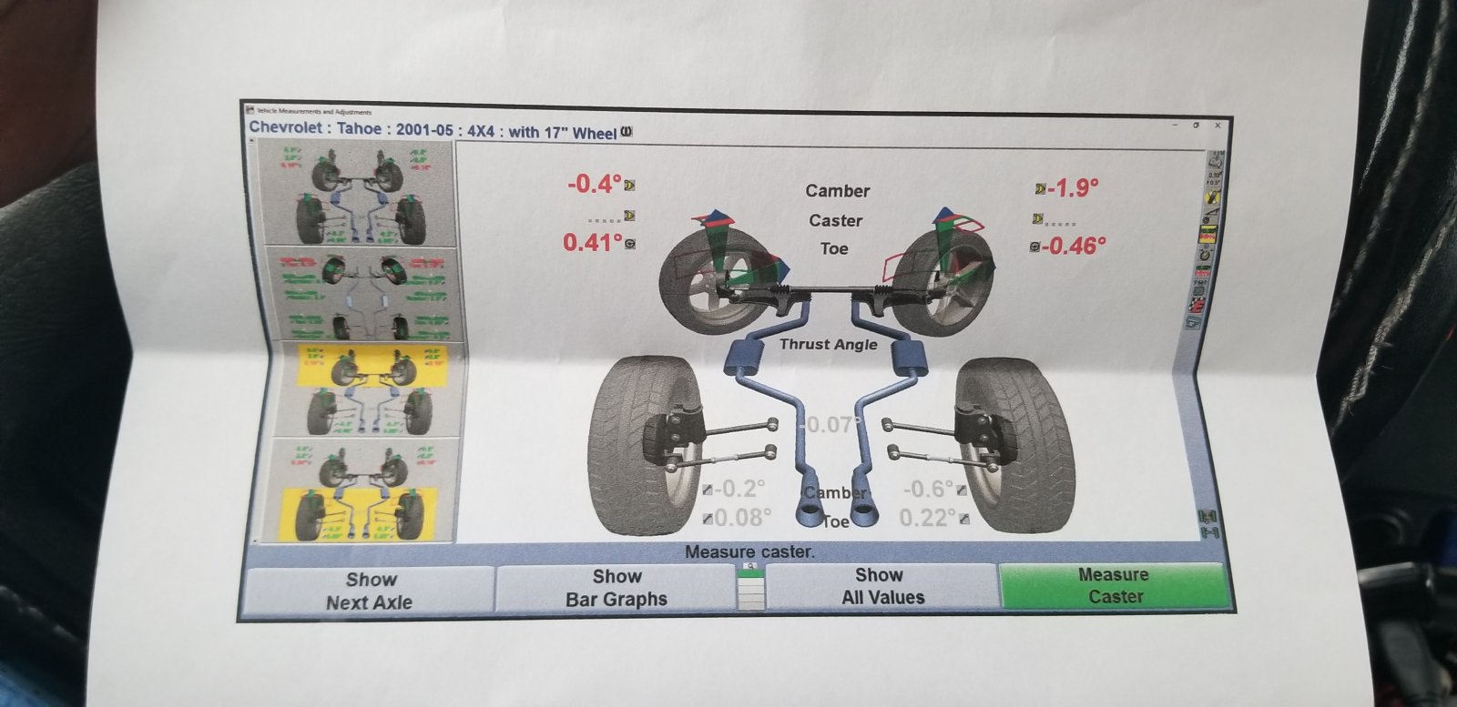

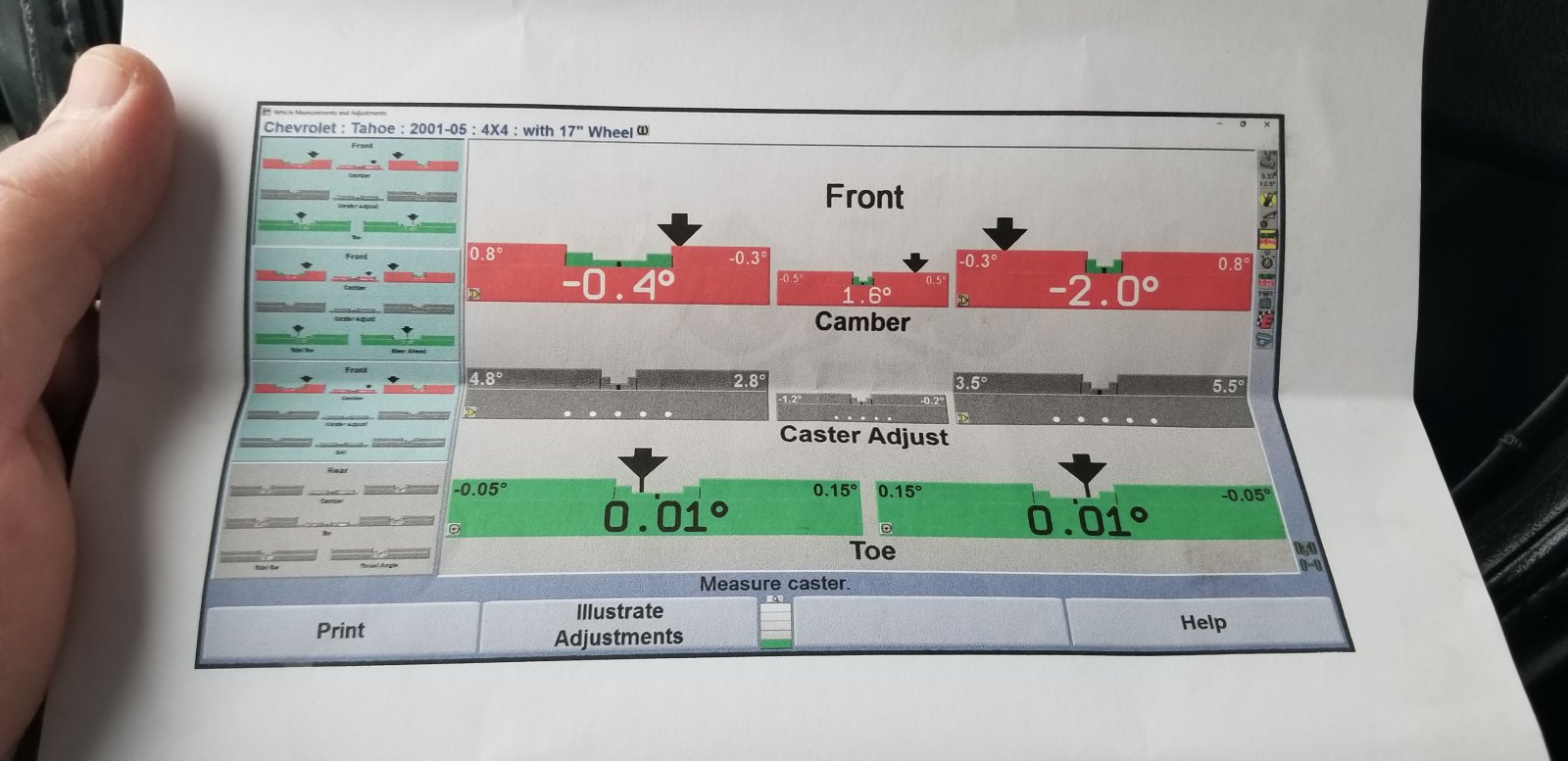

How does this look to you guys? Supposedly he couldn't do 1 adjustment because he didn't have a special tool. What kind of bs is that? Does the printout look ok? I have no clue what I'm looking at. I was told my tires MIGHT wear on the inside.

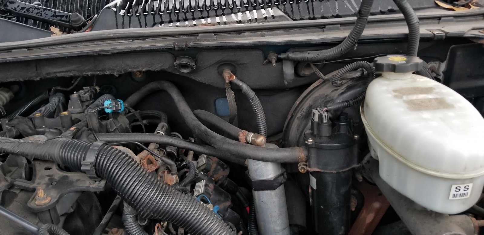

How can I tell which it is? It was fine before he did the rear lines. I hate this coincidence $hit:mad::mad:
I would point to the master over the booster. If you can pump your brakes up with the engine off and the pedal slowly drifts to the floor after doing that several times its the master. If they pushed the master all the way to the floor when they bled the rear lines they could have damaged the seals in it.

I just tried that @George B and the pedal is firm and holding pressure while off.

Red means out of spec. [emoji107][emoji2959]
