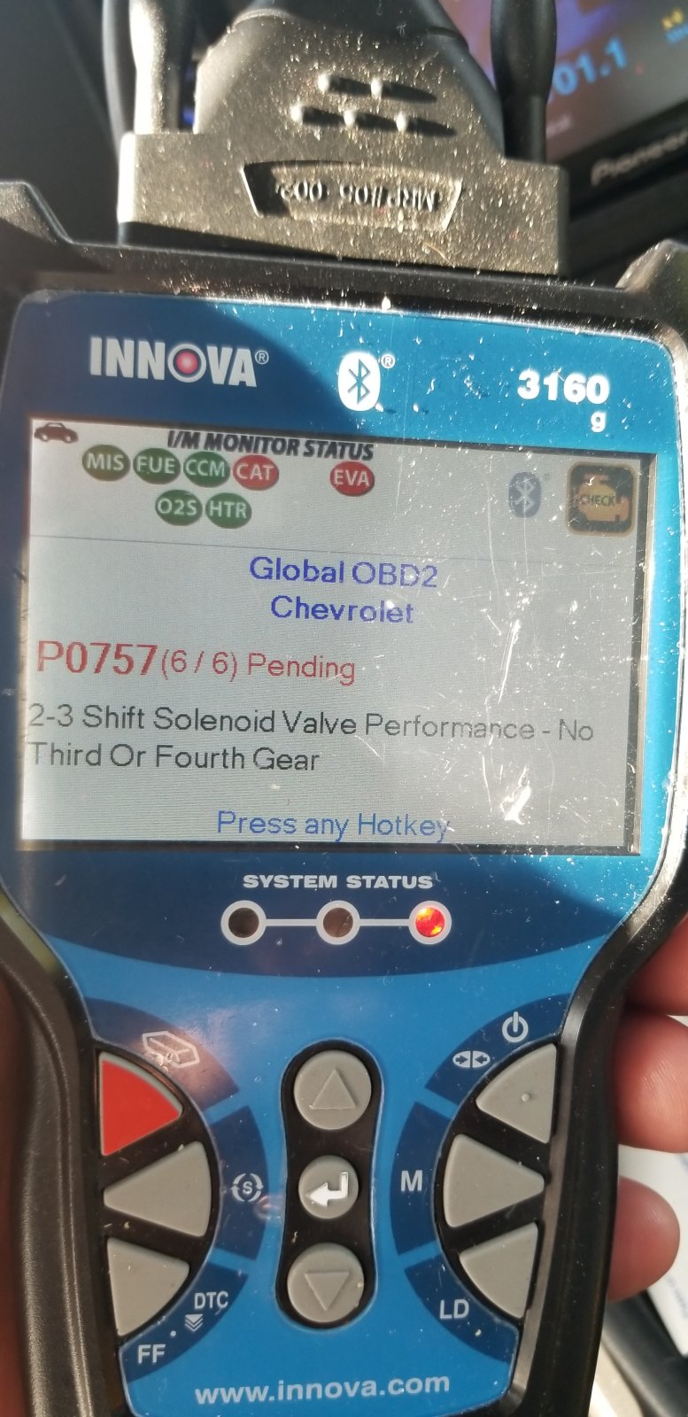

Just keeps getting better :mad:
My only vehicle left--the work van.
33,344
51,835
Check your connector at trans. They are known to leak past the seal or could be a bad connection. If you can. How’s the shoulder bud? Hangin in there?
Hey Jim, thx for chiming in.
I went to the trans guy, got both solenoids swapped out. Trans fluid was burnt. Changed it out 6-7 months ago. He said it's most likely the tc going out. It shifts again, but the rpms are higher then it should be, and it shutters when taking off from a stop. FML!!! So since there's no more GN, Tahoe STILL isn't done, I'm screwed when this goes out. Yay me.
My shoulder is slowly coming along. Thx for asking. I can already see it won't be 100% tho, and I'm still having pain. I have a Dr appt tomorrow so I'll see what he says. My buddy just said I should have the Tahoe Friday. I've heard that before. I'll believe it when I see it!
