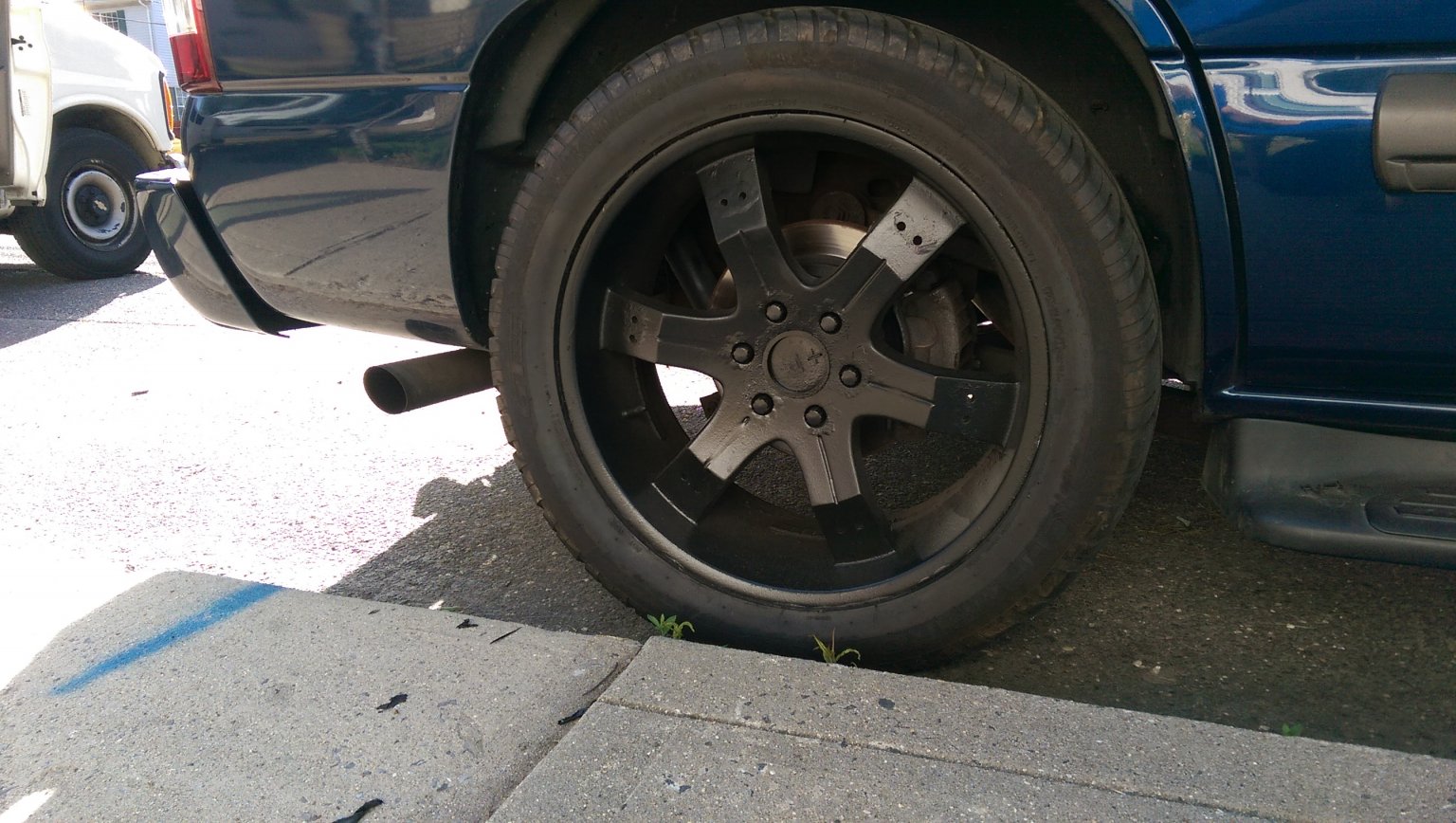

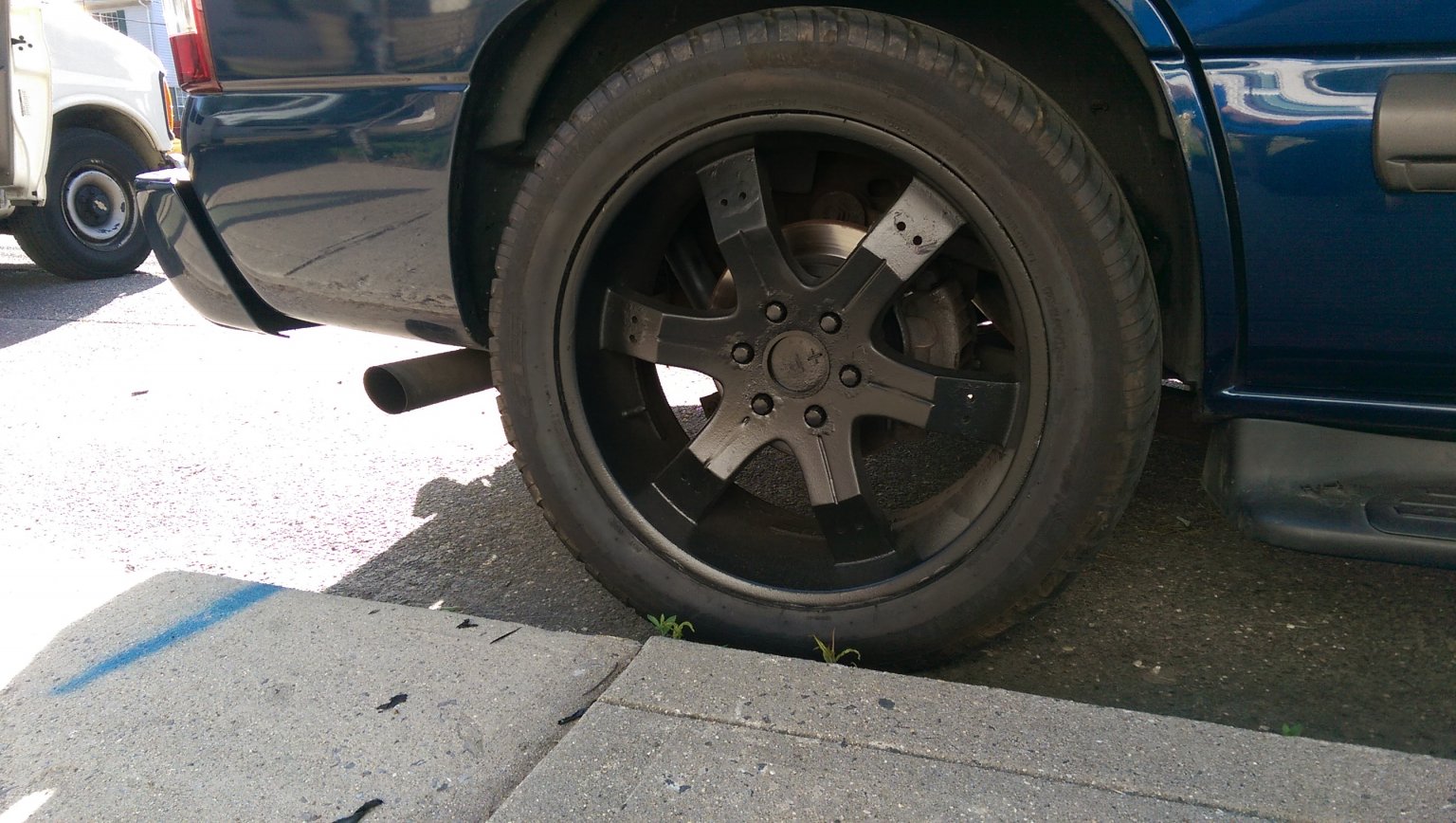

I finally put those fake plumbing /center caps on my rims. If you didn't know, you wouldn't look twice. I used silicone, so hopefully it'll stand up to centrifical forces and heat with no problems. If I miss 1 or 2, I bought spares.

I finally put those fake plumbing /center caps on my rims. If you didn't know, you wouldn't look twice. I used silicone, so hopefully it'll stand up to centrifical forces and heat with no problems. If I miss 1 or 2, I bought spares.View attachment 82222 View attachment 82223
