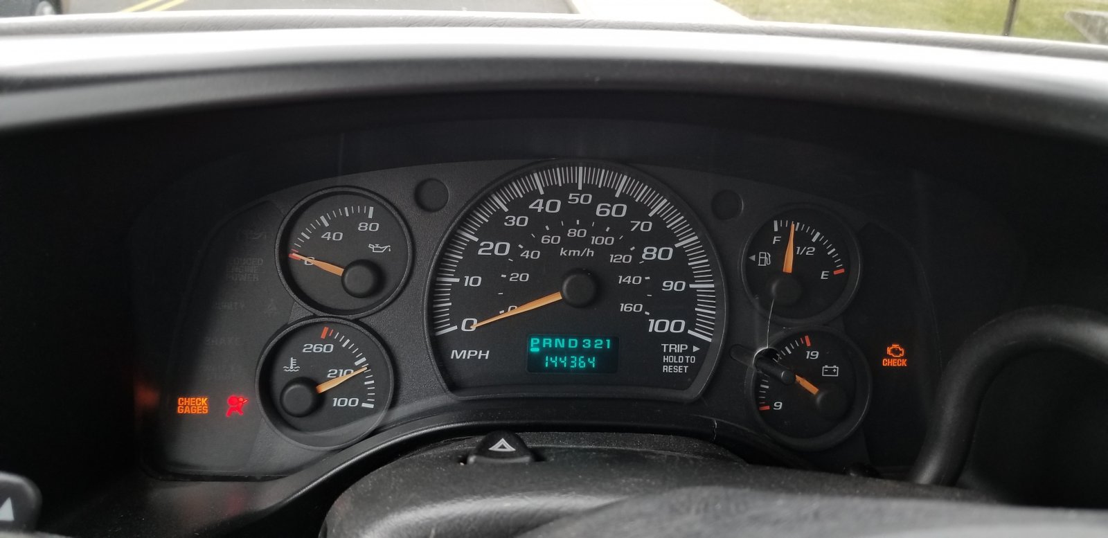

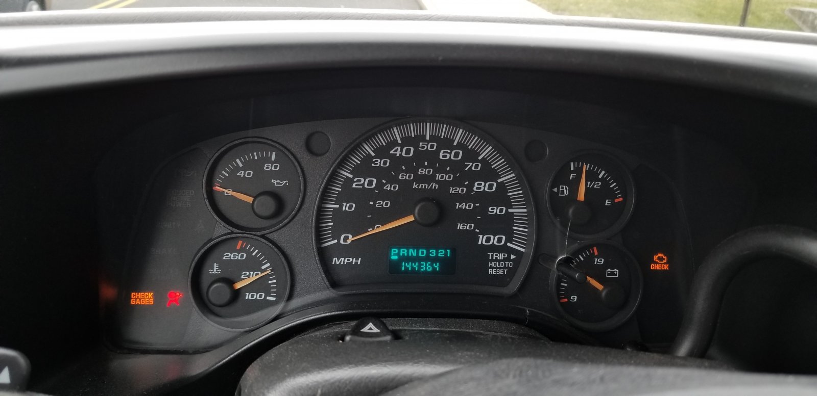

uh........well, it does say to check your engine. did you check it? LOL
Maybe a faulty sensor or gauge? Any loud racket going on? Rev it and see what happens :crazy:
I thought it might've been the sensor--but I don't think so. It's tapping like a mofo. If I rev it the tapping gets faster, not so sure about louder, just faster.
Wtf?! This is your express van I presume..? Noises? Leaks? Rattles and clanking?!?
Yup--my work van--my LAST vehicle. Anything happens to this I'm SCREWED!! No leaks, rattles or clanking, but I'm having to refill the overflow bottle every few weeks. No milkshake in the oil, or any other sign of a blown headgasket.
If this guy was doing 110 on the parkway again and blew another motor Imma put a foot up his arse!!!!!! :mad::Wedgie:
Nope. I was actually driving normal. Can't afford to hurt this one. I seriously can't catch a break.
Getting a friend of a friend to do the oil pump today for me. Gonna use a HV that I had for the hoe.

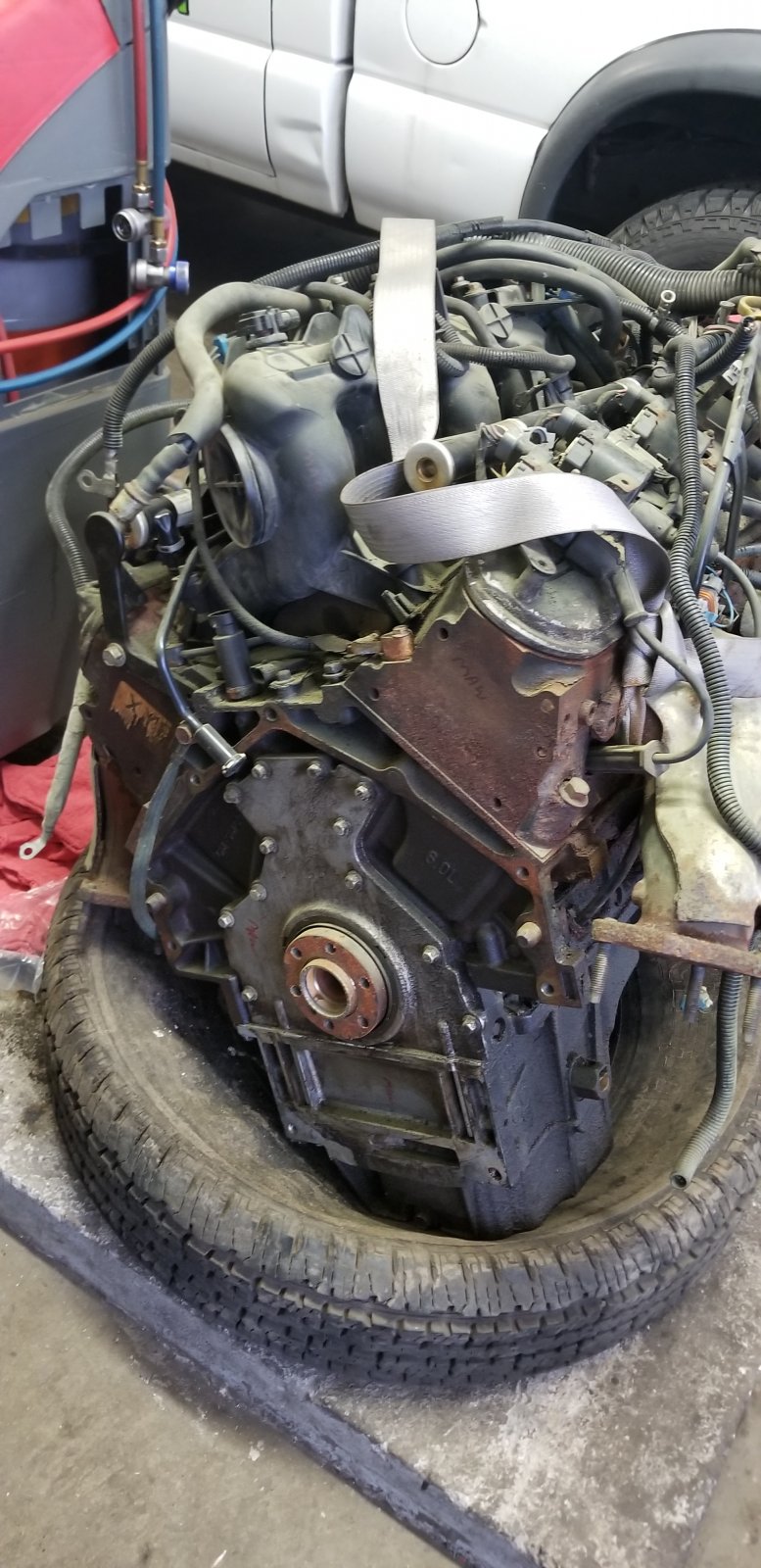

Had to get the Hoe's hv pump.
sux, but you gotta do what you gotta do. Also using money I had for the Hoe--so it's just gonna take a little longer to get her on the road.
