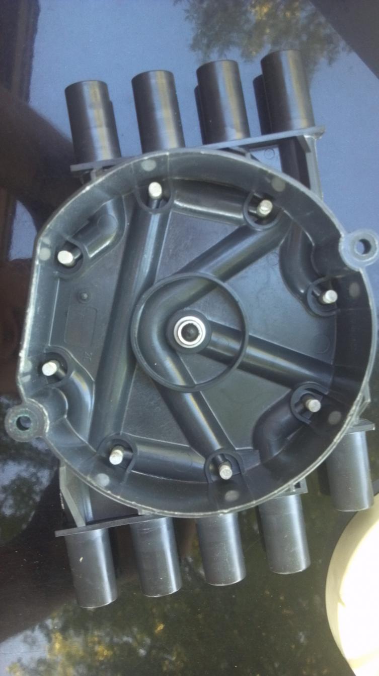

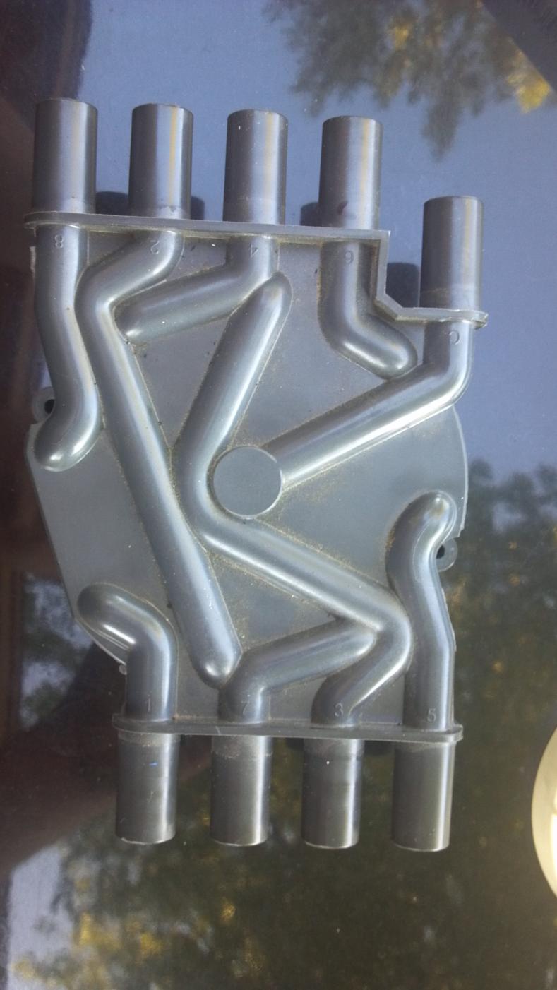

Well it was the cap. My delphi unit was only about 4 months old! No signs on the interior or exterior of the cap that there was an issue. Replaced it with a new AC Delco unit and it works great! Sounds like a quality control issue to me, there must have been porosity in the injection which allowed the arc to blow through and then #2 and #8 were interacting with each other.
Thanks for all the help everyone!
N
Nichoms
Sep 10, 2012
Sorry for the huge delay, just got married yesterday and was busy with planning stuff for the last month or so...
So I couldnt find my old receipt to verify what brand Cap and Rotor I had but switching to a new AC Delco fixed my problem. Here are some pictures of my old Cap and Rotor. Can't see anything wrong with them but there must have been a crack or something internally between 2 and 8 that was allowing them to cross.
