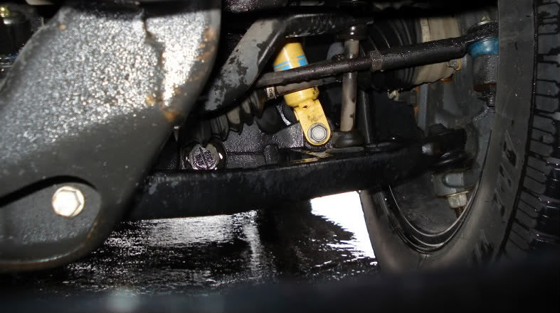

Napa premiums or the moogs, check out www.rockauto.com for a good deal on the moogs or o'reilly's will price match. Doing mine made a huge difference you may also want to check the pitman arm, idler arm, and the bracket that attaches to the frame from the idler arm...mine were smoked at 90k but the new stuff works real nice
inverted cv angles ftmfw :rocking:

Lol Max is that you fog HID relay hanging in the pic?
Max
Mile High
May 3, 2009
3,570
33
Denver
Just the lead to the bulb and it was cable tied. I have new ones since that pic.
