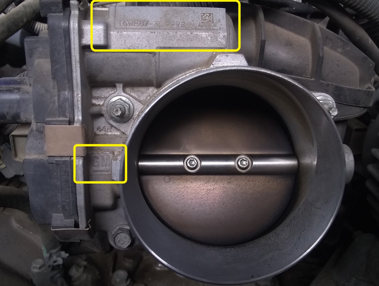

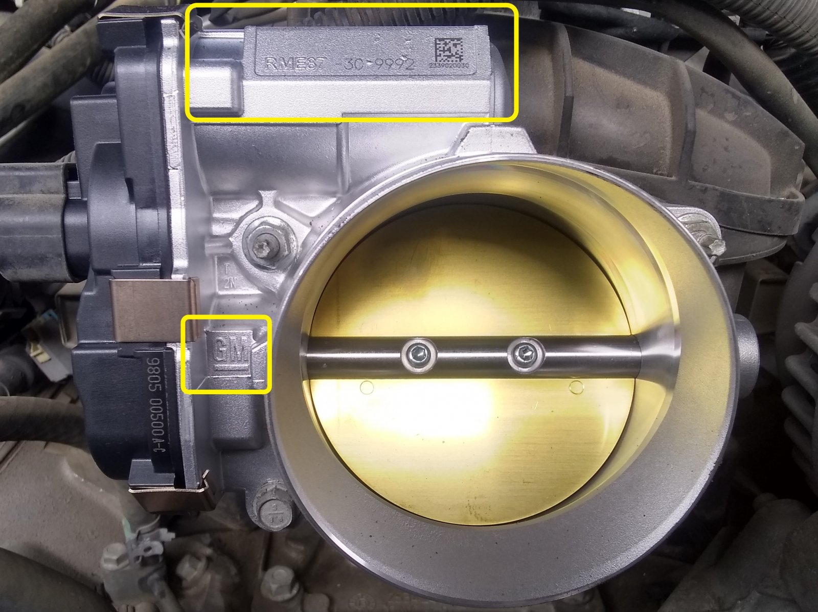

Here's photos of the OEM that was on my vehicle and a pic of the new ACDelco. Where does it say Hitachi is OEM?
Both have the GM stamp, same model # and QR Code.

OEM Throttle body is a Hitachi.. So if you bought a reman or another brand that is
probably the case...
Also: why did you replace it to begin with????

Hitachi makes them for GM, may or may not be visibly stamped Hitachi
usually you can pick up a Hitachi boxed one for a few bucks less than oem and still have the same product
Oh yeah, saw that. It's about $150 in difference. Figured with the weird issues I'm having, didn't want to take the chance of introducing something else with what might not be OEM. I learned the hard way when I swapped in an OBDII fuel injected engine into my old Jeep and tried to save some dough by not going the OEM route.
