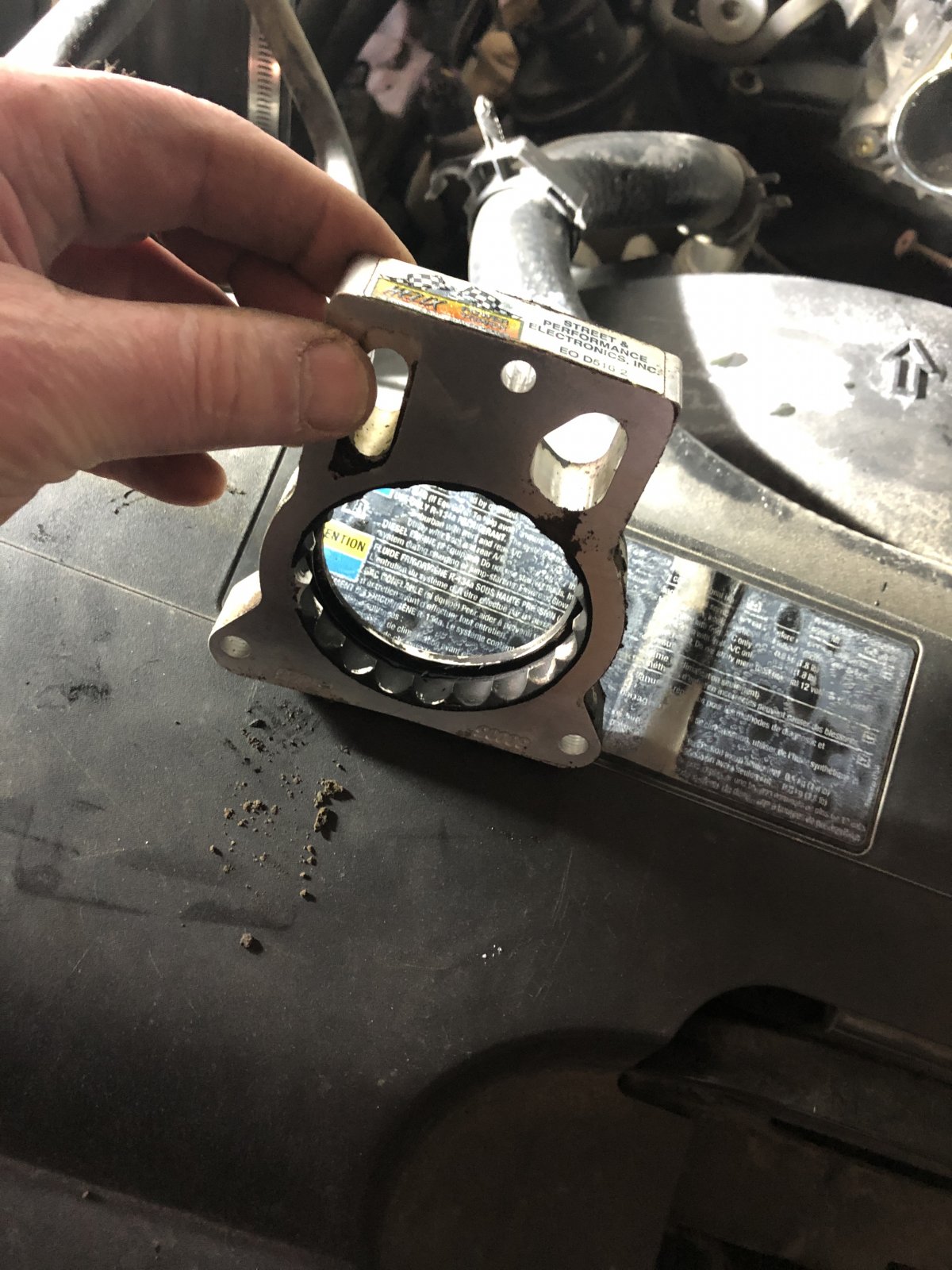

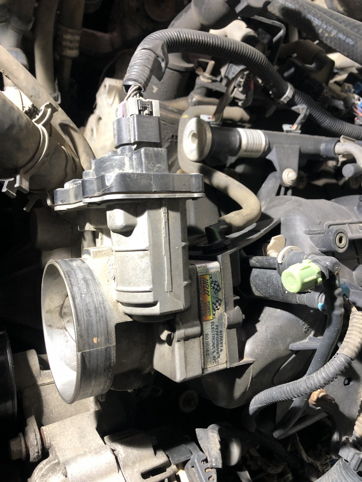

All right so got it off. I appear to have an aftermarket one with a spacer.
Looks good and dirty.

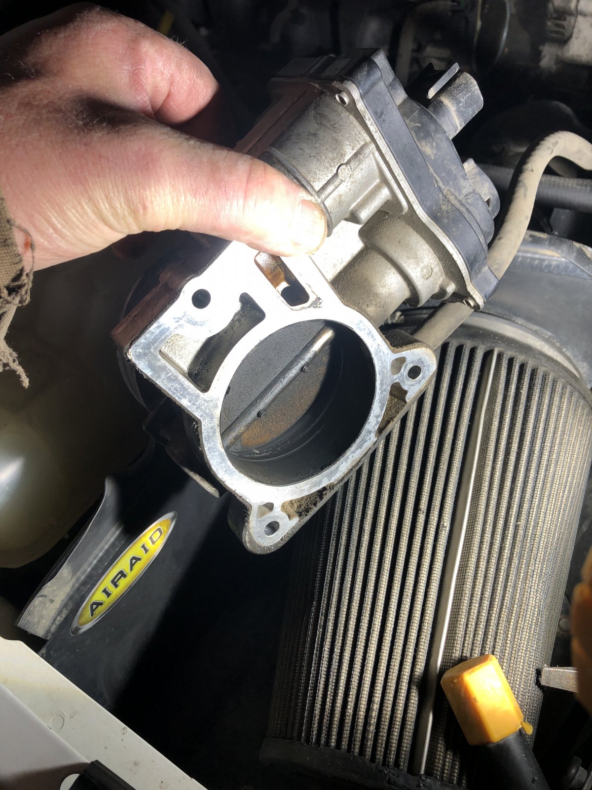

Cleaned up,a part of me wants to take the butterfly plate off but Im not doin' it.

Don't like mesh K&N stuff. The spacer is supposed to help cool air flow. Two seals now.
