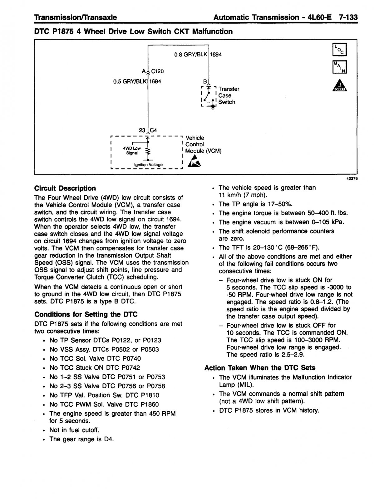

The GM manual has the diagnostic for the code, here are the pages for P1875. I’d agree that the catalyst code could be disregarded if it was there before these symptoms appeared. The rest of the manuals (four volumes) can be downloaded here:
