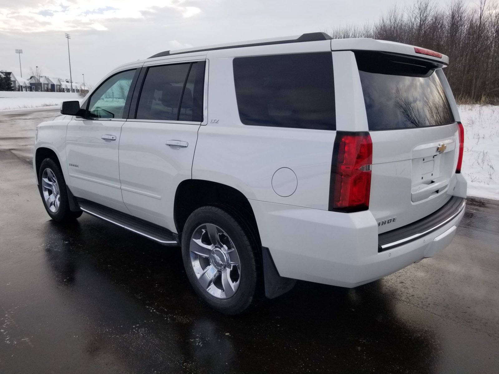

Pics of the truck, please.

okie dokie. pics to follow
