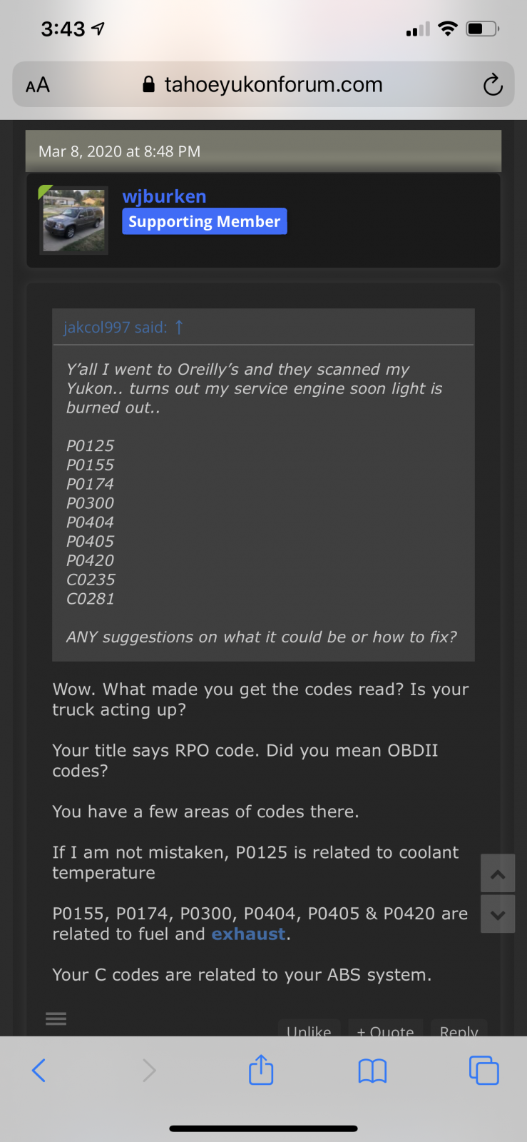

When they Oreillys scanned it. 15, some were duplicates. 9 total though

What were the codes?

If it were me, I’d get an online subscription to alldatadiy.com. It’s about $30/year and has the factory diagnostic charts for each of those codes.
At a glance, one is for the coolant temperature sensor and two others are for EGR, I’d start with those first. The random misfire code (P0300) may be a result of the others. One is also an oxygen sensor and another for catalyst efficiency, those two may be related (the oxygen sensor code being the result of a damaged converter) which itself may be a result of an upstream fuel issue. I think one of those codes was for a lean condition.
So, I’d start with the subscription, go through the tables and I’d bet it clears up your issue. Or, if you can track down a 1997 service manual it would have the same info. A scan of the 1998 is available here, it may be worth trying that first.

Crazy enough, doing a coolant flush, replacing the thermostat, coolant temp sensor & pressure sensor got rid of all but 1 of those codes!! All that’s left is one for my exhaust
