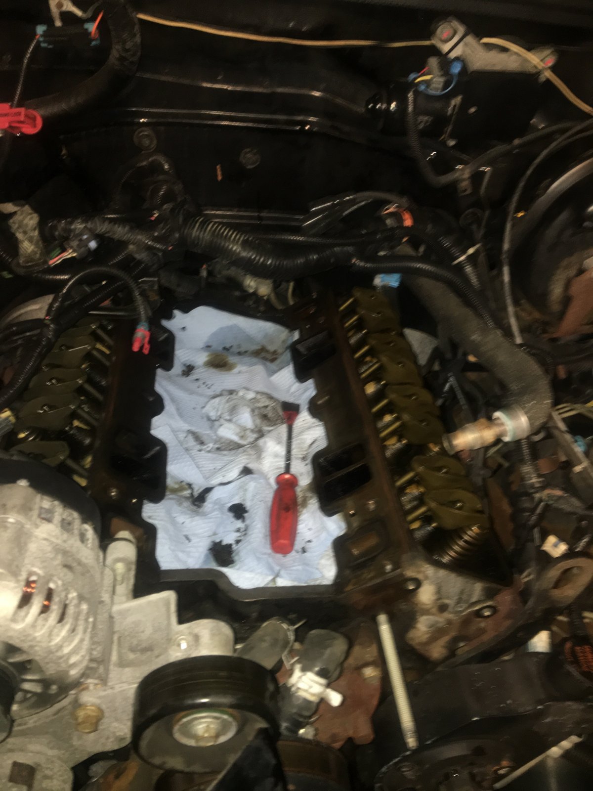

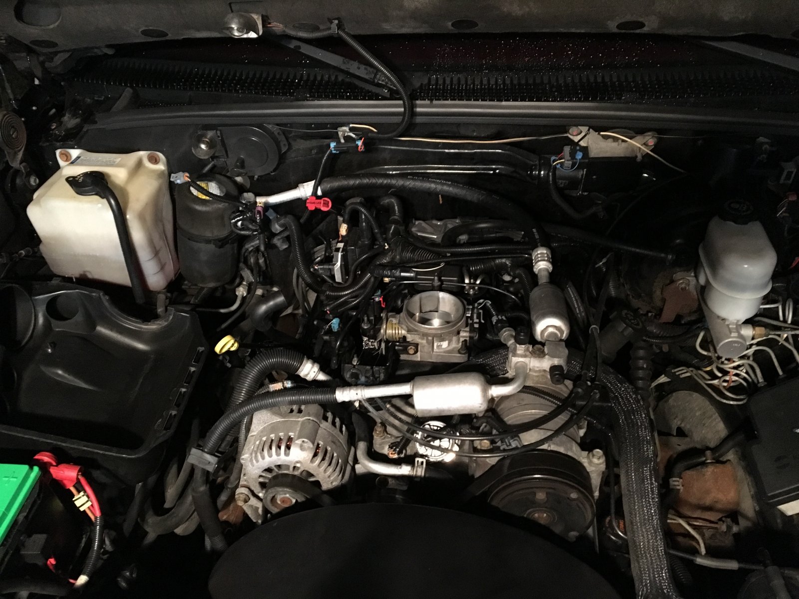

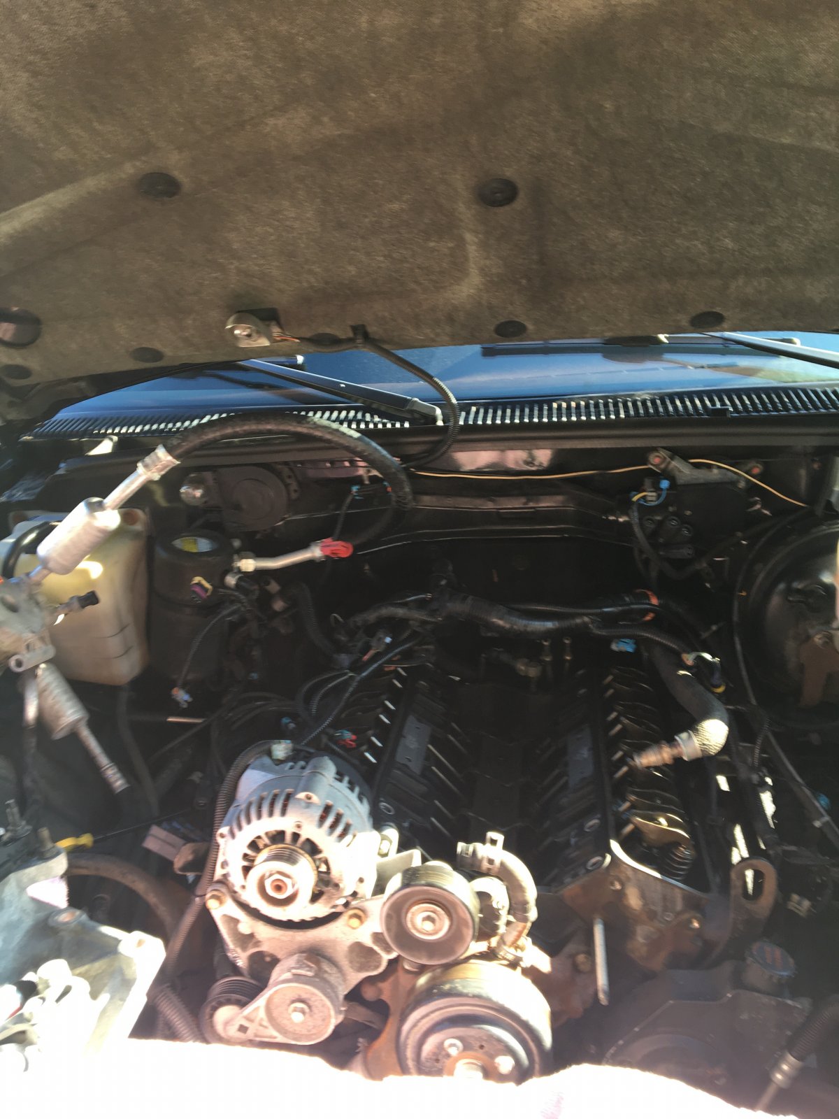

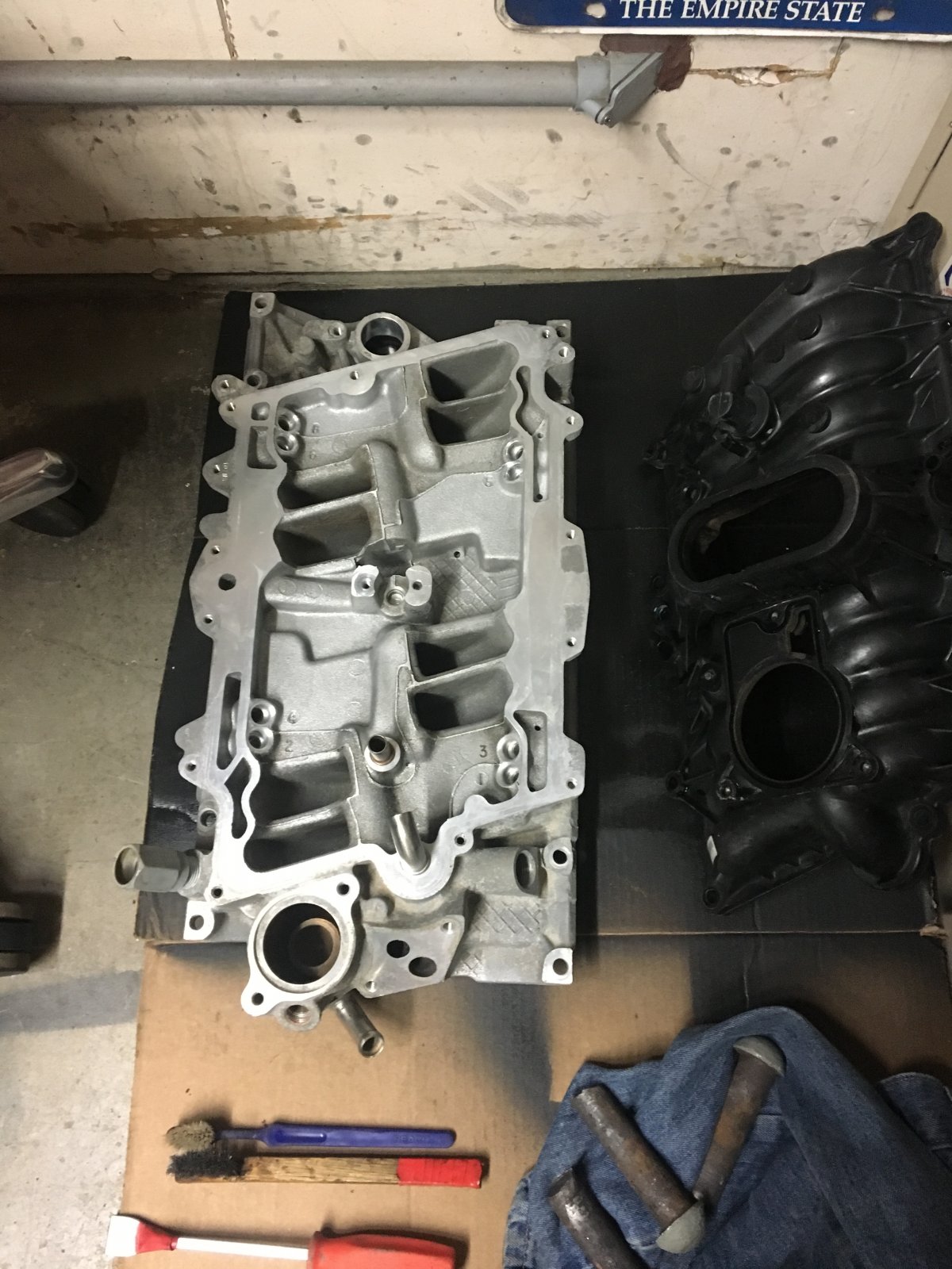

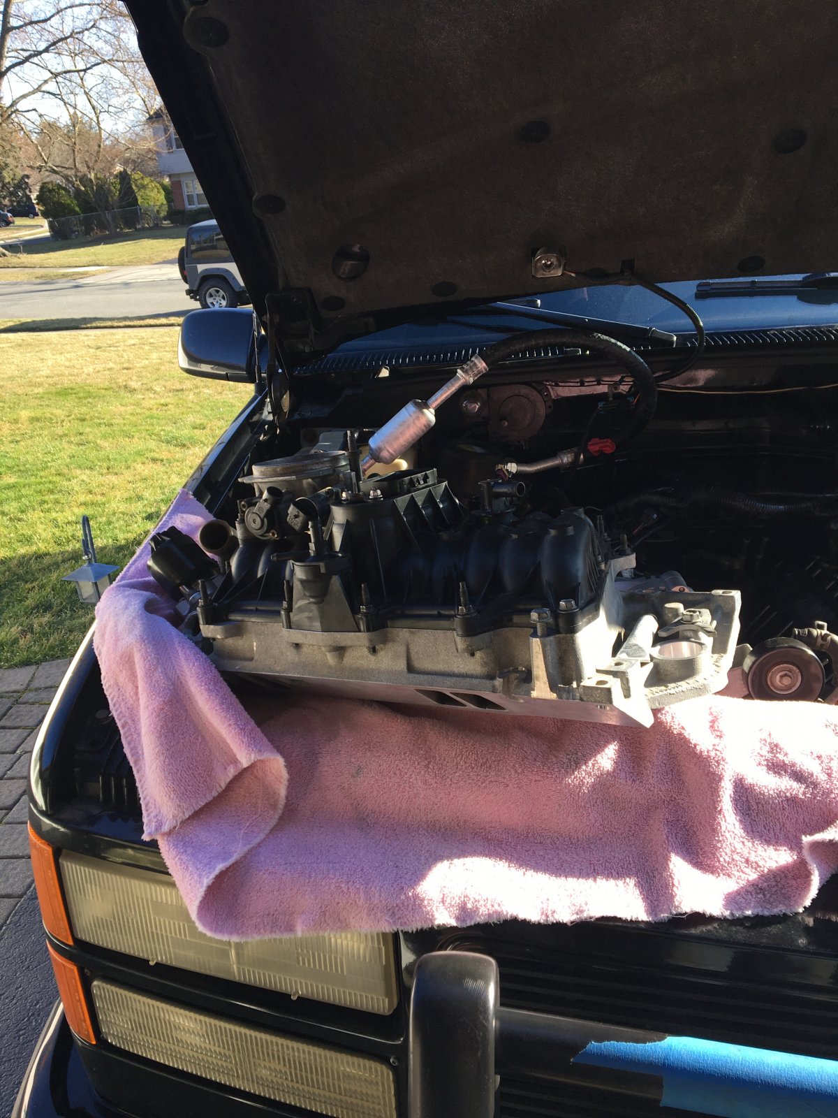

Here’s the upper intake ( black plastic) lower intake
( aluminum) out and reassembled this is a big job to take on for some even though others say maintenance it’s buried under a lot of sh#t ask a friend to possibly point you in the right direction google or YouTube has videos on checking for leaks

couldn't ask for better pictures to know what your looking for. and it is definitely a big job and a bunch of ways to make it worse than it already is.
