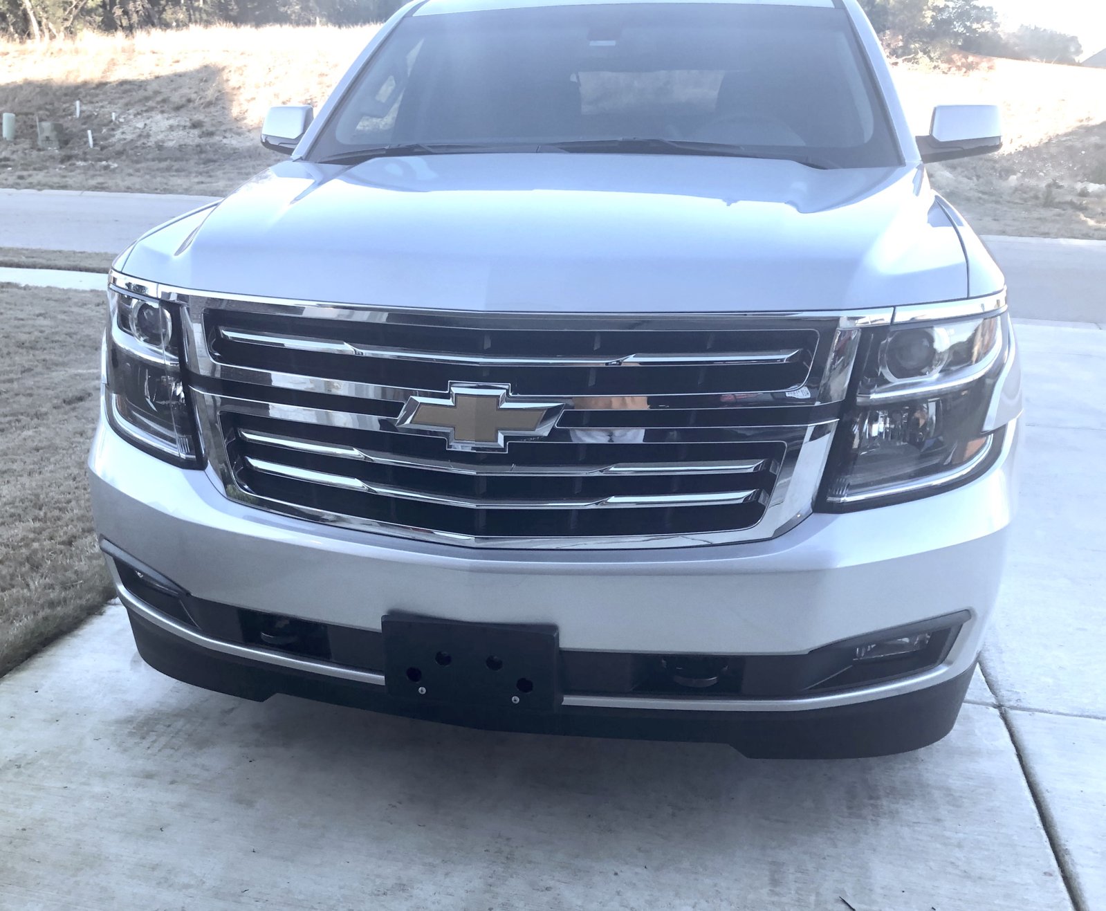

I'm very happy with my LS Custom edition 4x4. I have the max trailer package, body colored door guards and nothing else. After the sale I added tow hooks and fog lights for about $300.

The dealer claims there is no way to add fog lights. I bought the OEM lights and brackets along with a Gen5diy harness. The tow hooks came from eBay and fascia came from the local dealer since he had one in stock.
22936482 Fog Lamp Assembly Bracket, LEFT
22936483 Fog Lamp Assembly Bracket, RIGHT
23332241 Fog Lamp Assembly
23332242 Fog Lamp Assembly
23245141 - Front Recovery Hooks in Black

Glad to help. You will still need the fascia trim piece. I don't have the part number for that since I purchased it from the dealer. You can probably get it online for less, but shipping on a 78x12x10 box might be cost prohibitive.

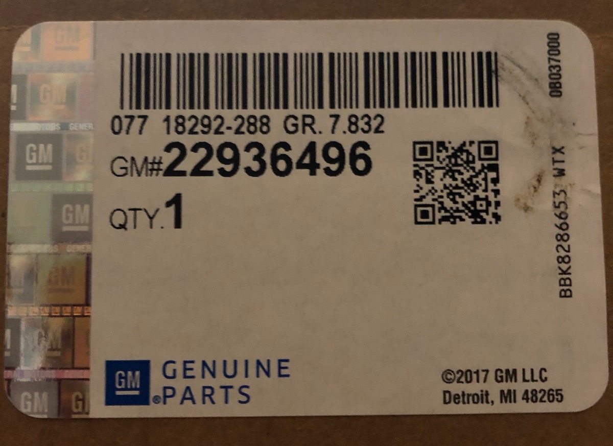

It is the black trim piece that includes the fog lights and the tow hooks. You can cut along the guide lines of the current trim piece and remove the rectangles if you like.
do you have a part number for this one?
thx!
