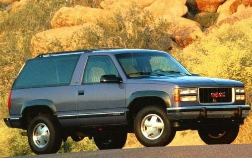

Here's what it looks like the paint is rino lining

Edit: Is it a Chevrolet Blazer? The GMC grill looks like a 90-93, they switched them for 94 to a body colored surround. With that and the hood, wonder if it was wrecked?
