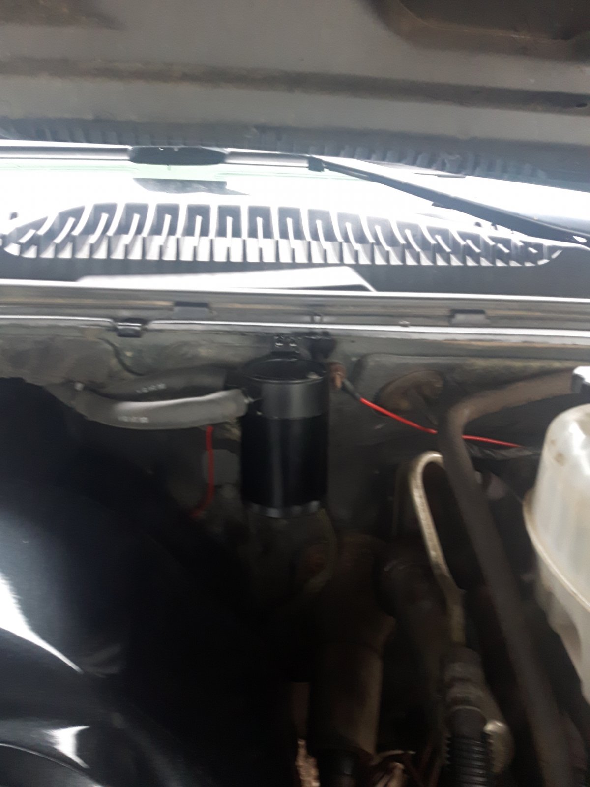

Catch can installed.

Looks good! I bought @Fosscore ’s catch can he had for sale. Should get delivered tomorrow. Any advice on install or a write up on the install? I’ve never done one so this is new territory!
Stupid easy to install. The worst was trying to find a spot that I was happy with for draining and routing the hoses. I used about 6ft of 3/8 fuel line for the hoses. Hook up the in port on the can to the pcv valve located at the back of the diver's side valve cover , the out port goes to the intake where the old hose was. I tried to run my hoses where the fuel line connects to the fuel rail on the intake. My reason for that is the covers fit with the fuel line there....lol. I started routing the out hose first since I figured that would be the worst line to do and it's also the longest for how I mounted my can.
