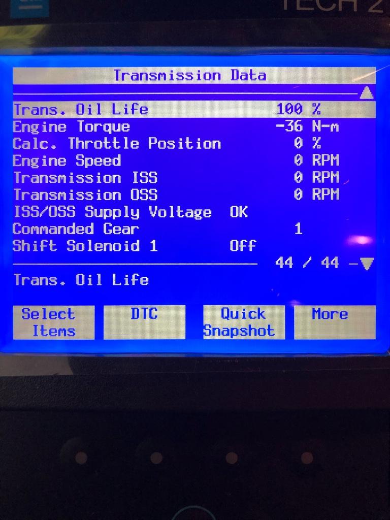

For those that like pics:
From the TCM screen, go to Module Setup
Select to reset
Enter the correct value (e.g. 100%) and select "perform reset"
Voila!
