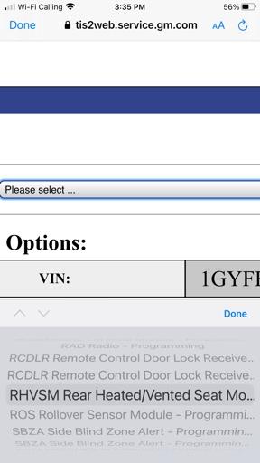

After entering your VIN, use the drop down box to view all the options for programming.
Nice!
