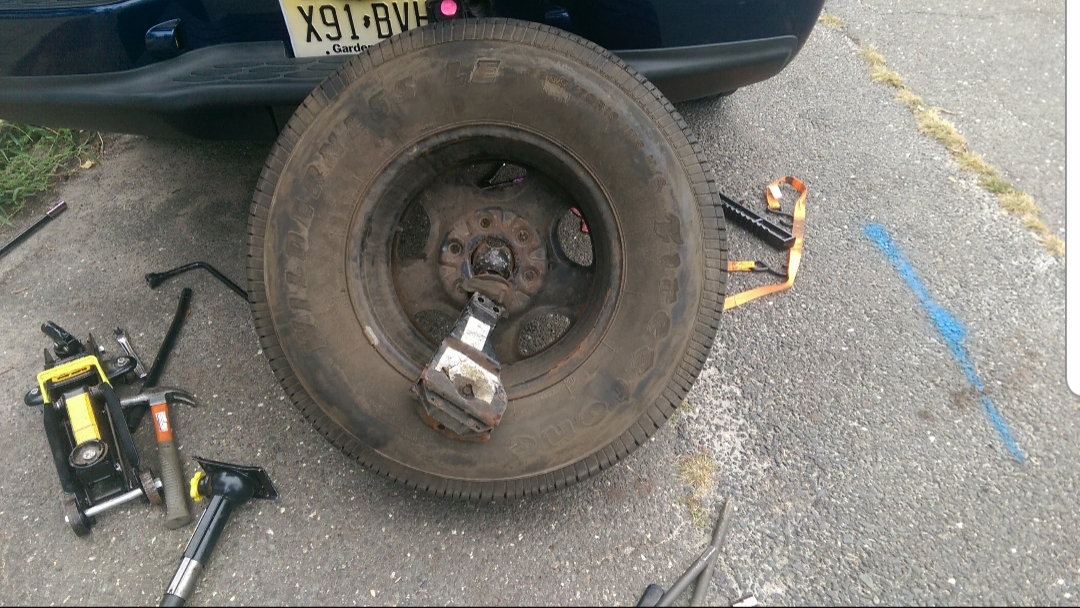

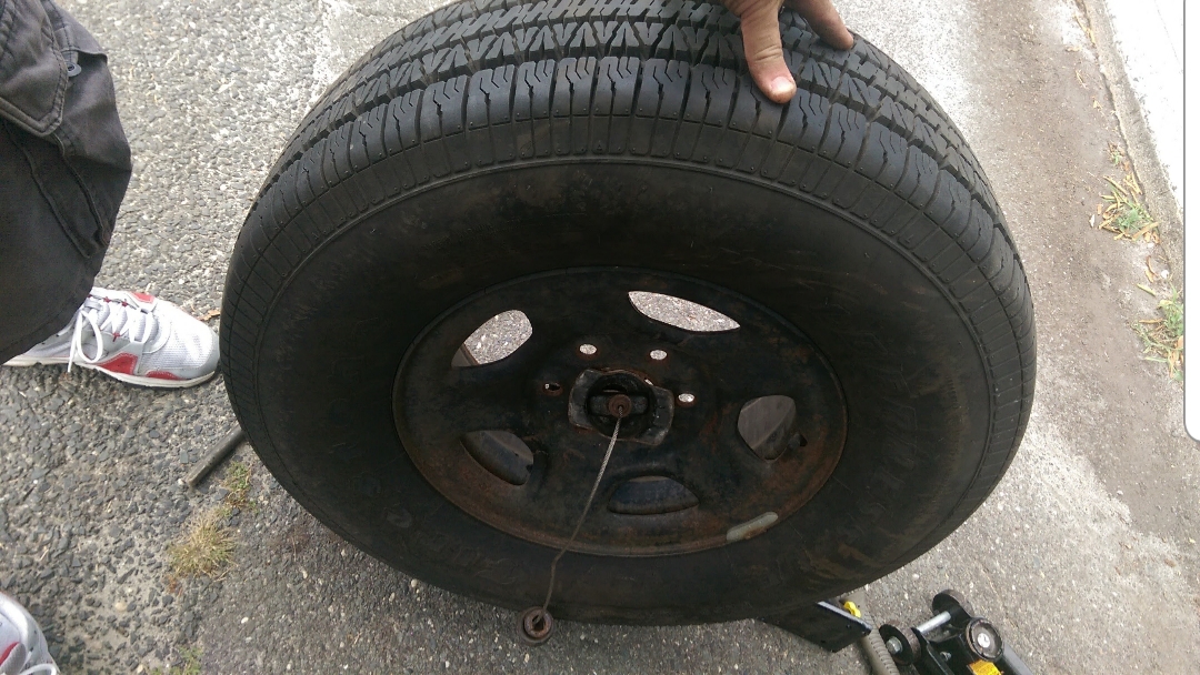

making sure the spare tire is accessible and good is crucial. My spare tire wouldn't come down and the manual says take the jack and push up on the spare to get the release mechanism to release. Mine wouldn't and I had to use Fix-a-Flat, which screwed up the sensor. When I got home I got a 12 ton hydraulic bottle jack and literally lifted the rear end (tires) 3 inches off the ground before it released. What a pain in the okole that was and still is. I still haven't found a place to purchase a new spare tire tower. And if I do is there a chance that it won't work right too! Anyone else have this problem.

46 bucks at rock auto or Amazon and these aftermarket units don't have that 'safety feature'. I replaced mine a few months ago. As long as you can get the spare out... It's a 5 minute job. Drench it in fluid film before and after install.

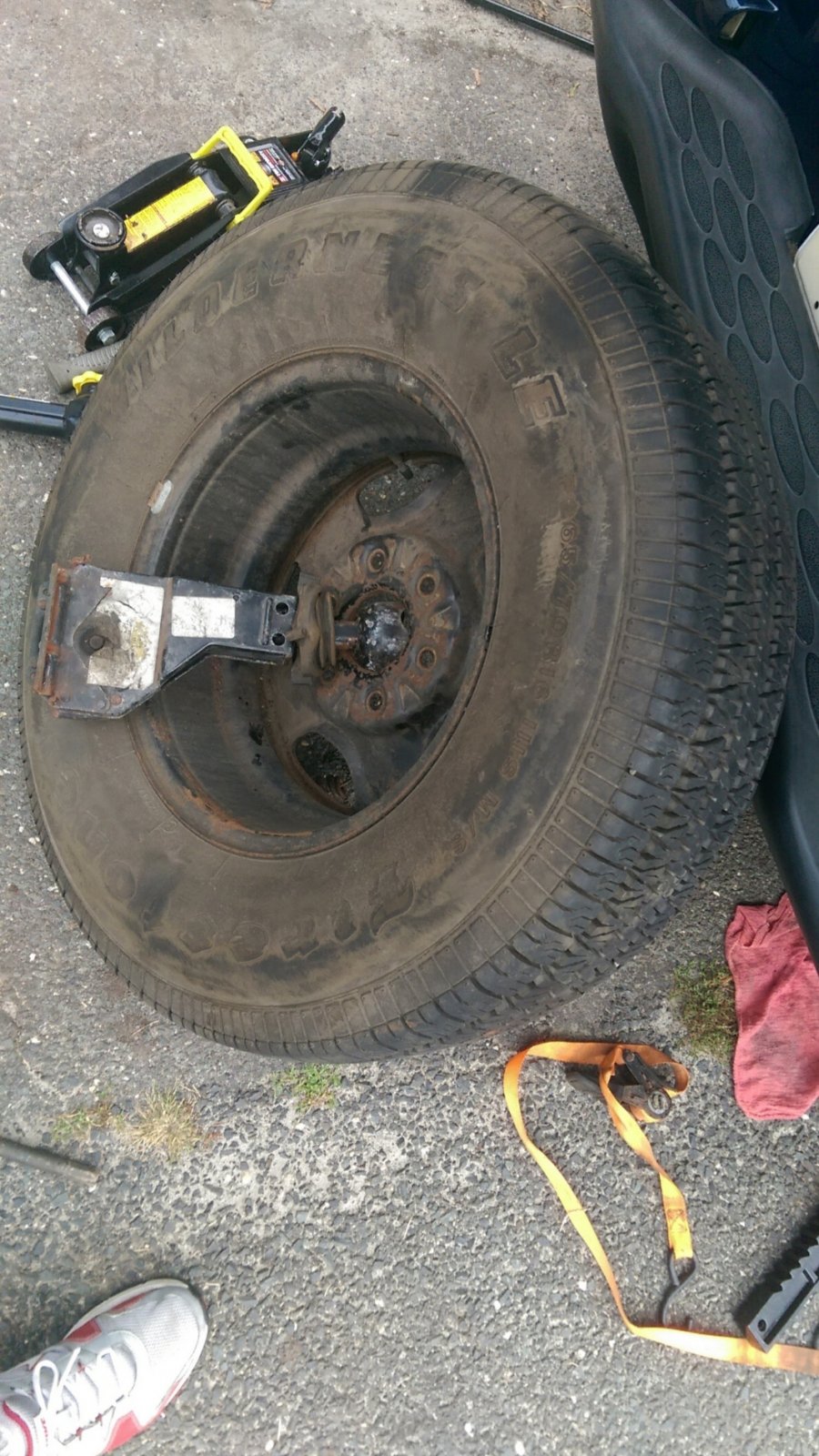

Using the jack to push up the spare method never works. I had to unbolt the entire assembly--the spare was still attached--and I had to bent up that arm that's on that safety feature, just to get everything apart. It sucked.

So did you replace the unit? Or ar you driving without a spare? Like I am...
Neither, I just pried out that arm on the lower mechanism
Which released the other arm. It was gtg after that. I still have my spare, although I did this 3-4 yrs ago. I've never needed the spare since I did this.

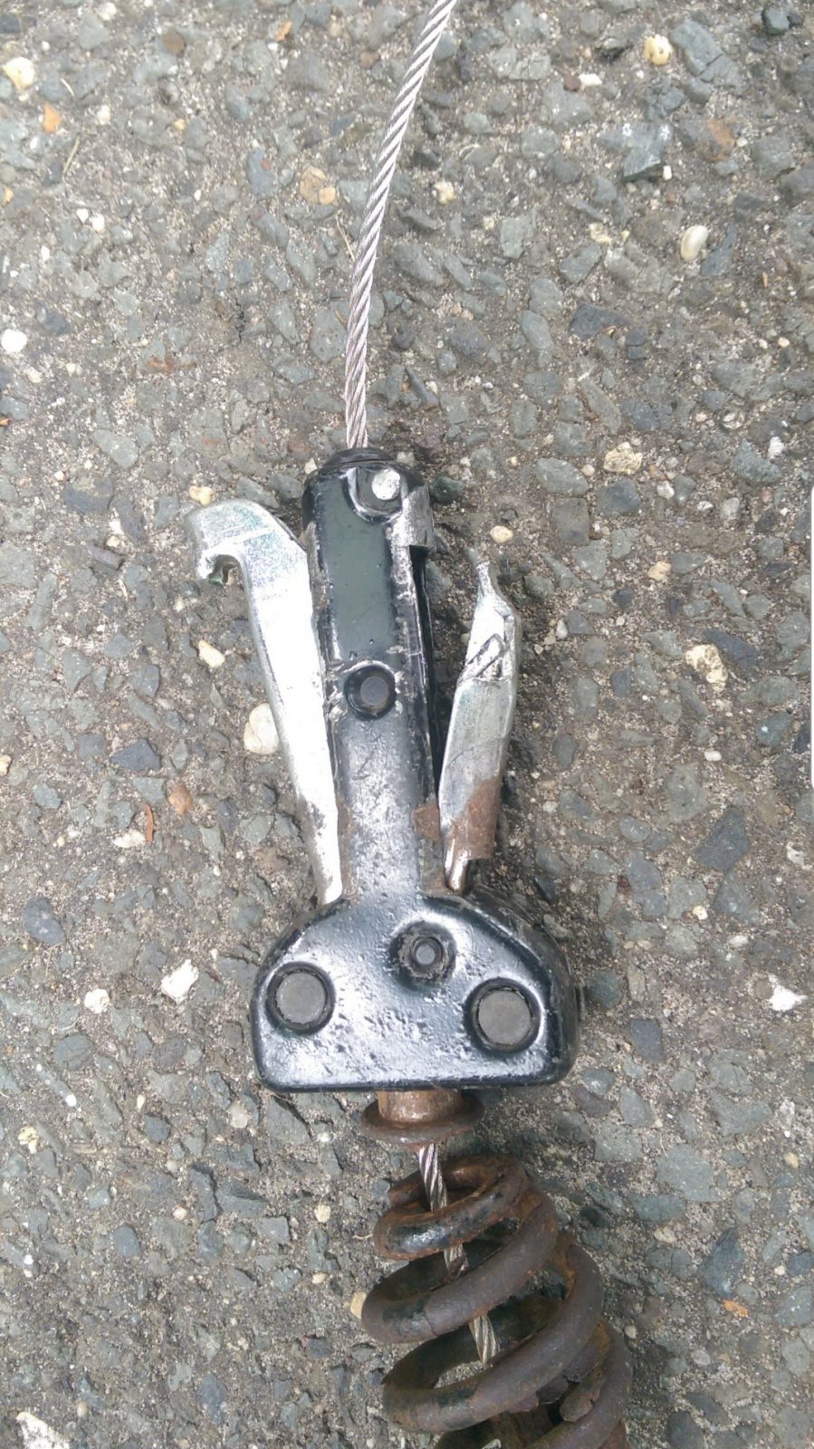

What's the best thing to spray this cable and mechanism with while I have it pulled out?

What years is this design on? Mine seems to only have a T and a cable??? This doesn't look like anything I have unless I missed something.
This one isn't original to my 03. Someone cut the original because they couldn't get the spare done. I think this one came from an 05, but I'm not sure.
