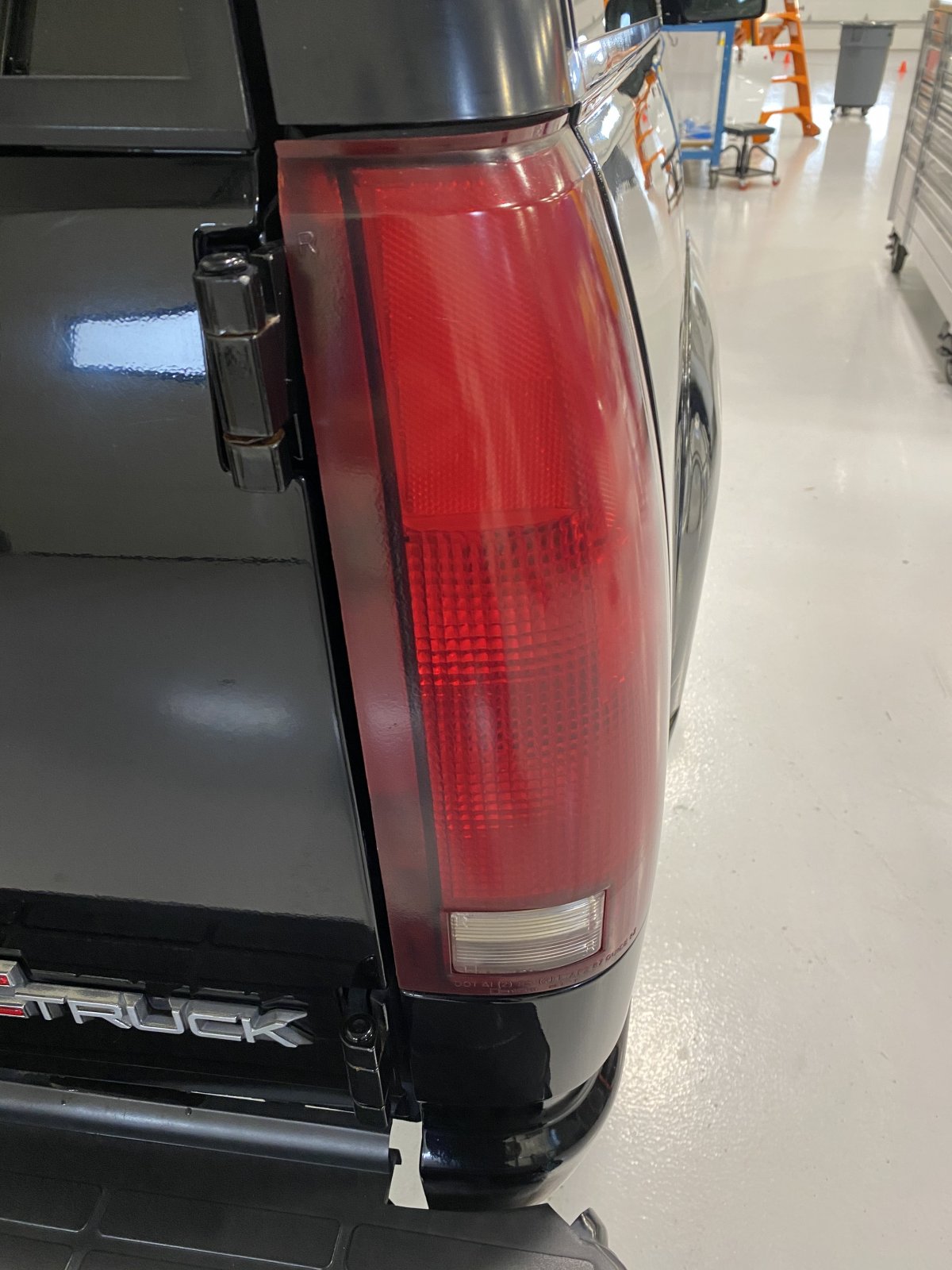

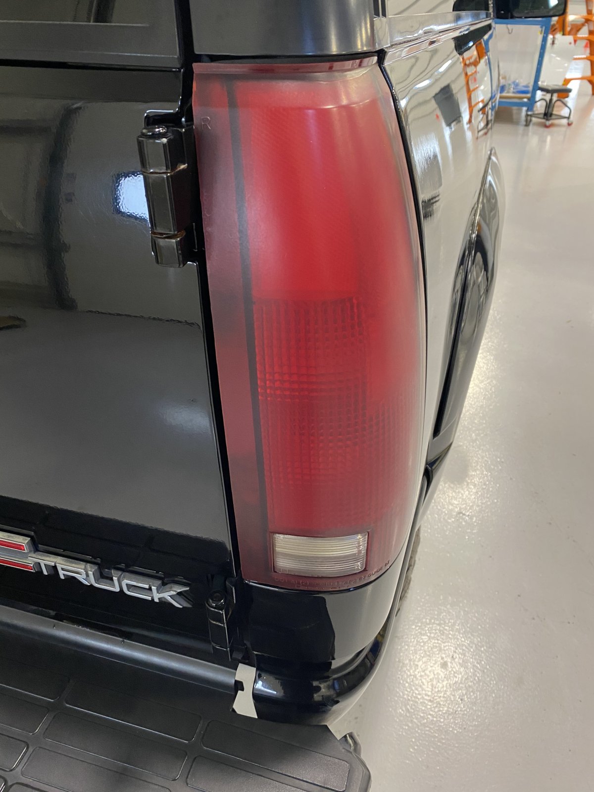

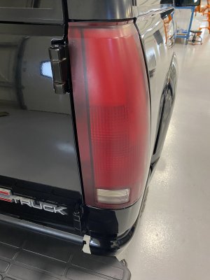

My Tail Light Lenses on my 97 Yukon GT were looking very dull and hazy. We have a Micromesh kit at the hangar, that we use to polish plastic aircraft windows. It comes with cleaner, abrasive paste, and wet sand paper. It works awesome on headlight lenses that erode over the years too. I just hit it with a lint free cloth and the 2 pastes. Turned out nice.
