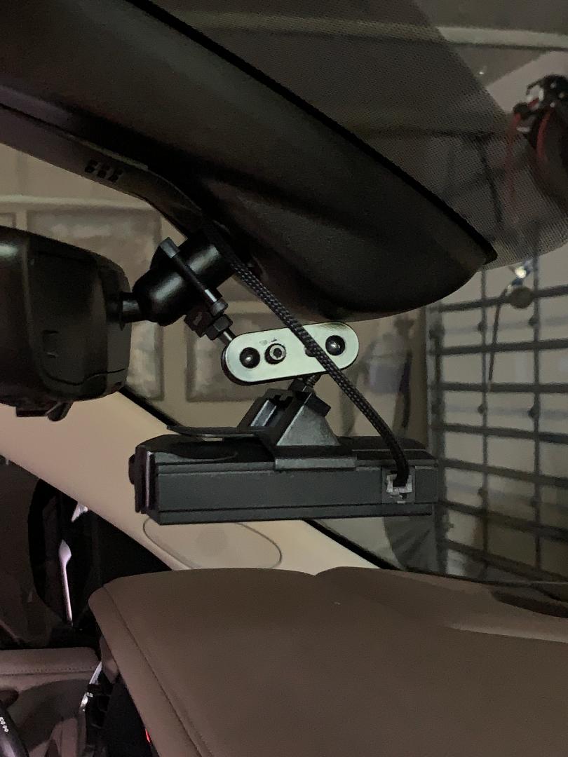

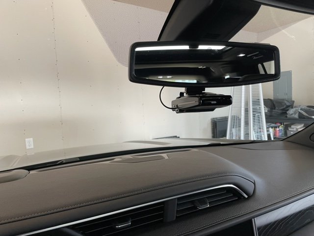

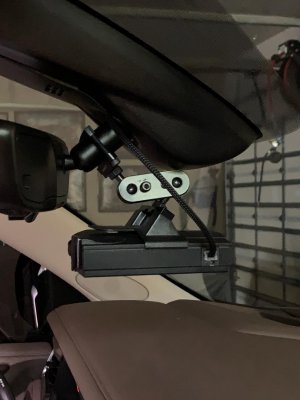

I installed my V1 right under the mirror and hard wired right there. Very easy to do! You use an 8 inch wire which is made with pins on one end with your detector connection on the other end. All you are doing is tapping right into the plugs already there. No cutting of wires, spicing etc. As long as there is power to your mirror, you can power your detector/cam etc. It works with starting and turning of the vehicle.

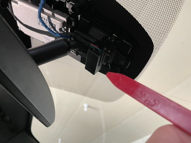

I used the BlendMount/MirrorTap on my 2021; + is the mauve/purple and - is the black with the white stripe.
To clarify, I'm using the plug at the very bottom of the area covered by the mirror/windshield housing. I'm also using the vehicle end of the plug, rather than the end that goes to the mirror and associated equipment. Works flawlessly and powers up with the vehicle.
The mirror taps have worked well for me in this and prior vehicles, but that custom harness looks promising. The BlendMount mount is a game-changer though over suction cups or adhesive.
View attachment 357877View attachment 357878
