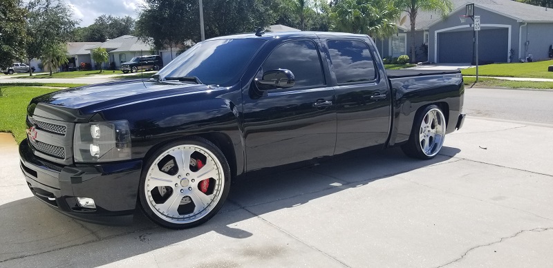

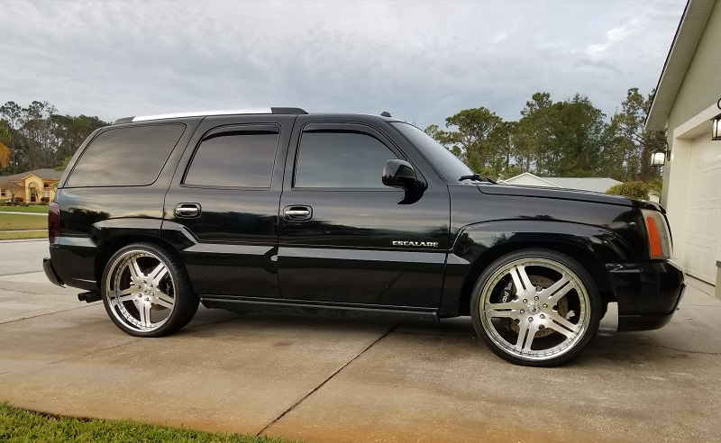

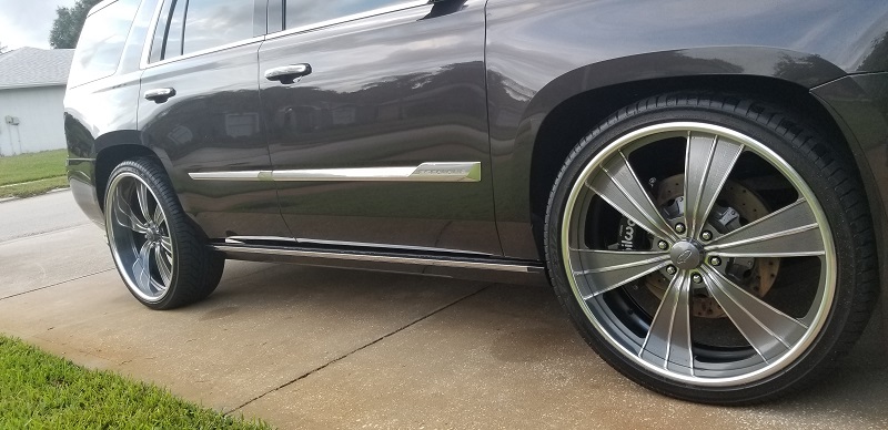

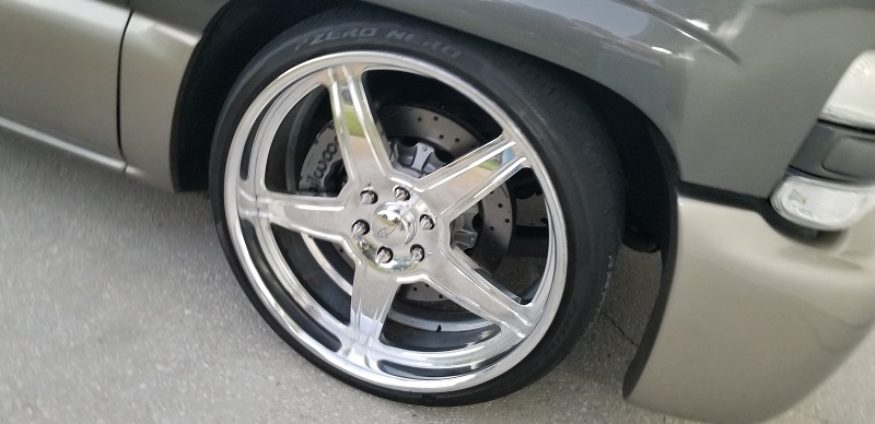

For that kind of price why not go WIlwood? I did that on my Crew Cab first. Liked it so much I did my 02 ECSB, The 2005 Escalade, & the 2015 Escalade. Now working on color matching the calipers for the Escalade. I willl swap the Escalade Calipers when I have a small block.
The brake rotor rings can be removed and changed out which might make the Wilwoods a possible option. Good luck with your choice.
Resized 20190724_200826.jpg 20190522_202049.jpg Resized 20190827_152059.jpg View attachment 235150 Resized 20171227_141802.jpg
View attachment 235145 View attachment 235146 View attachment 235149 View attachment 235150 View attachment 235152
