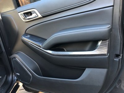

Not the best photo but here is the grey that I have in my Tahoe.

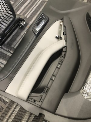

Loving the grey color. I just swapped the grey in for my center console on my 2017 Denali. I have a door panel coming with the grey wood, hopefully its easily swappable from one to the other.
cbraga
Dec 29, 2009
64
48

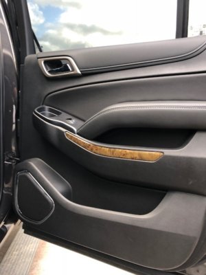

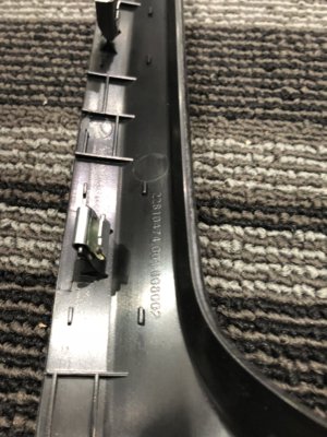

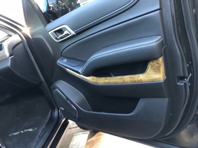

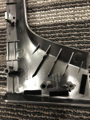

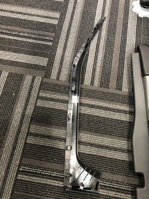

So it is possible. There are screws that hold it on along with clips. You can see I broke two of the clips getting it off. Need to be careful when removing.

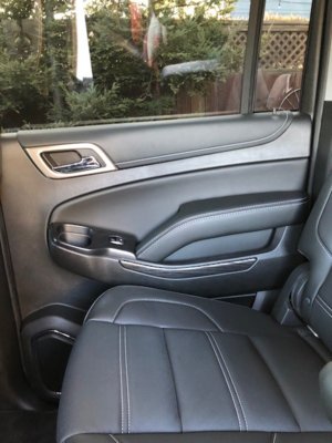

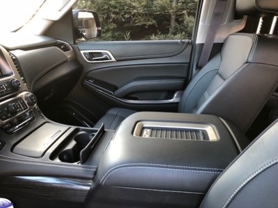

Loving how it turned out!! Why the hell is this not an option from GM!? Pretty straight forward swap, rear door only have one screw. I don't think wrap would have looked as good in my opinion. Now to sell the grey/black door panels with my wood trim installed
