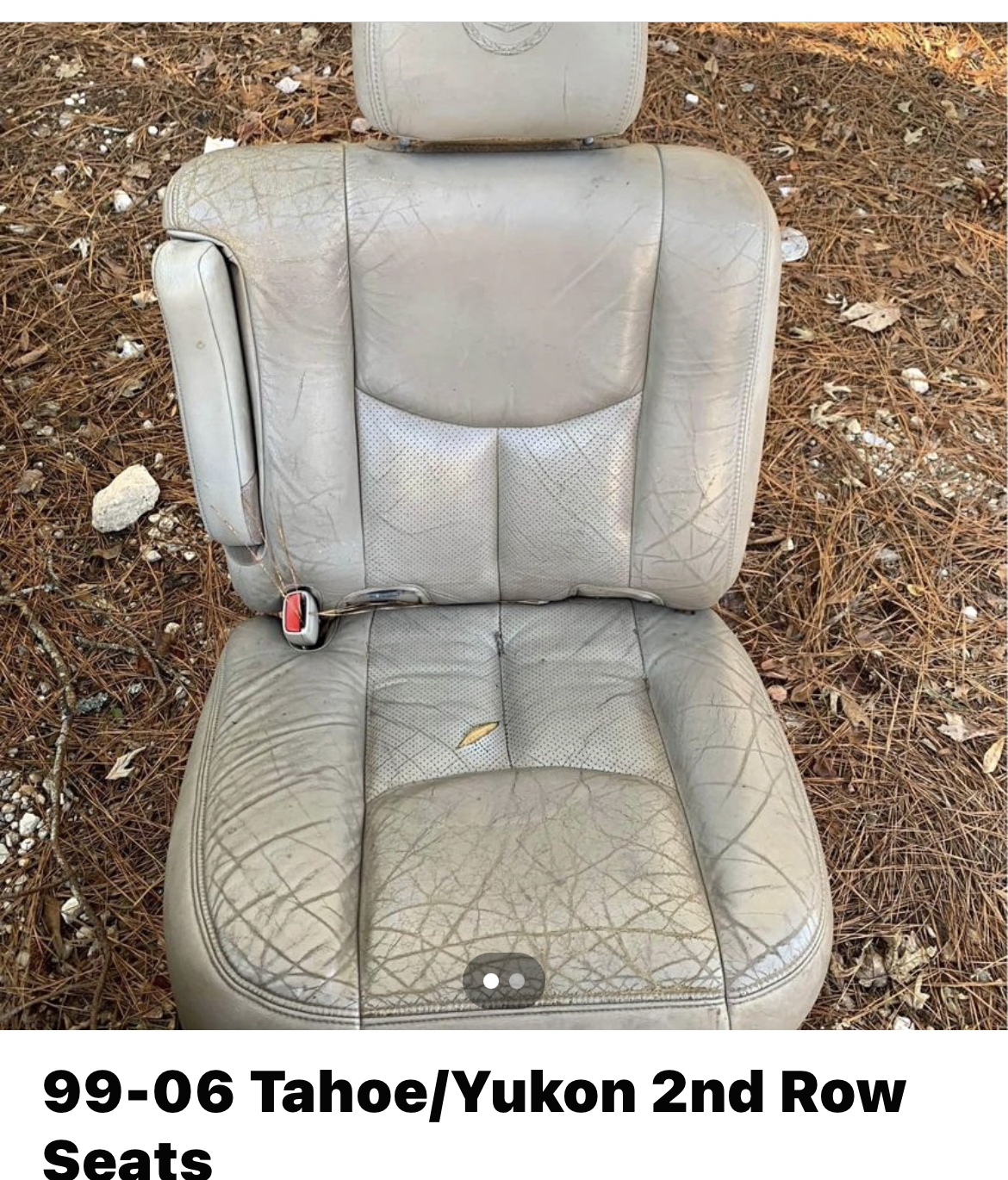

Recently purchased immaculate captain chairs out of a Yukon XL and didnt relize the floor was different in the XL than what I have in my 05 Tahoe. Found out they wont fit.
My solution was to purchase some ripped uo captain chairs out of an 03 escalade for $60. Hopefully I can put the yukon seats on the Ecalade seat frame. I know the escalde seat frames should bolt right in my tahoe.
Will this work?

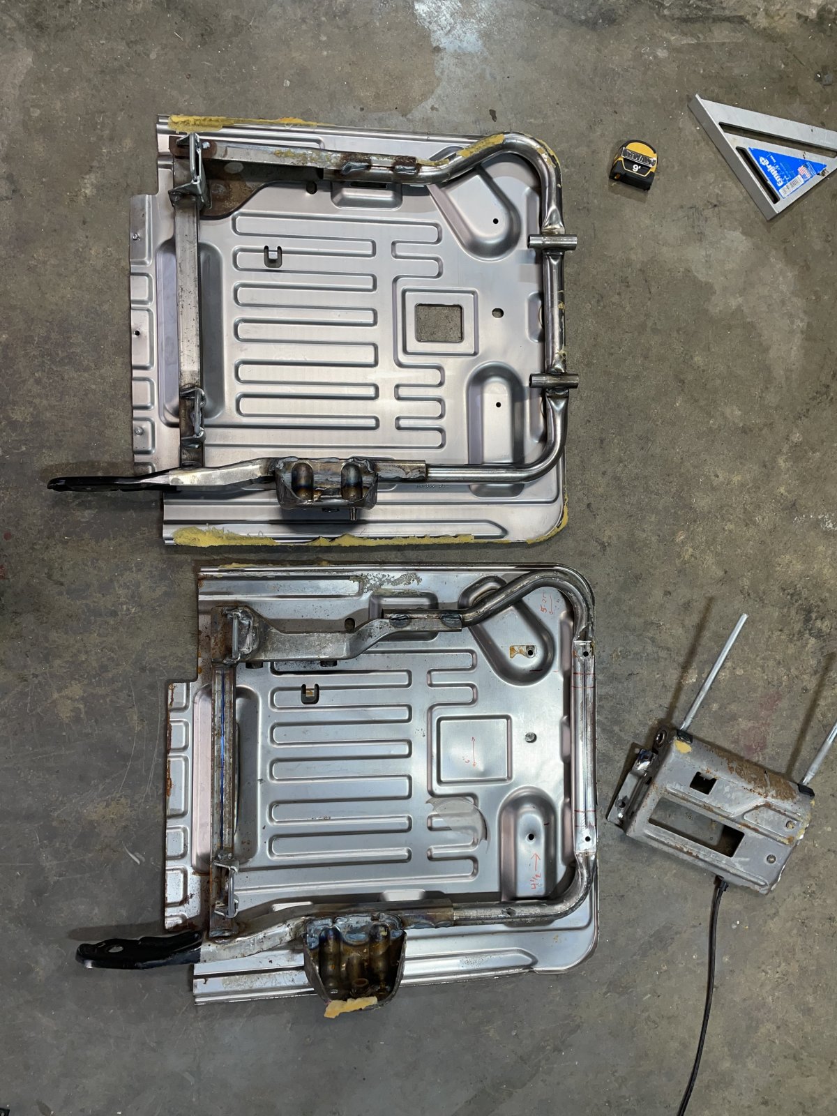

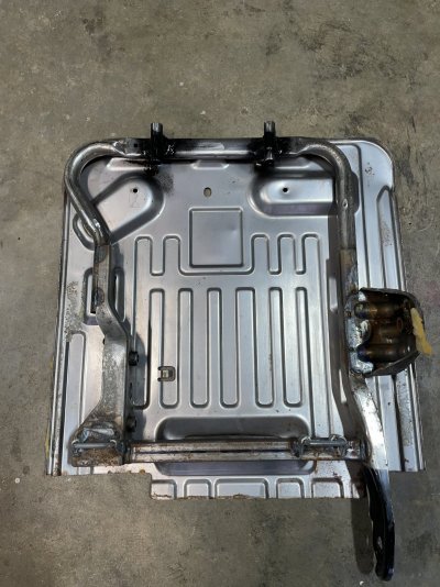

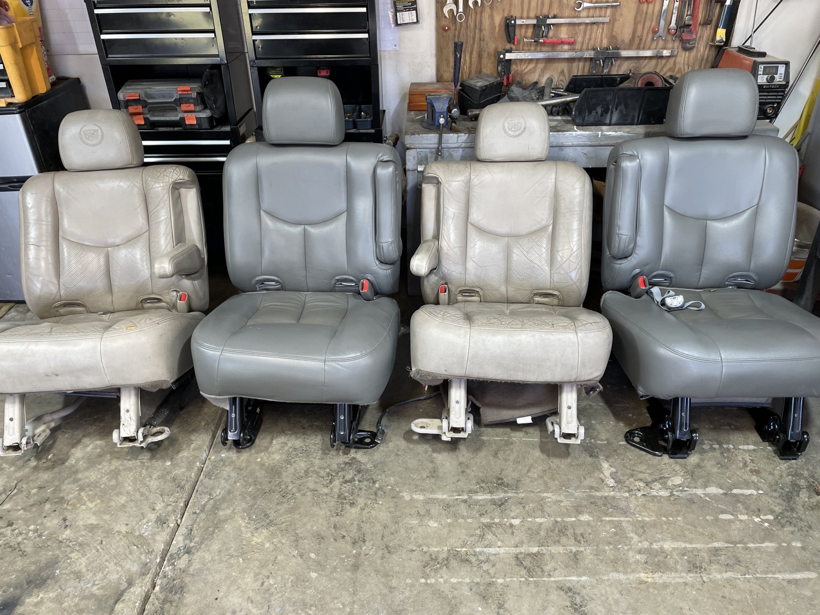

So the answer is that it can be done, but I had to buy a second set of captain chairs in bad condition out of a 03 Escalade and interchange some pieces. I used the seat brackets from the escalade as well as the upper seat frames.
I had to remove the seat covers from the top seat frame of the yukon seats and put them on the top seat frame of the Escalade.

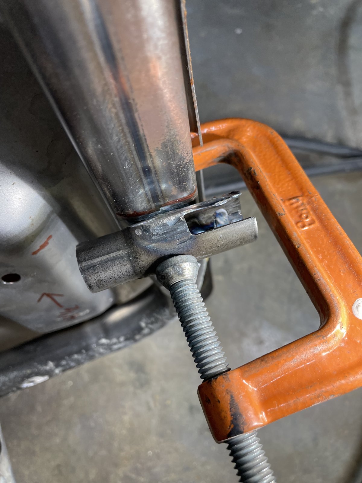

I also had to cut the headrest posts off of the escalade top seat frames, cut the post mounts off the yukon seat frames and weld them to the top Escalade frames. After all of this work, I was able to make everything fit and look decent.
