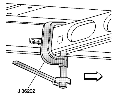

    Install the J 36202 to the adjustment arm and the crossmember .
  3. Increase the tension on the adjustment arm until the load is removed from the adjustment bolt and the adjuster nut.

  5. Remove the J 36202 , allowing the torsion bar to unload.

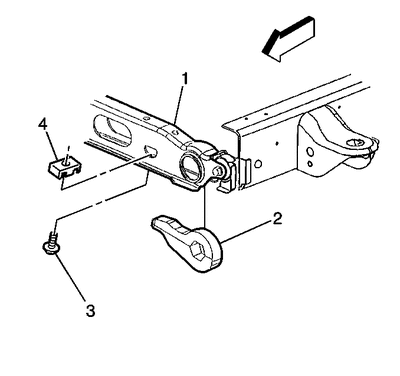

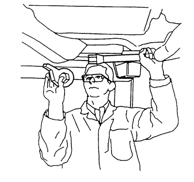

    Remove the adjustment arm by sliding the torsion bar forward until the torsion bar clears the adjustment arm. Use your hand to support the adjustment arm as the adjustment arm releases from the torsion bar.

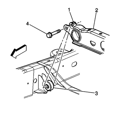

    Remove the torsion bar crossmember bolts (4) from the weld nuts (1).
    Click to Enlarge
    Install the torsion bars to the lower control arm.
  2. Install the torsion bar crossmember.
    Click to Enlarge
    While supporting the adjustment arm, slide the torsion bar rearward until the torsion bar fully engages the adjustment arm.
  5. Install the J 36202 to the adjustment arm and the crossmember.
  6. Increase the tension on the adjustment arm in order to load the torsion bar.
    Click to Enlarge
    NOTE
    Important
    Install the adjustment bolt the same amount of turns that were required to remove the bolt during removal.
    Install the adjustment bolt (3) and the adjuster nut (4).
  8. Remove the J 36202 releasing the tension on the torsion bar until the load is taken up by the adjustment bolt.

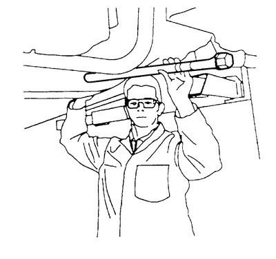

    Click to Enlarge
    Turn the adjustment bolt (2) clockwise to increase the Z height and counterclockwise to decrease the Z height.
