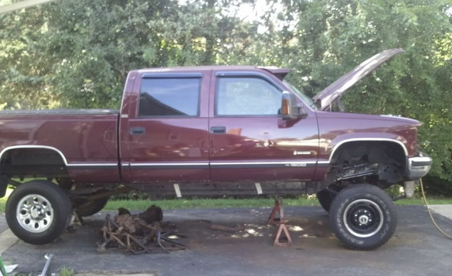

I hate to tell you this but I think you’re SOL. I just did some searching for you and that stamped steel lower arm is not available anywhere I looked. Seems like most guys are buying them at salvage yards and refurbishing them.
If yours isn’t bent or rusted out, your only option would be replacing the bushings and ball joint and keep running it. Had I known this I wood have saved mine when I pulled them off my truck when I did the solid axle swap.
They were right there in that pile of parts. Sorry.
