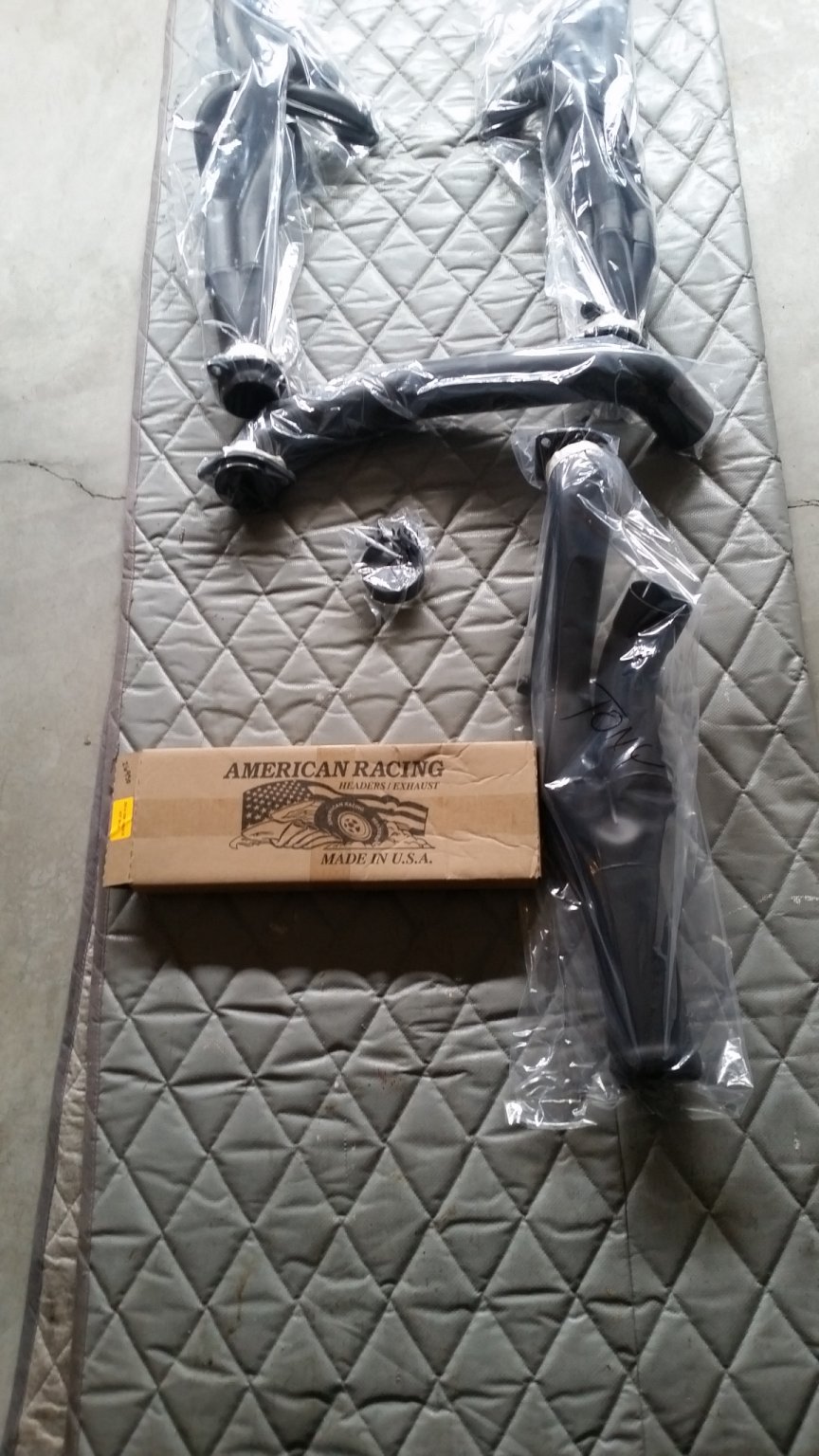

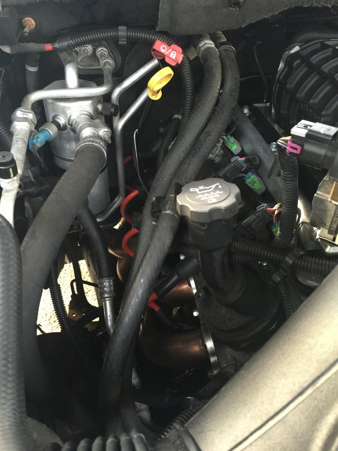

Next time ceramic coat them.. unDer hood Temps cut down and Trans fluid stays,cooler thats,what I also saw on my tbss.
I did 1 7/8 for my escalade non catted and coated. I use gm gaskets cause these other ones blow out.
I can't wait to get these in and redyno. If I get 25rwhp and 10 tq I'll be happy. Just want 550/550
I was going to go oem but way to expensive. I have the old ones but between 5 & 7 the inner gasket is split between the 2 center bolts
I stil can cost them. But I read that coating or wrapping can cause long term effects. Hold moisture and can lead to premature cracking or rusting. Also voids warranty. It was quoted from Nick from American Racing.
Great increase man!!! Beautiful curve on the graph. Let us know how she feels on the street.

I've been a arh dealer for 10 years. To date never had any stainless coated crack. Underhand Temps cut and Trans stay cool. Uncoated cooks the fluid just be careful

I ordered some heat insulation to go around those tranny lines. They sit right next to the header. Aftermarket trans cooler is on the build lis roo

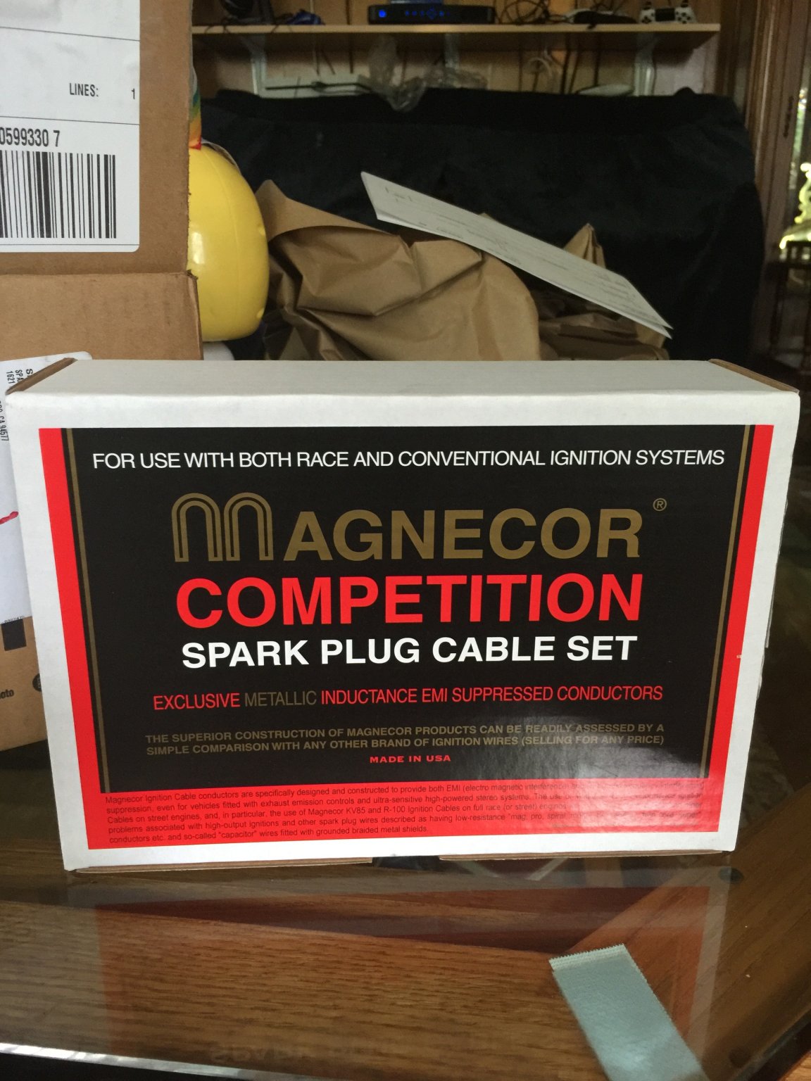

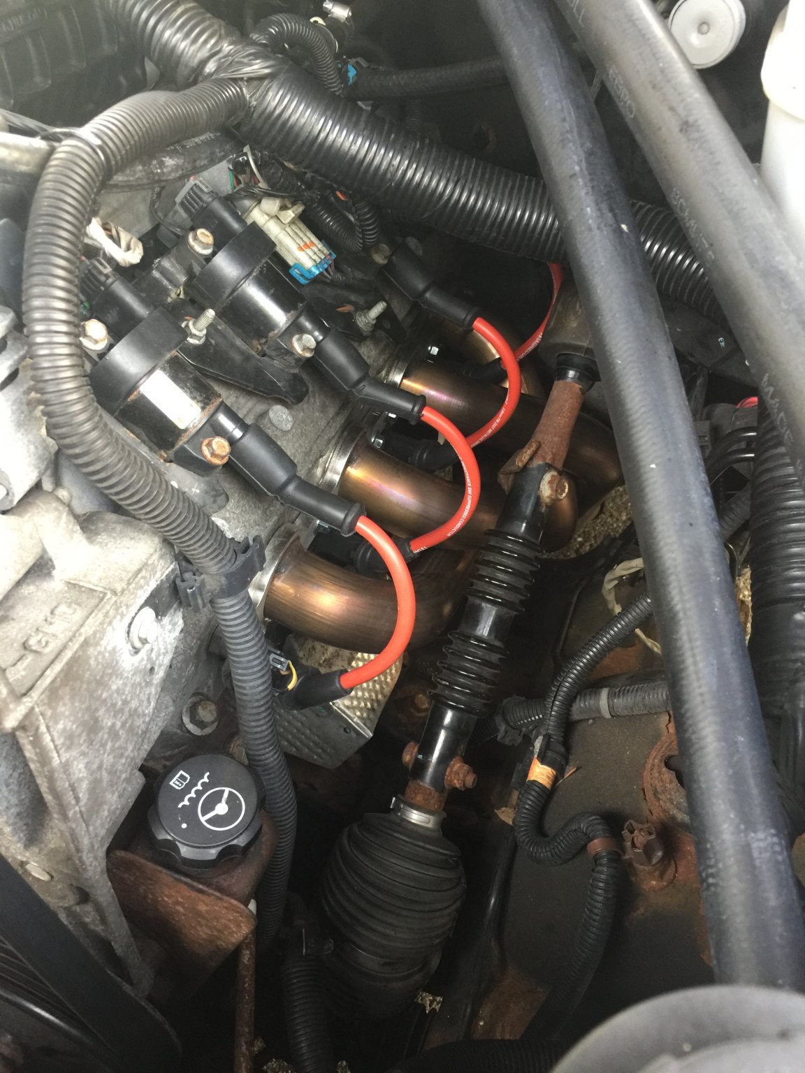

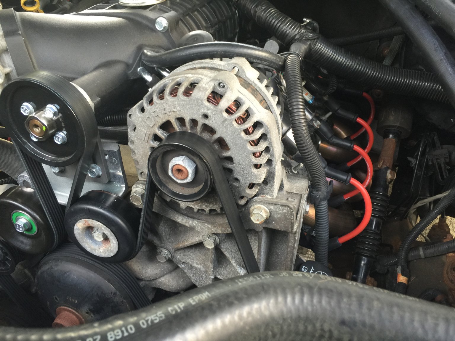

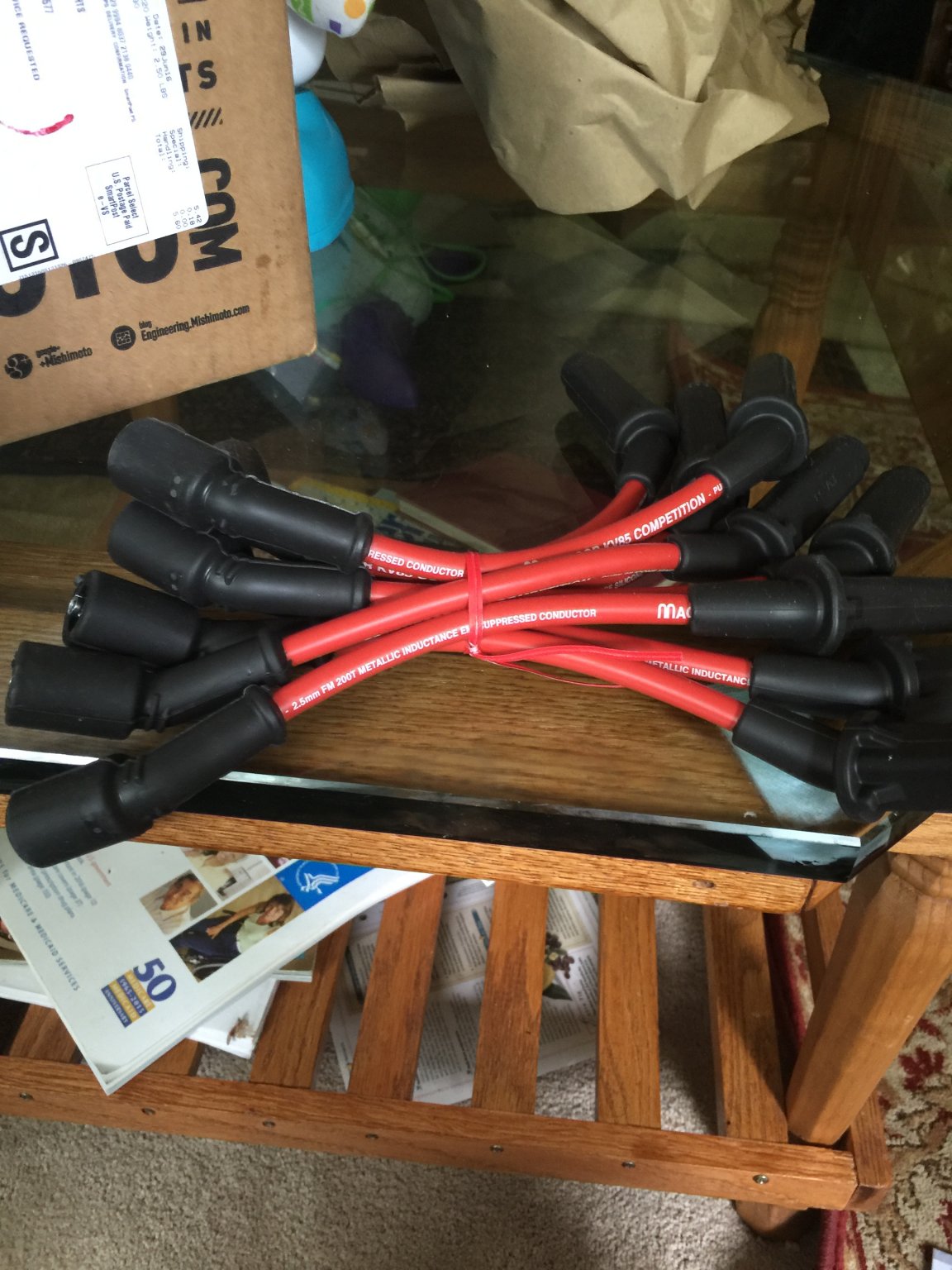

Magnacor wires installed. They are longer than stock so I plan on purchasing heat protection sleeves
50,967
19,478
:lol: but it's "patina" :crazy:
M3kanic
Jan 28, 2015
488
289
Davis Unified Ignition (Livewire) Come with heat shields on them and don't look as long as those.

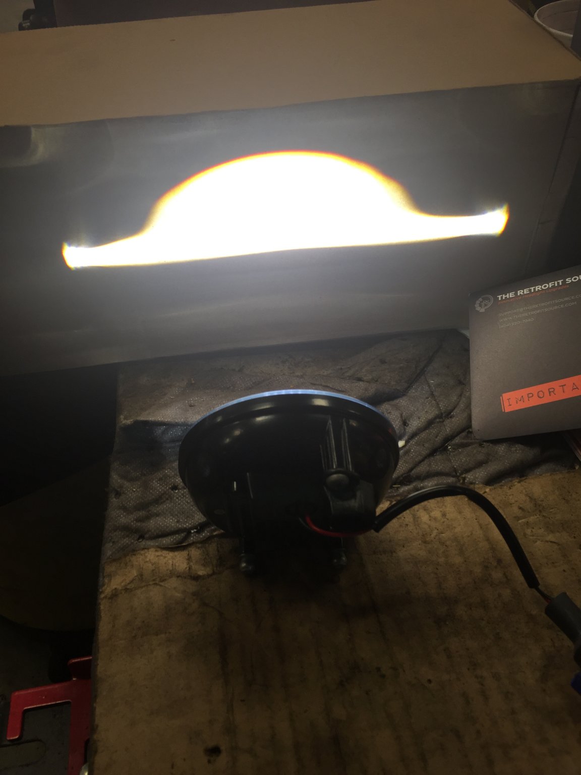

Morimoto fogs came in. Really nice. Took a couple pics in the shop. The light pattern is wide. Hopefully I can install this weeken of rain holds off
93blkongreenpro
Feb 9, 2016
1,388
1,358
Love the truck and the sc.
I love my Morimoto led fogs. Only takes about 20 mins to install. Took me a while to get them aimed. Makes a night and day difference.
