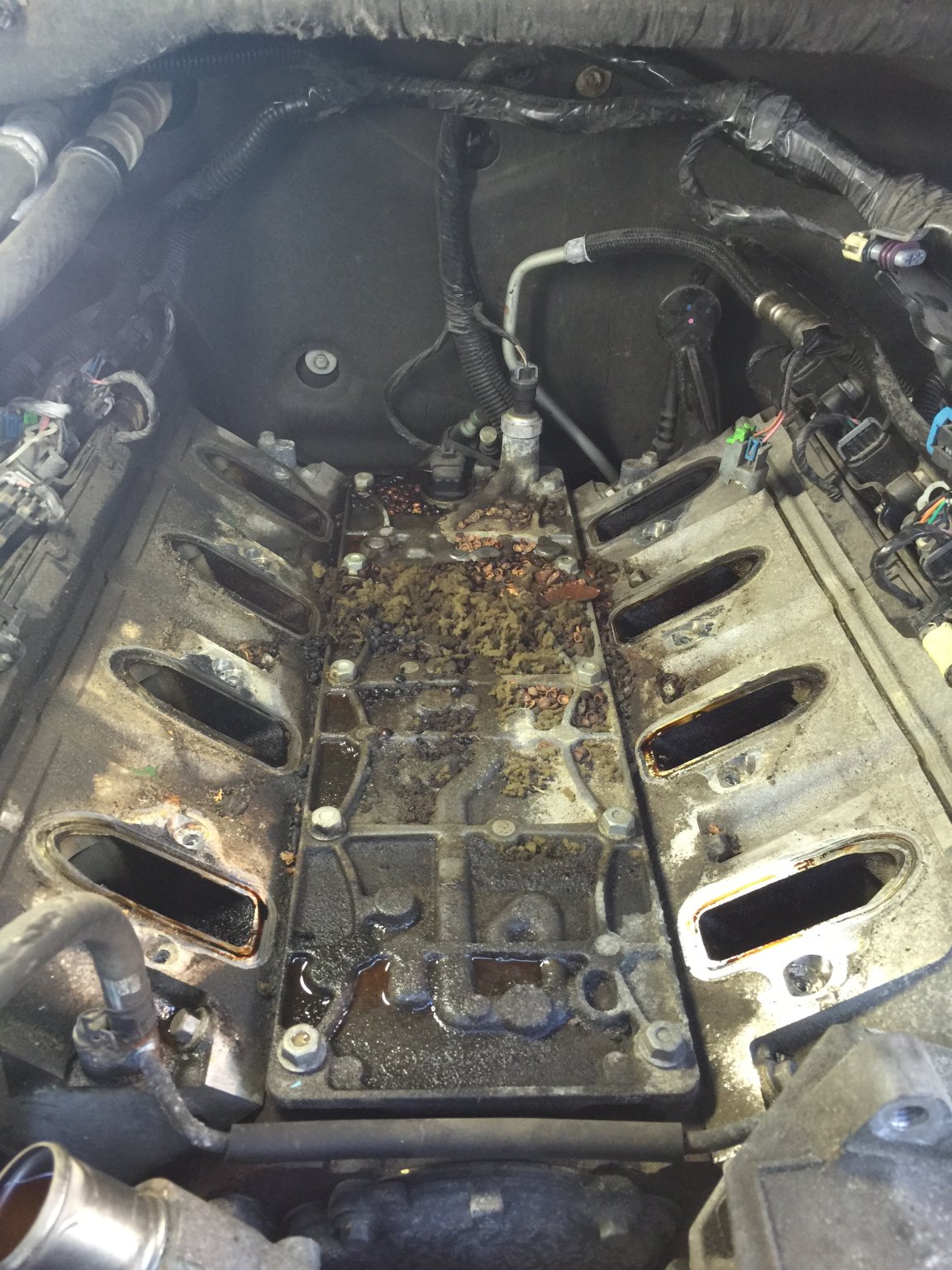

Ack. Unwanted neighbors. I saw debris fall in to some of the ports. Hopefully this method works. It shouldn't be bad. It's not like a bolt or nut so it won't mess up the valves and get burnt right up

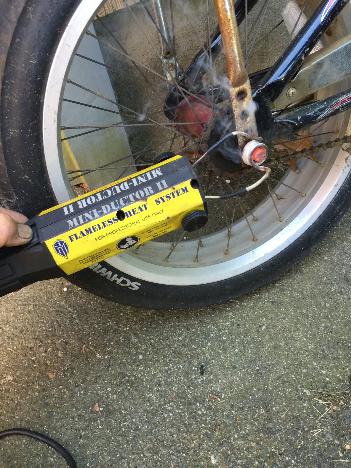

Another tool highly recommended is a mini inductor tool. Coil goes around nut or bolt your trying to remove. It super heats what ever the coil surrounds and gets it cherry red. Awesome for areas that you can't get a torch into.

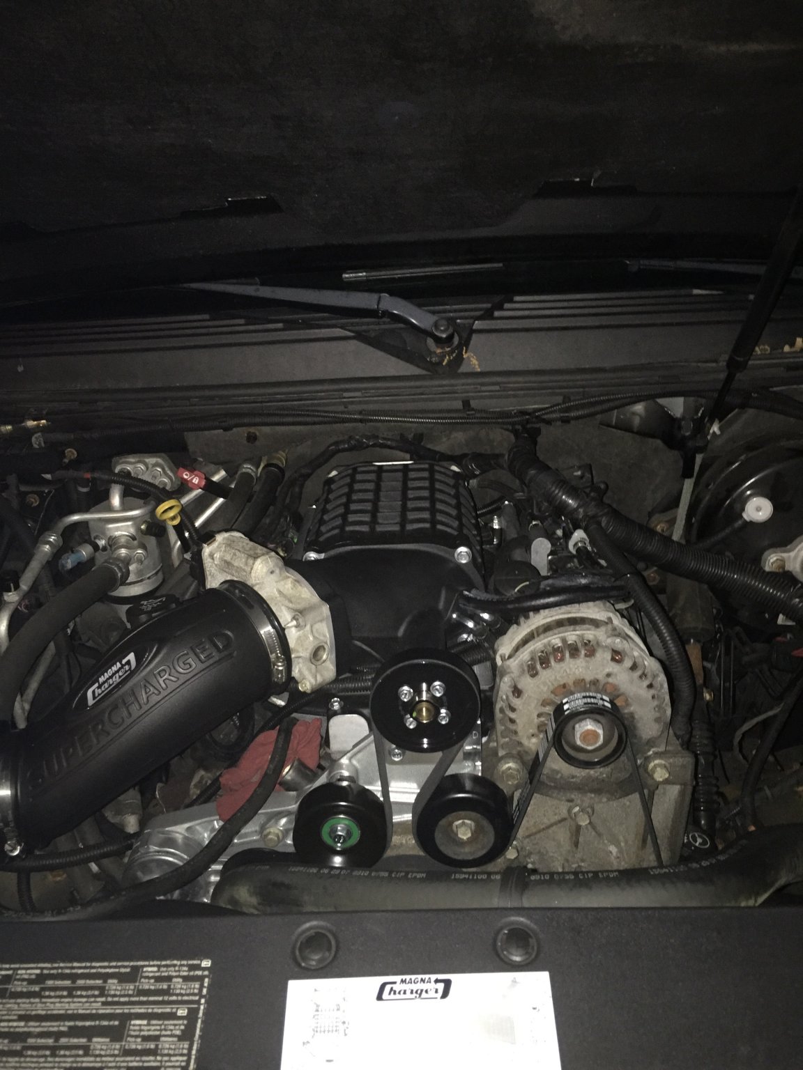

Finished up mounting the Maggie. Now for the heat exhanger. Only have a few hours a night to tinker. Tomorrow my ARH headers come in

is that a volant CAI? did it line up ok w/ maggie intake?
what about MAF sensor, since maggie tube has no provision for it

It's tight but it still works. I had to slide the bellow up the tube a bit. I'm Going to try a few different setups. Trimming will be the last option
