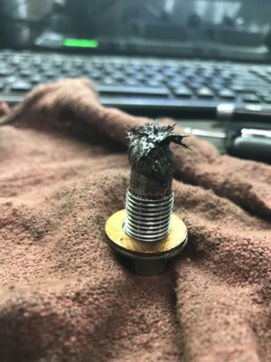

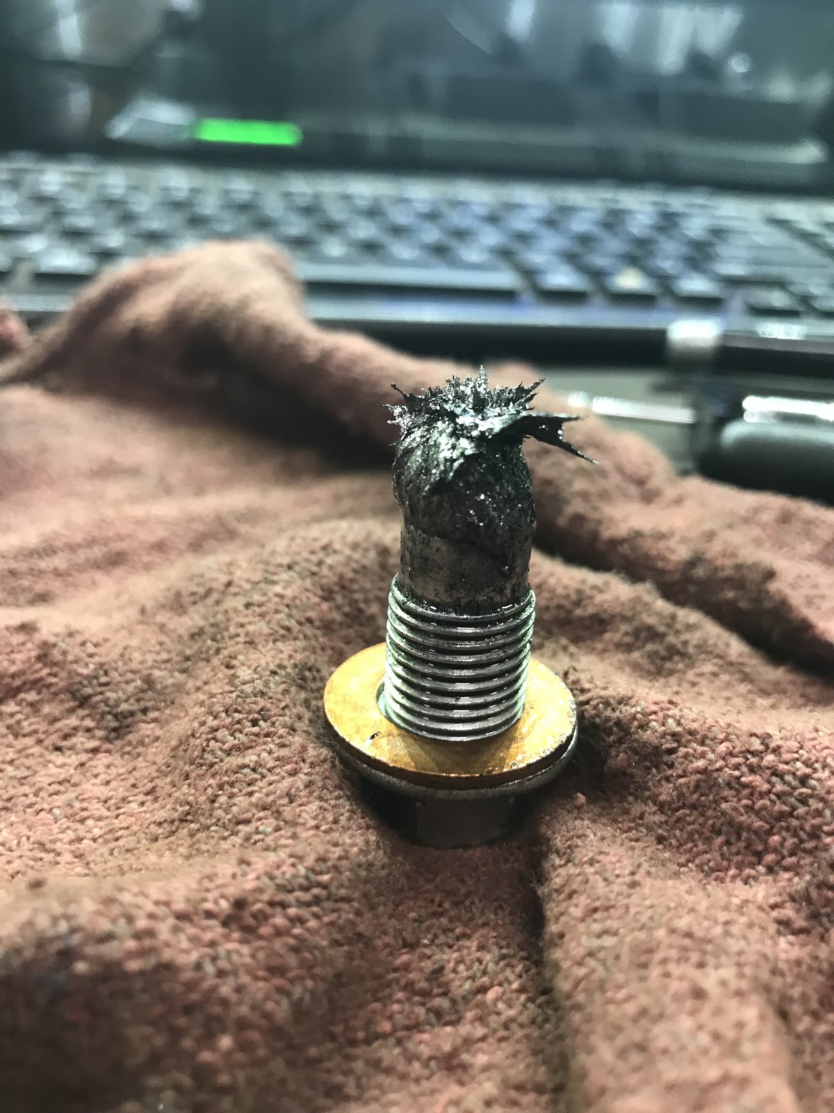

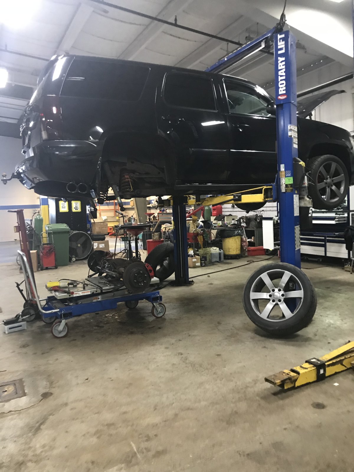

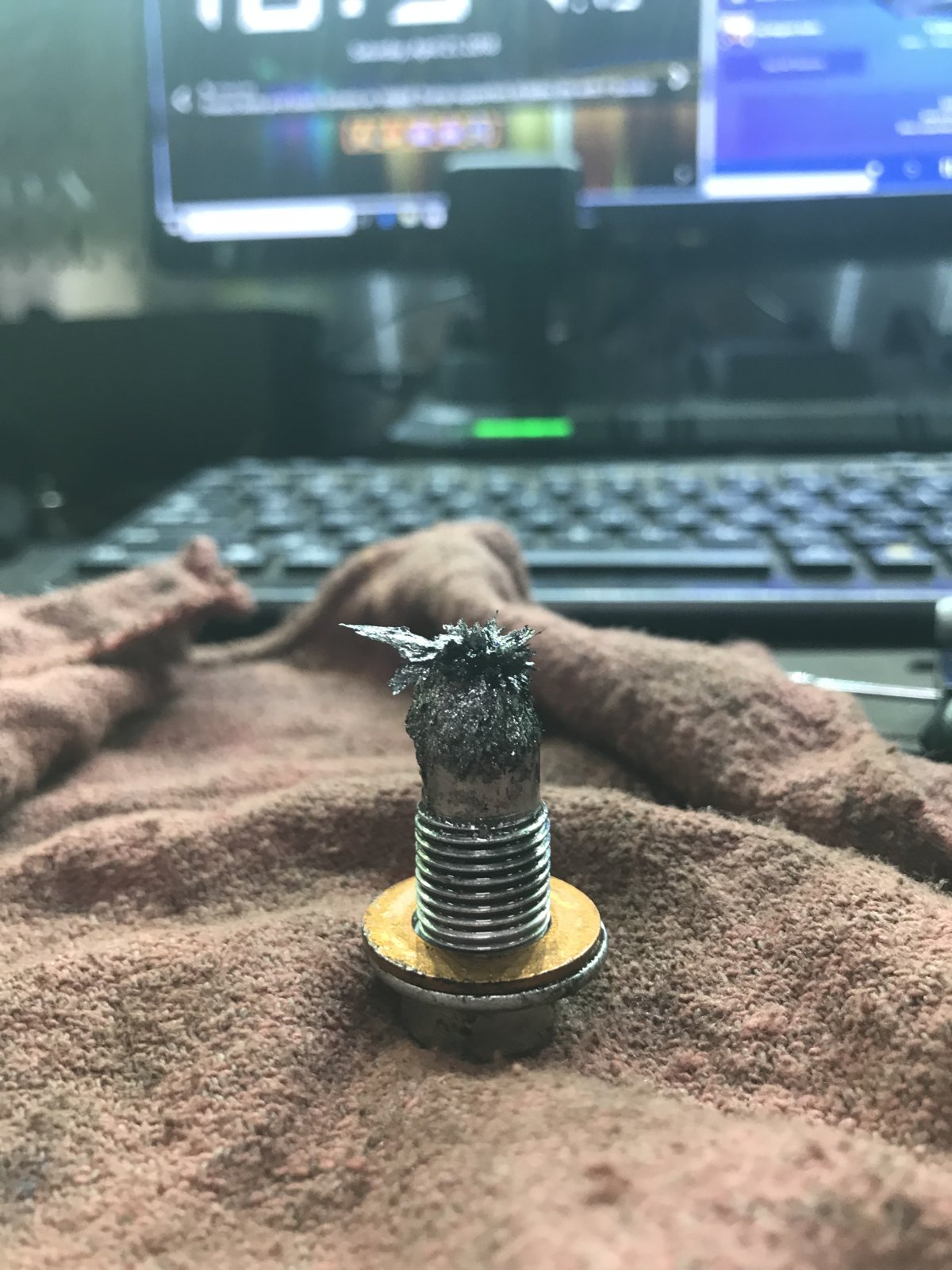

Been awhile. Had a bad pinion bearing that was really bad. Was hoping it was a u joint but no luck. Replaced with greaseable moog joints and did a fresh rear diff service. Nope. Definitely from the rear end. I was gonna build it up but I found a complete same rear end and got it off a Tahoe with 60k on it for $675. Swapped rear ends out at the shop on my own time. Now hooks up no problems. Next will be my performance trans to install.
This was my drain plug with less than 100 miles on it. The royal purple fluid I used was purple with silver glitter flakes in it.
