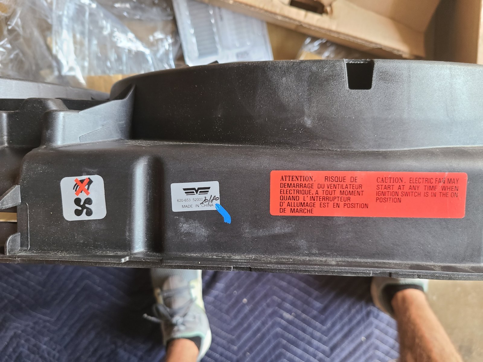

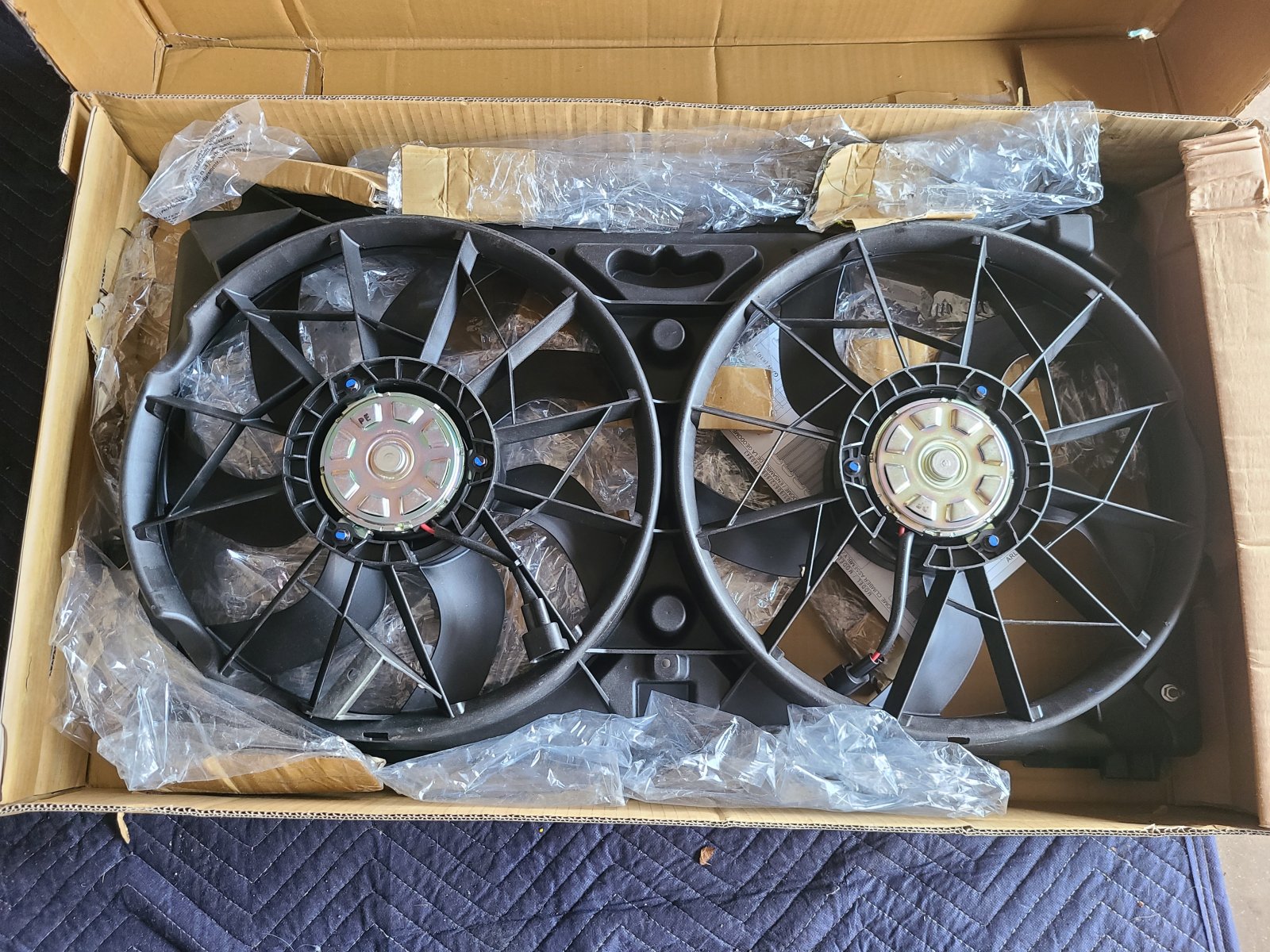

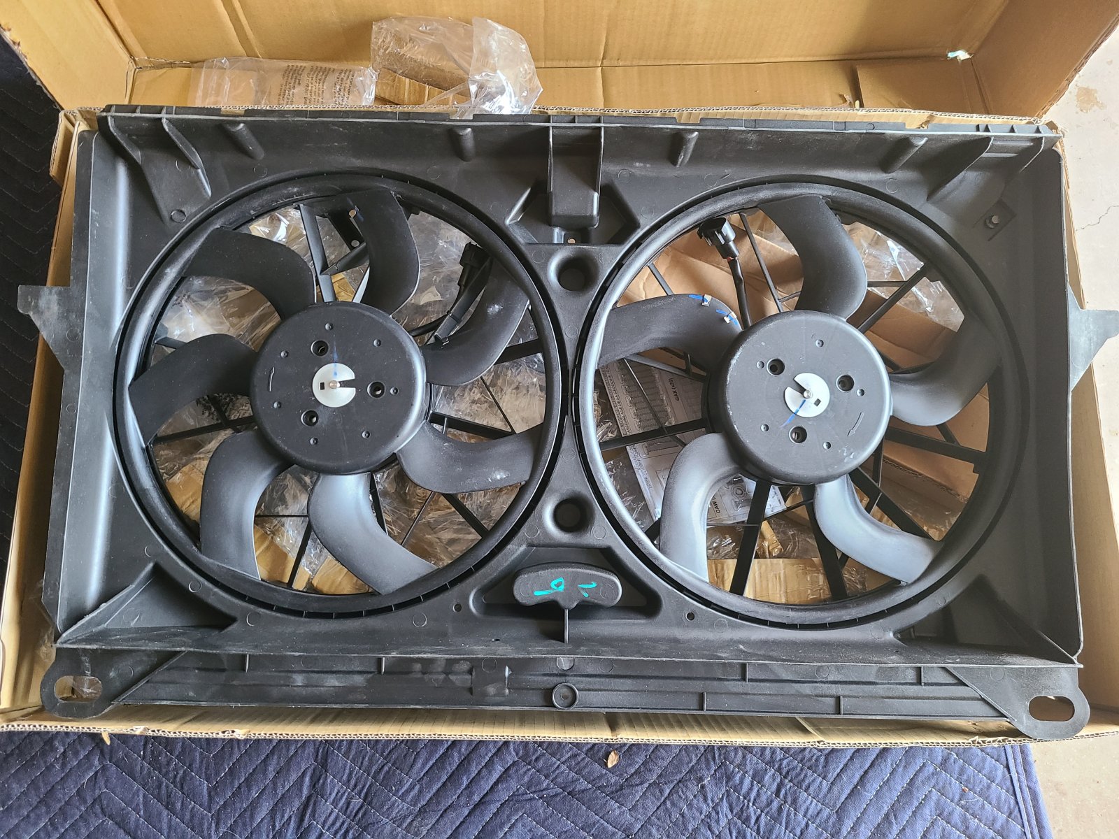

Ok so I saw this super cheap brand new electric fan for my 2004 Tahoe on Amazon WITH free shipping for 35 bucks totall.....I figured it was worth the gamble. It just came in. I don't see any part numbers, brand or anything. Would y'all mind looking at the pics to confirm if this fan will fit???

You will either have to measure the width and height of your radiator to guess that.My questions would be were are the relays and wiring for that price no way they were included.ALso how does it mount to the radiator i see holes on the bottom.Does it give you the cfm of the fans.What about posting the link from amazon that you bought it from.

Dorman brand. They look very close, 5 blade and 7 blade fans. The second pic is upside-down and the top mounting holes are shown. The ears on the sides of the fan slide down into hooks on the side of the radiator. Missing the bottom and top rubber bumpers/mounts but those may be on your current fan shroud.

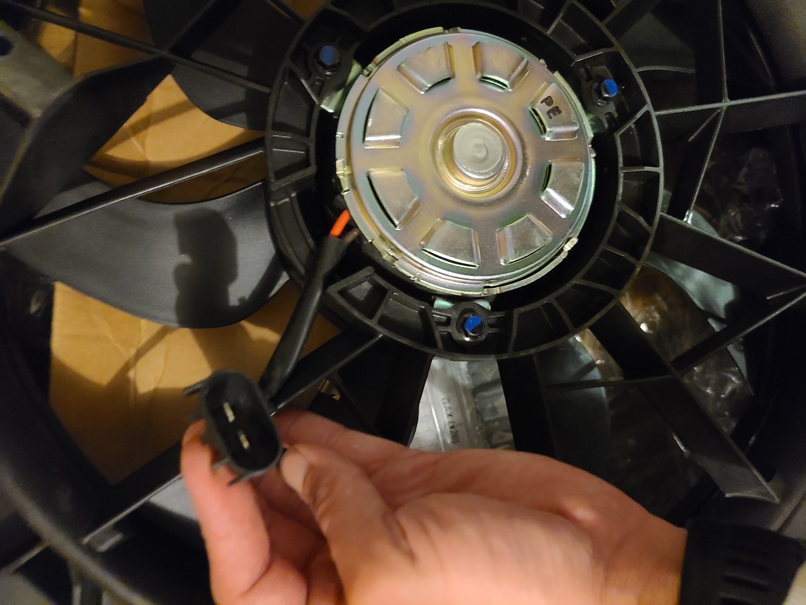

Still dont no if your installing a new harness or have relays for it.Hope your not gong to run a switch with wires directly to it.If so bring some heavy duty cable cutters and a fire extinguisher.:flamingdevil:

those holes are actually the top and you would normally swap the rubber bushings from your old fan shroud to this one, that is a fan & shroud only Dorman does not sell a "kit" to convert to electric. it will physically fit 00-14 1500 suv's and pickups, avalanche, etc

620-653 is a factory replacement for a 34" rad it looks like. Nice find. You can definitely make that work

if you cant find him, theres a few companies that sell a conversion harness pcm of nc, nelson performance, racetronix
most just have power and ground connection and then trigger wire from ecu or temp sensor

ya there is a mixture of blade counts 5&5 5&7 7&9, rimmed, non-rimmed, 500w, 700w, shroud outer diameter is the same and the connectors are the same, on the 7&9 blade the shroud is thicker (still fits)
after 2014 they went to a direct drive motor so the design is different
radiators fit 2000-2014, on the earlier models some had a slightly smaller width radiator but you can fit a 34" in all of them (there are holes in the support you just move the rubber bushings to the outer holes) then you would just have to find the 34" shroud and it's plug-n-play

Hey thanks that's perfect! The Nelson harness looks great, they have the two trigger wires already pinned which is great. Looks like racetronix only have a universal harness.
