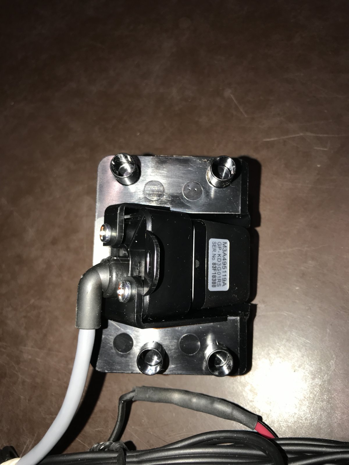

2013 suburban, adding an OEM rear view camera.
after removing the piece that the camera mounts to, I’m not quite sure how the camera is supposed to be attached, I will obviously need to cut out enough to fit the camera in there. What I’m not sure of is how the camera attaches to the plastic. There are no threaded holes/ clips in/ on the camera housing

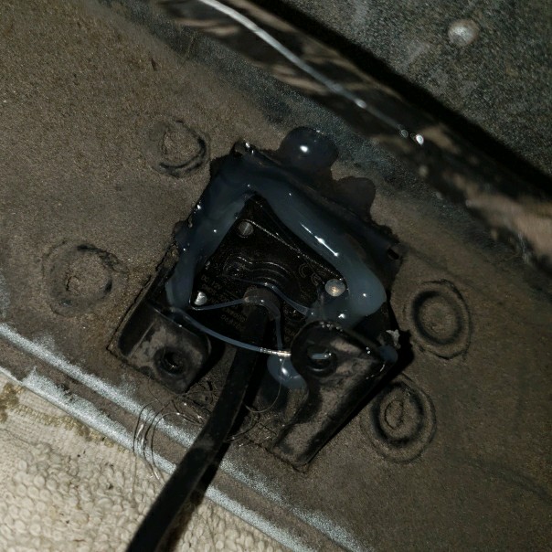

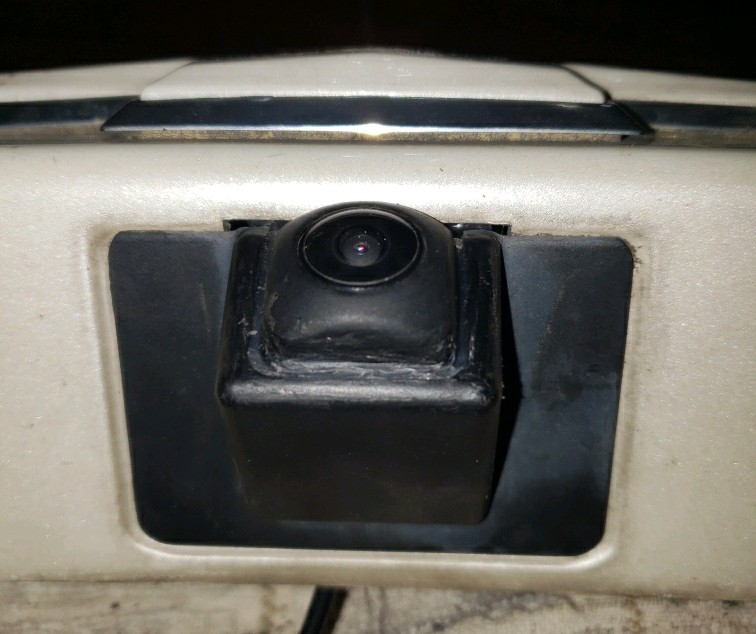

You have to cut out the hole for the camera and then drill 4 holes to align with the 4 posts you see on your bracket.
Once those posts are through the holes you drilled they get melted and pushed down/spread out... kind of like a rivet but it is actually plastic welding.
This is a pic from when I swapped my factory camera for my Kenwood camera...
Sorry, not the best pic but you can see what I'm talking about at least.
Finished pic.
