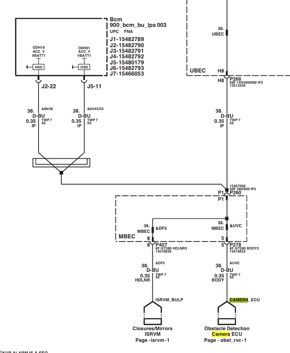

Hello has anyone ever made there rear view camera stay on while driving. Or anyone have the schematic to show which wire is the trigger wire. Any help appreciated.

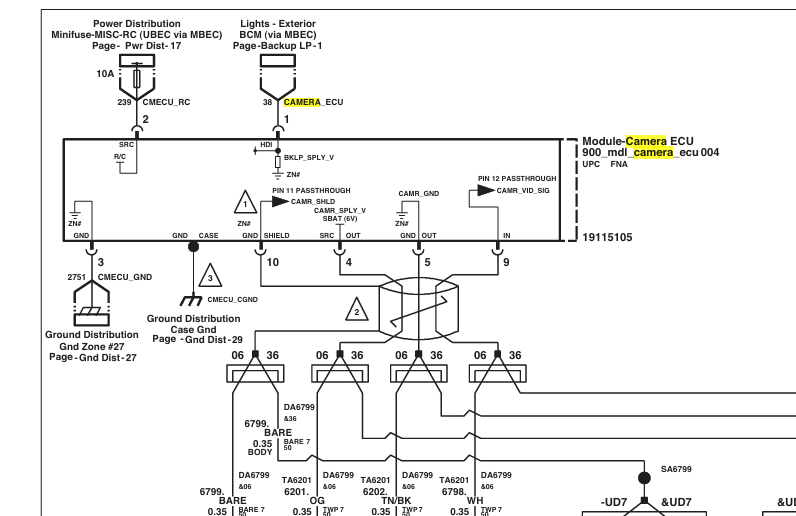

Looks like you need power to pin 1 on the camera ECU.. usually triggered by the BCM..

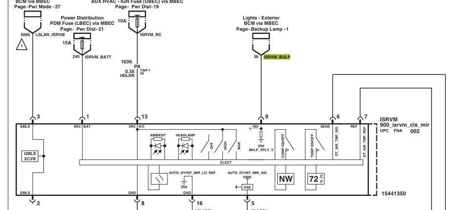

Also powers the rearview mirror screen..
Let us know if it works!
Just noticed it also ties into the reverse lights, (second diagram, circuit #38 to the UBEC)
..need a diode on that circuit if you don't want the backup lights to stay on...
