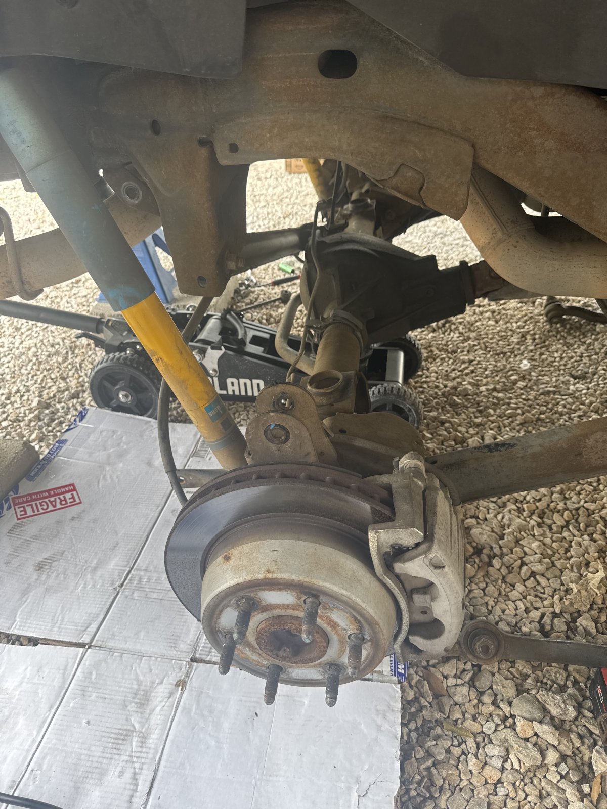

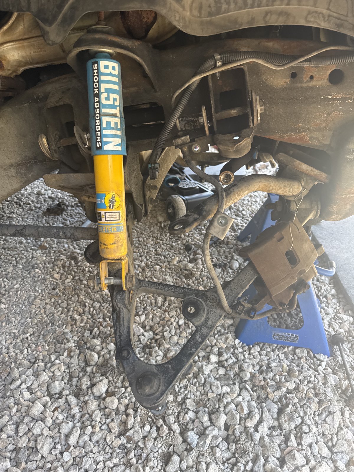

Hey guys I am documenting the install of my Beltech 2-3/4 inch drop kit. Im also putting all new front end parts, minus the Billsteins since they are just a few years old. ill be posting the official specs on the drop stickie when im done but for now day 1 progress. btw if you work on gravel like I do, get the badlands jack from Harbor freight.

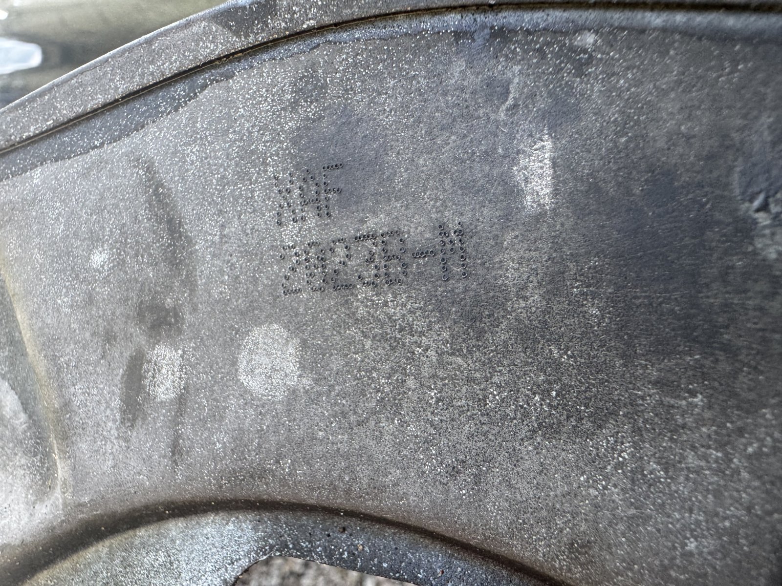

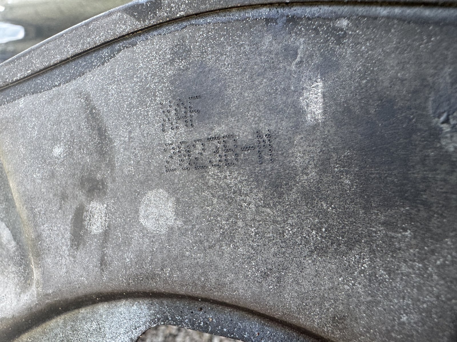

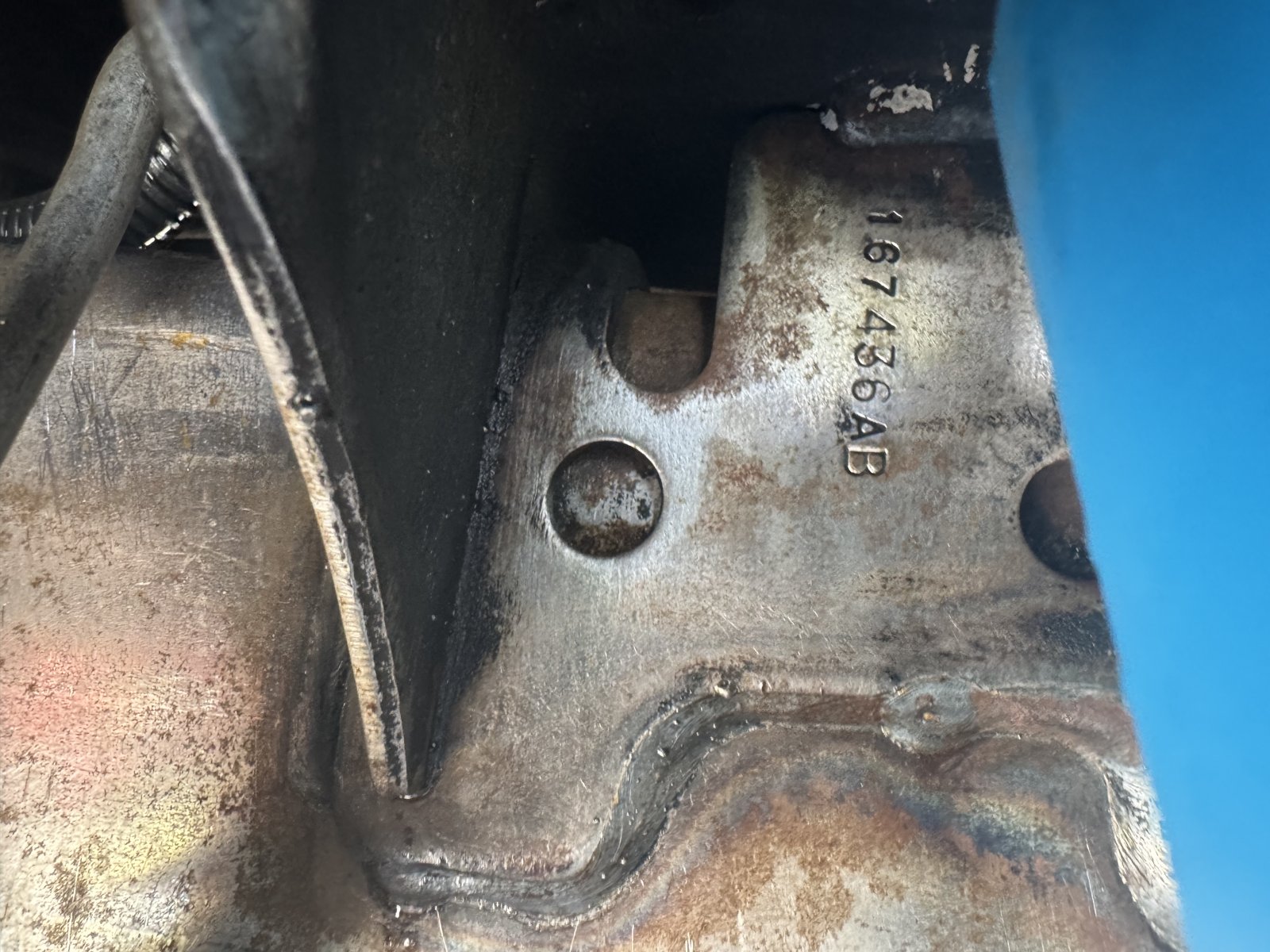

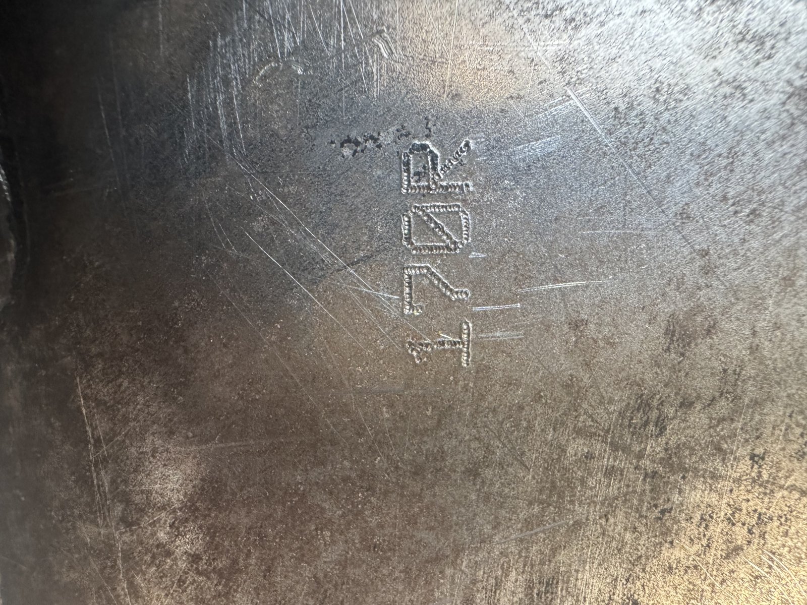

Found these part number while peeling the grease, rust and paint from the front end frame. Interesting at least.

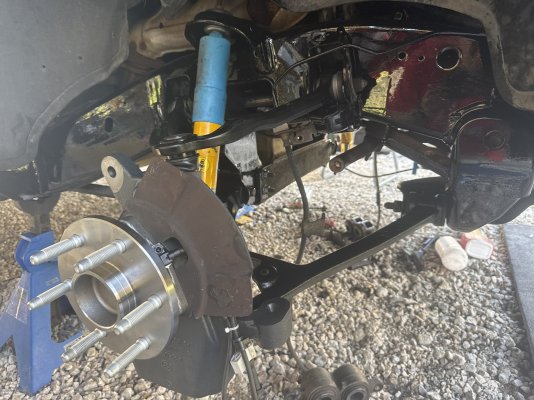

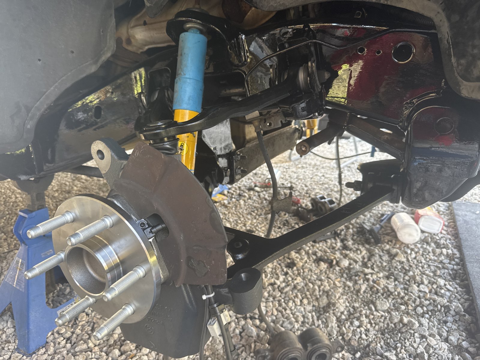

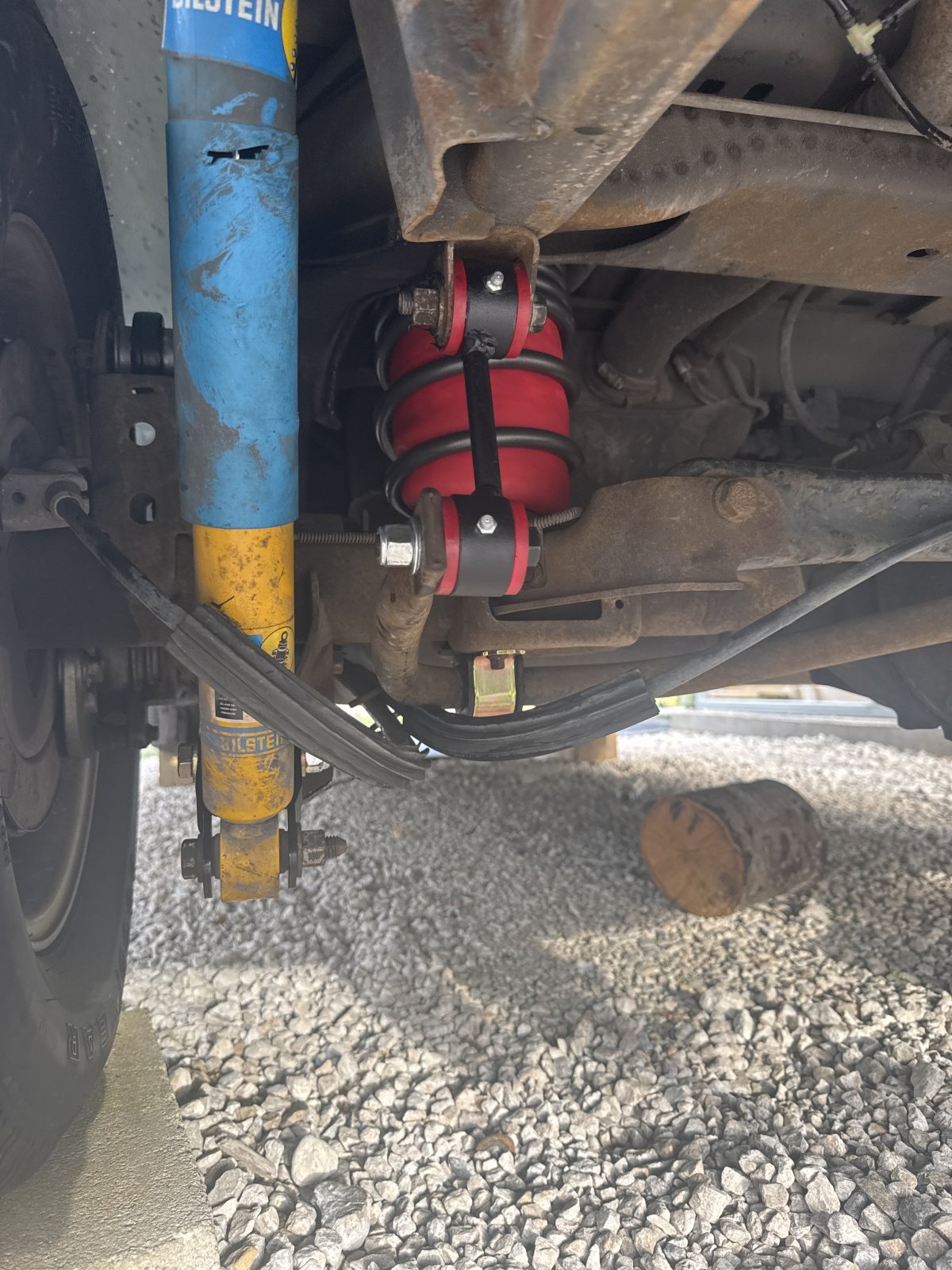

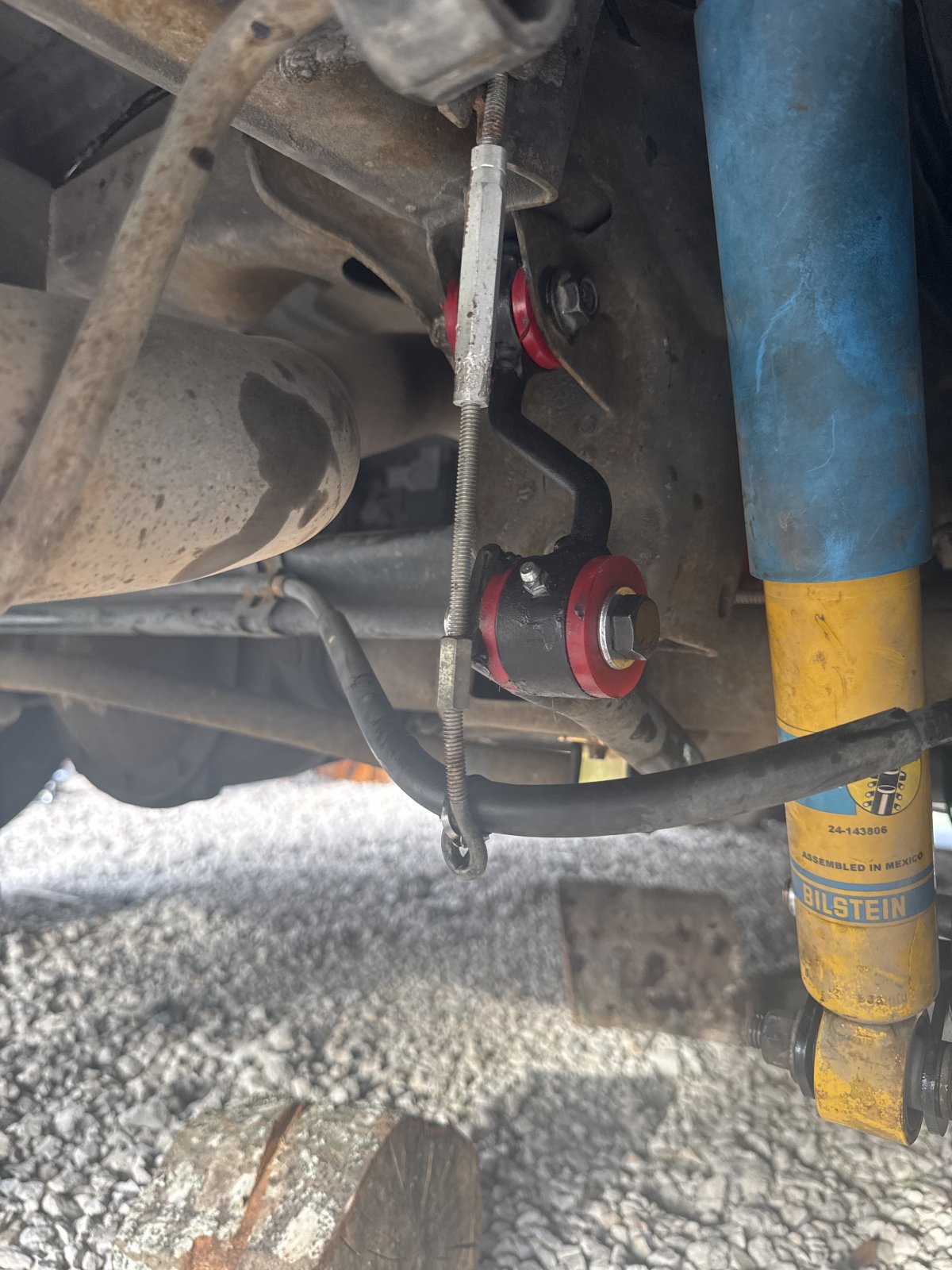

Finished with the install of the rear suspension parts, including lowering springs from belt, tech and relocation tab for shocks. I used DMJ end links. However, unlike other posts I’ve seen I did not have any issues with installing these end links. Seems too good to be true, especially since I haven’t driven the truck yet.
