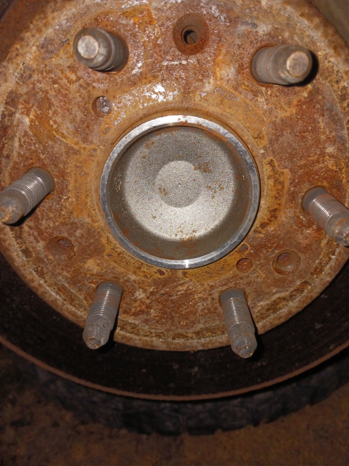

Ok so my sisters trying to change her wheel bearing out this week and she’s sent me a pic saying she can’t get this capt off to get access to the cv axle nut
To me this looks like a 2wd hub I’ve never seen a cap on my cv axles on either my truck or Tahoe is she just high or is there a cap there I’m not seeing? Lol if so how is a good way to get it off

no cap, you dont replace just the bearing. im not sure replacement bearing for the hubs are even readily available
you replace the entire hub by removing the 3 bolts on the inside of the knuckle

I knew I should’ve went and helped her I thought her Tahoe was a 4wd though and I guess she’s ditsy enough to fight a 2wd wheel bearing for hours before realizing there’s no cv axle behind it lmao! Of course she won’t ever answer the phone when I call and try to explain or help her through it

Yep, 2wd. No axle back there. Maybe she did look at you tube but only looked at a 4wd Tahoe video. C'mon man!!!!!!!!!!!!!!!!!!!!!!!!!!!!!!!!!!1

I sent her one for a 4wd Silverado I swore hers was 4 wheel drive and even though it wasn’t I figured she had enough common sense to know there’s no nut to take off of the cv axle if you don’t have any cv axles! So it was partly my fault lol what’s funniest is she beat on it for days thinking there was a cap on there when she finally sent the pic and said she couldn’t get it off I was like wowwww that looks like a 2wd you were beating the hell out of your truck for two days for nothing lmao
