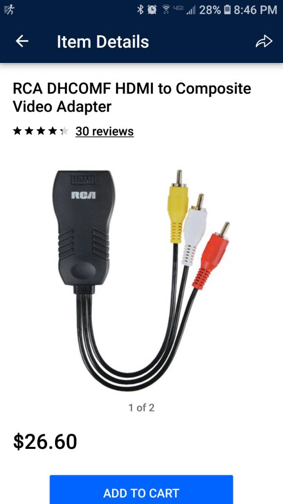

yup I do. I will try the adaptor this week.
I have this HDMI to Composite adapter I bought at Walmart.com that my kids use on trips to play their Xbox1 games and movies on the rear entertainment screens/headphones

I picked up an adaptor and it worked! BUT! I can only use it on the rear TV. Is there a way to make it work in the front? And is there a way to watch it while vehicle is in motion.
You should be able to select the A/V input on the front head unit and see the video while in park, but when in Drive that stuff is disabled for the front screen unless you get something that disables that function like that Video In Motion device
