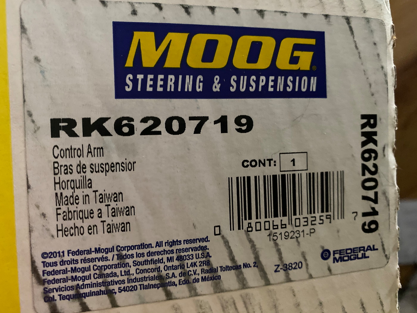

I'm starting on the front suspension replacement, because it wonders a bit. The Yukon has 130k miles on OEM parts. I'm going with all Moog balljoints/parts.

The first upper A-arm, the right, arrived today, the rest are due Wednesday. That will be the left upper A-arm and the idler and pitman arms.
